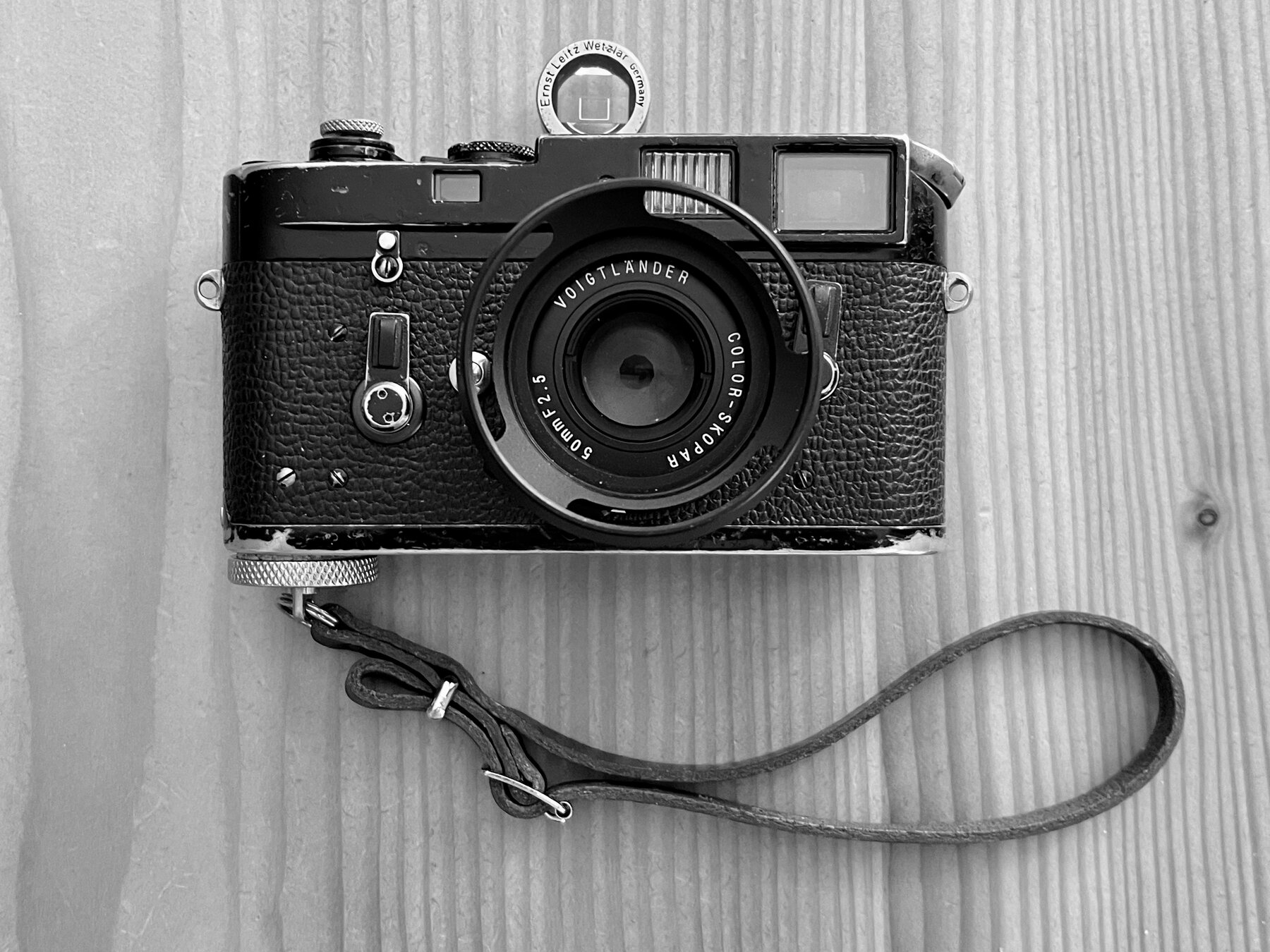

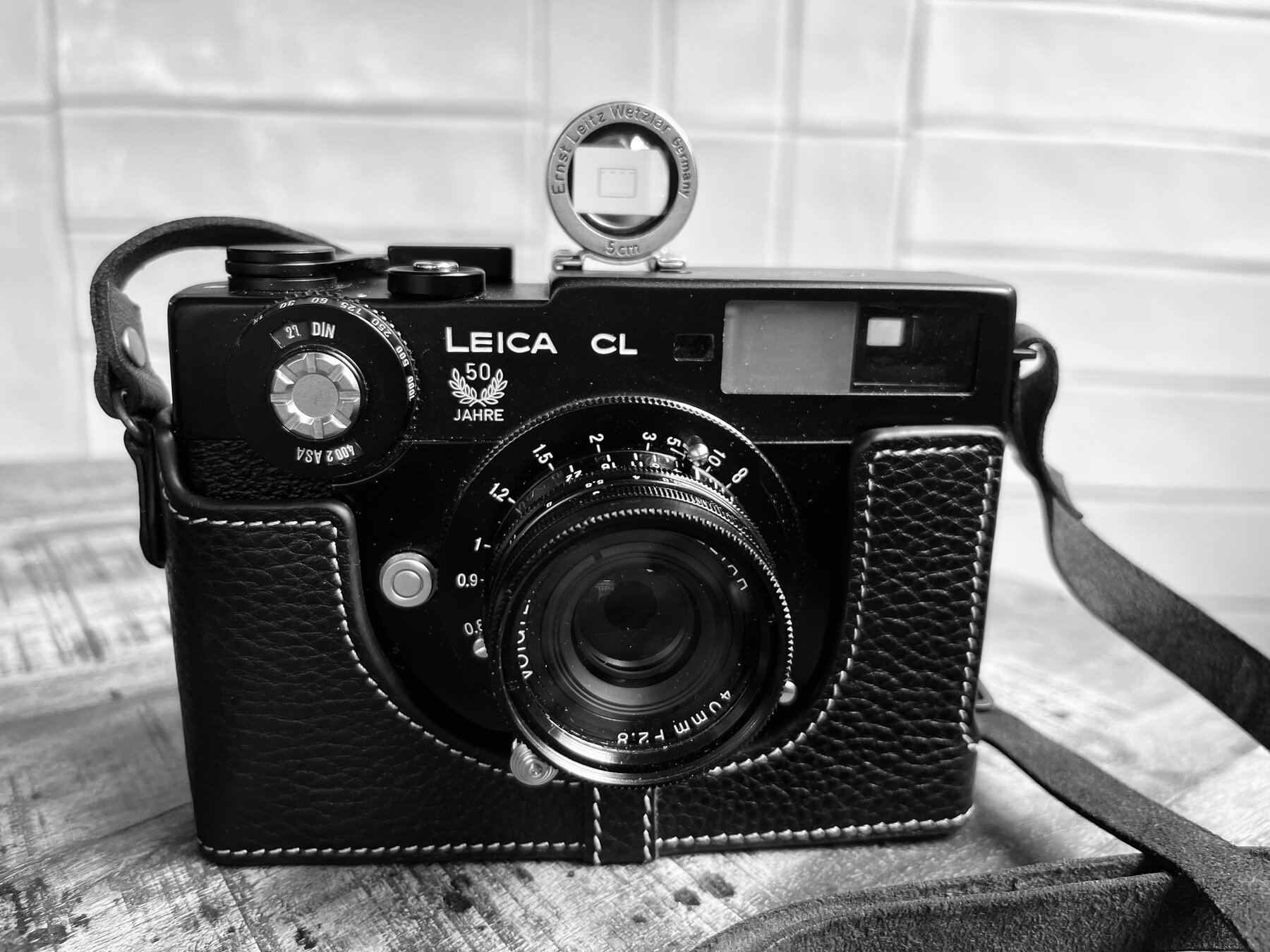

I'm a big fan of the uncluttered view of the accessory viewfinders. I use mine on my CL, M & IIIg (now that the iiif is gone)
