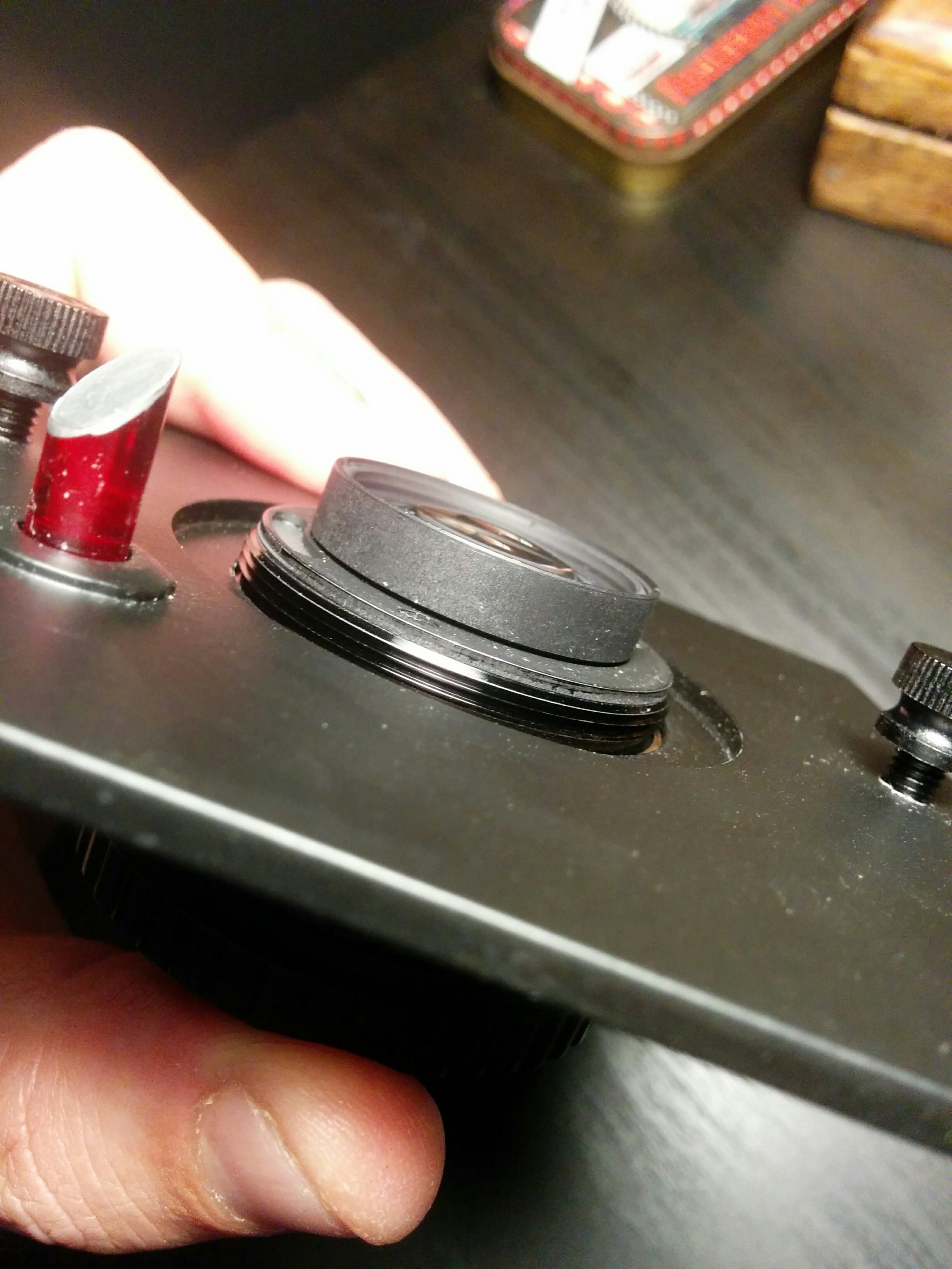

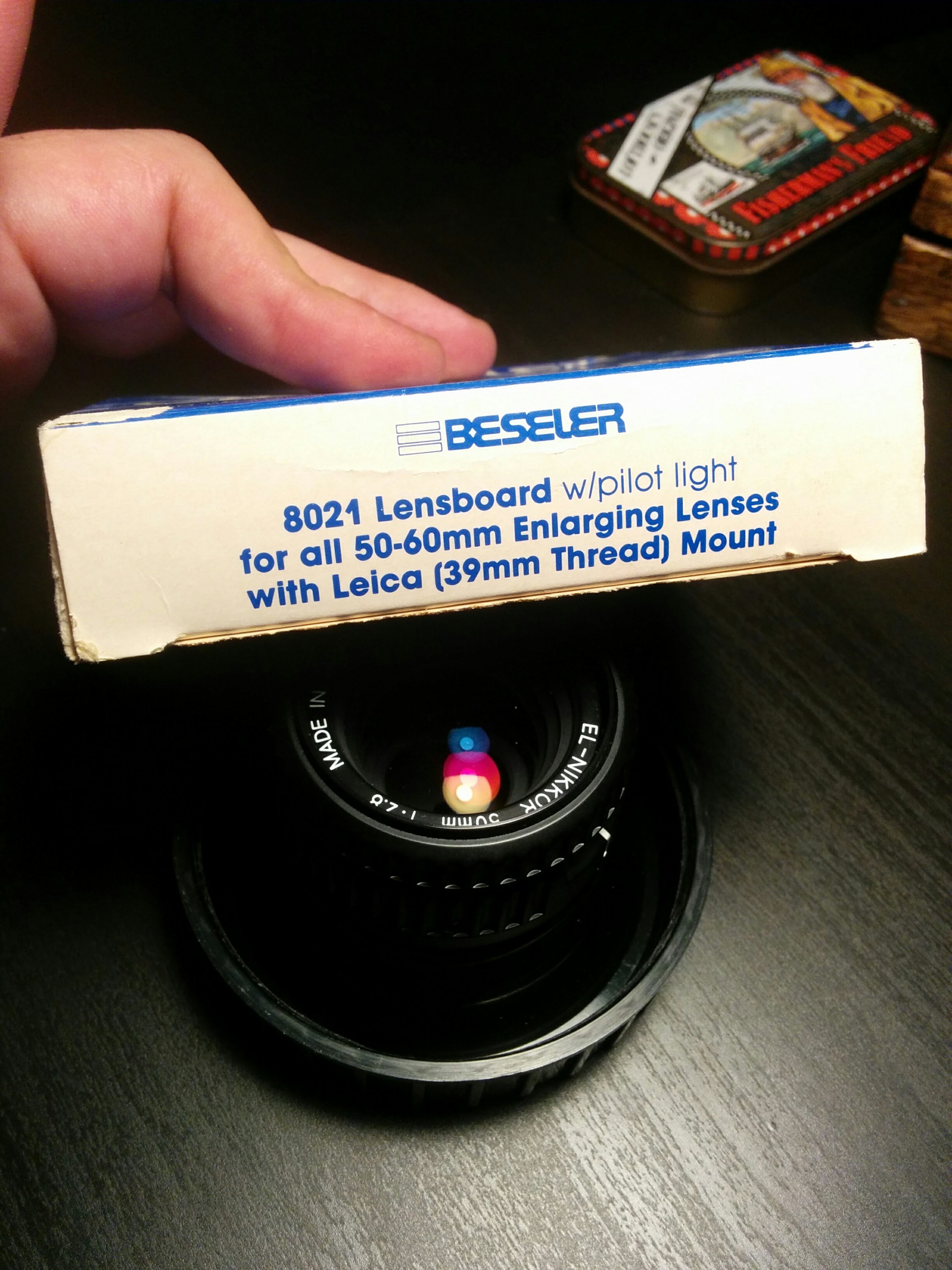

Well the lens arrived but it doesn't fit the lensboard...
I need some help, here are two pictures I took.
You can see the label on the lensboard box and the back of the lens passing through the mount without even touching. Maybe the box had another lensboard inside or a different board is needed?
I googled the issue but it made me even more confused with many opinions but no solid answer.
Konstantinos
Oct 3, 2016
7
Cyprus
Apparently I am missing a lock ring. I didn't know that Beseler boards are not threaded.
Yes i'm sticking it in backwards in the picture... :redface:
Ian C
Feb 8, 2009
1,260
That is one of the correct lens mounts for the 50/2.8A EL Nikkor on the Beseler 45VXL. You have shown the lens mounted backwards through the clearance hole. Most Beseler lens mounts are not threaded. You must install a 39mm threaded retaining ring onto the threads at the back of the lens after passing the threaded end through the lens board.
