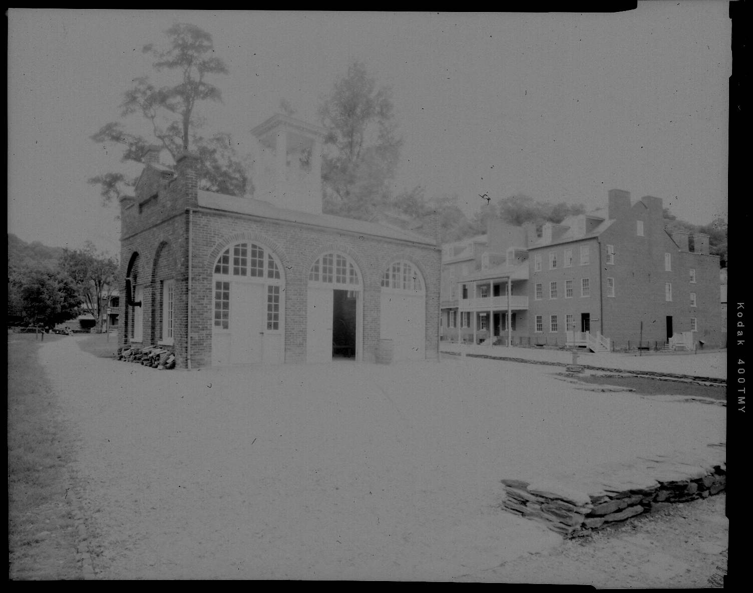

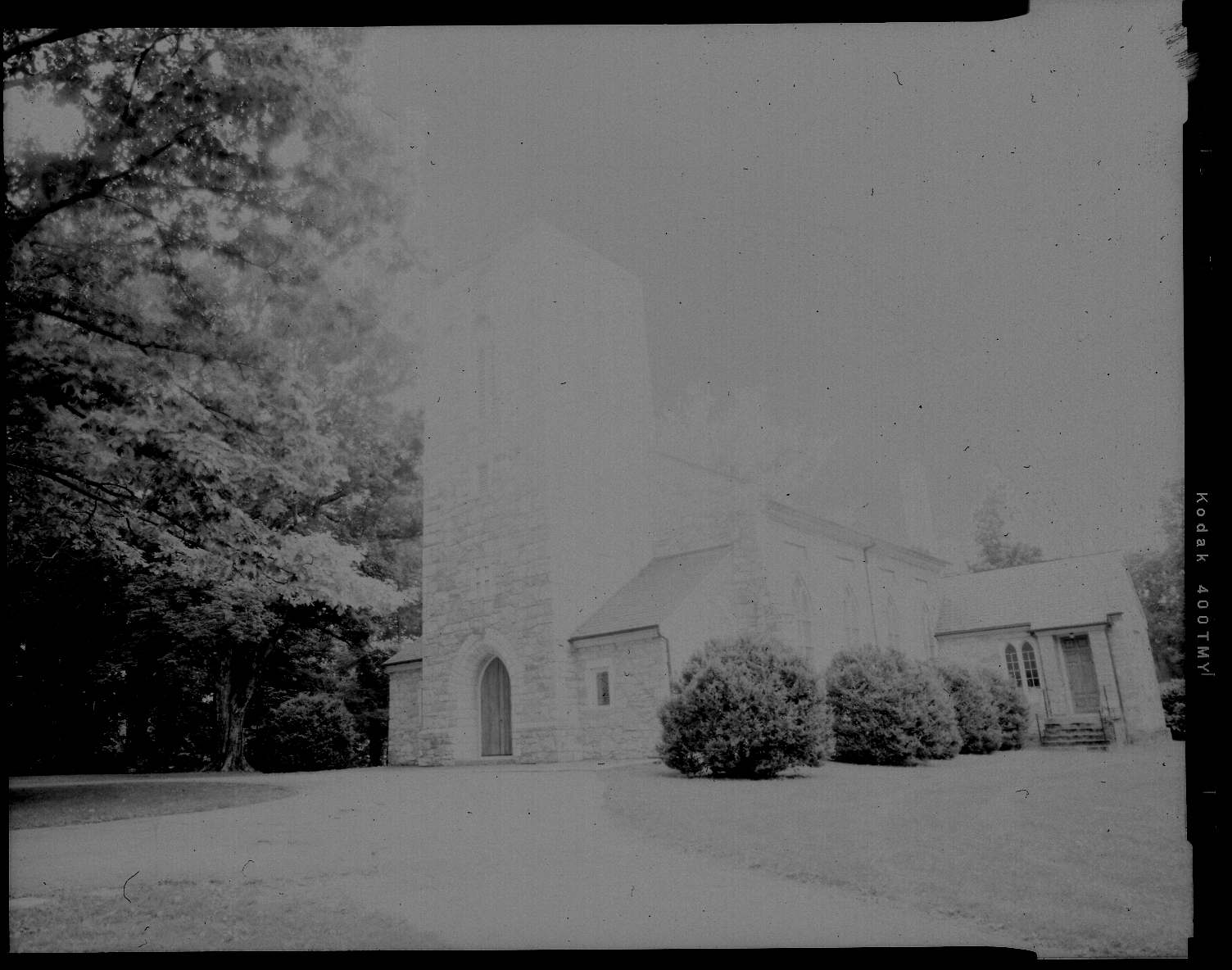

These are two photographs that I took learning to correct for convergence. The negatives were quickly flat scanned saved; then GIMP was used to reverse the images and adjust the contrast so that they would be viewable.
Both negatives were taken with a Schneider-Kreuznech Angulon f6.8 90mm lens. In both photographs I thought that I had corrected for convergence, but on the right of both of them there is convergence. The one of Haper's Ferry has slight convergence and the one of the church has a larger convergence.
Are the convergences an artifact of the lens or an Operator Assisted Failure [OAF]?

Neither really looks like lens distortion. Both really just look like you did not have the camera back perfectly vertical.
If you are sure that you did, there may be a mechanical issue with the camera or film holder itself - but these seem very unlikely.

The first image looks tilted to the right to my eyes, and the second tilted to the left. This possibly influenced the subsequent perspective "correction" work. Maybe the ground was soft and after levelling the camera there was a small movement which you did not notice.
You can clearly see that the camera is not levelled because an imaginary central vertical line, which is vertical in nature, and which is in the exact centre of your picture, must be vertical (all other lines will converge to a point "above the frame" if the camera is looking "upward", or below the frame if the camera is looking downward, but a central vertical line is always vertical, and if it isn't that means the camera is not properly levelled.
This is very hard to judge by eye as for the eye verticals are always vertical. I mean, if you brutally tilt a camera 20° to the right an look through its viewfinder, the horizon will be horizontal just the same :wink: but the resulting frame will obviously be tilted 20° to the left.
Small differences are very hard to judge. Bubble levels are decently precise, but not overly precise. One can easily make a mistake of 0.1 or even 0.2 degrees using bubble levels. I don't understand why don't they make them more precise. It probably has to do with tolerances in installing the bubble on the tripod head (or tolerances in perfect geometry of the cameras).

These shots don't need very complex movements, and the 90/6.8 Angulon doesn't produce this kind of distortion, so my guess is that you were probably trying to overcorrect, and that caused more problems than it solved. For shots like this, you should only need to aim the camera, level the camera on the tripod, and use some front rise/rear fall to frame, maybe shift if there are issues about where you are able to put the camera, or you want to look down an open corridor or something like that, and you shouldn't need any tilt or swing (except with both standards parallel if you need indirect rise/fall/shift, which you shouldn't with the modest image circle of a 90/6.8 Angulon on 4x5"). While a yaw-free camera is nice, these kinds of shots shouldn't put you in a situation that produces yaw (i.e., tilt and swing on the same standard).
Also, be careful with the 90/6.8 Angulon, because the circle of good definition is considerably smaller than the circle of illumination. See how you're going blurry in trees and the bell tower in the first shot? That's either more rise than the Angulon is good for, or unnecessary tilt or both.

I am using a Pacemaker Speed Graphic so there are no back adjustments. I leveled the camera left-to-right with a 6 inch spirit level but in first photograph I aimed the camera up to cut out the excessive foreground. In the second photograph the church was on a small rise. In both photographs I raised the lens but I forgot to check the edges.
These are the first two photographs that I took using the front rise.
