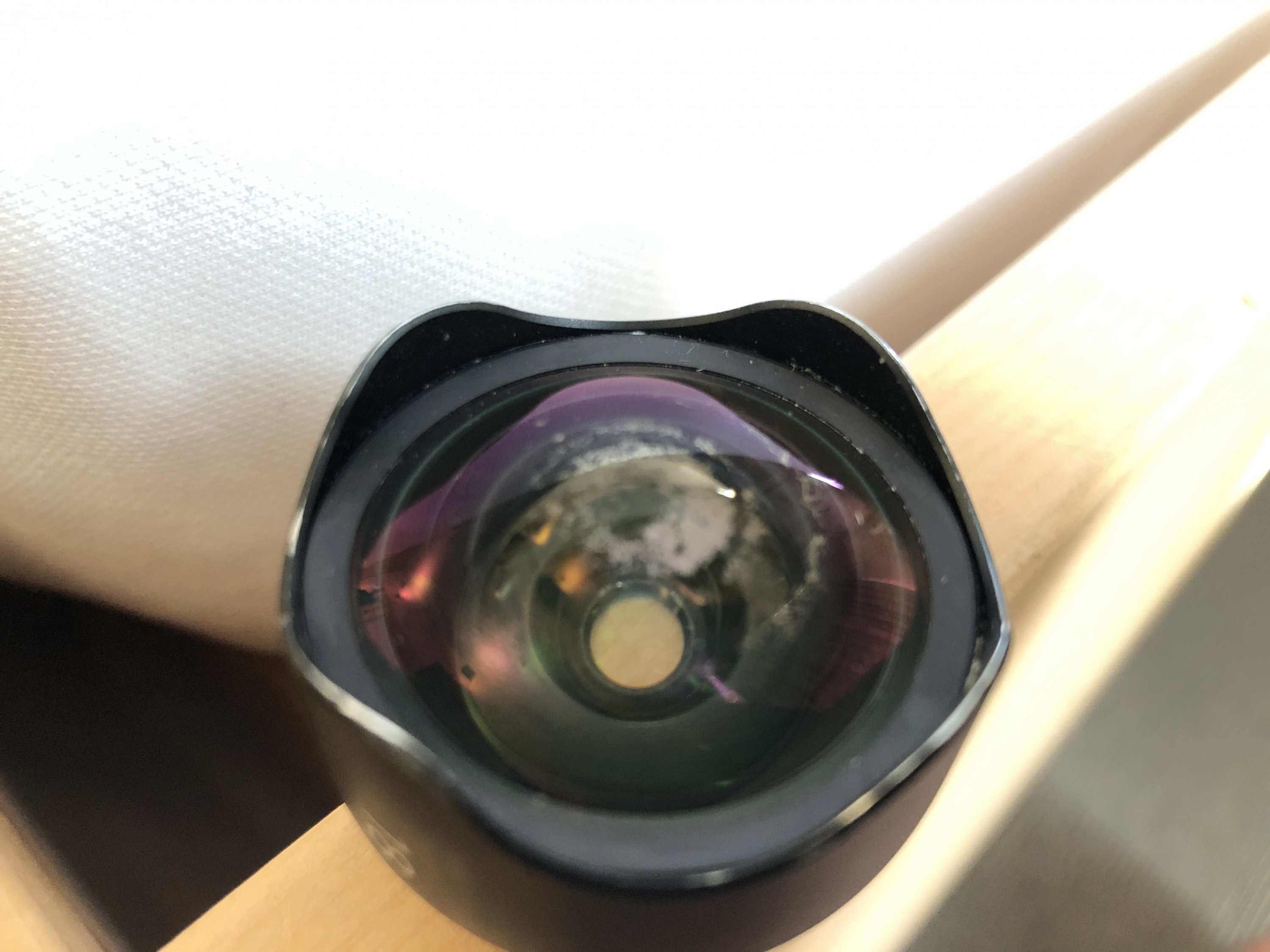

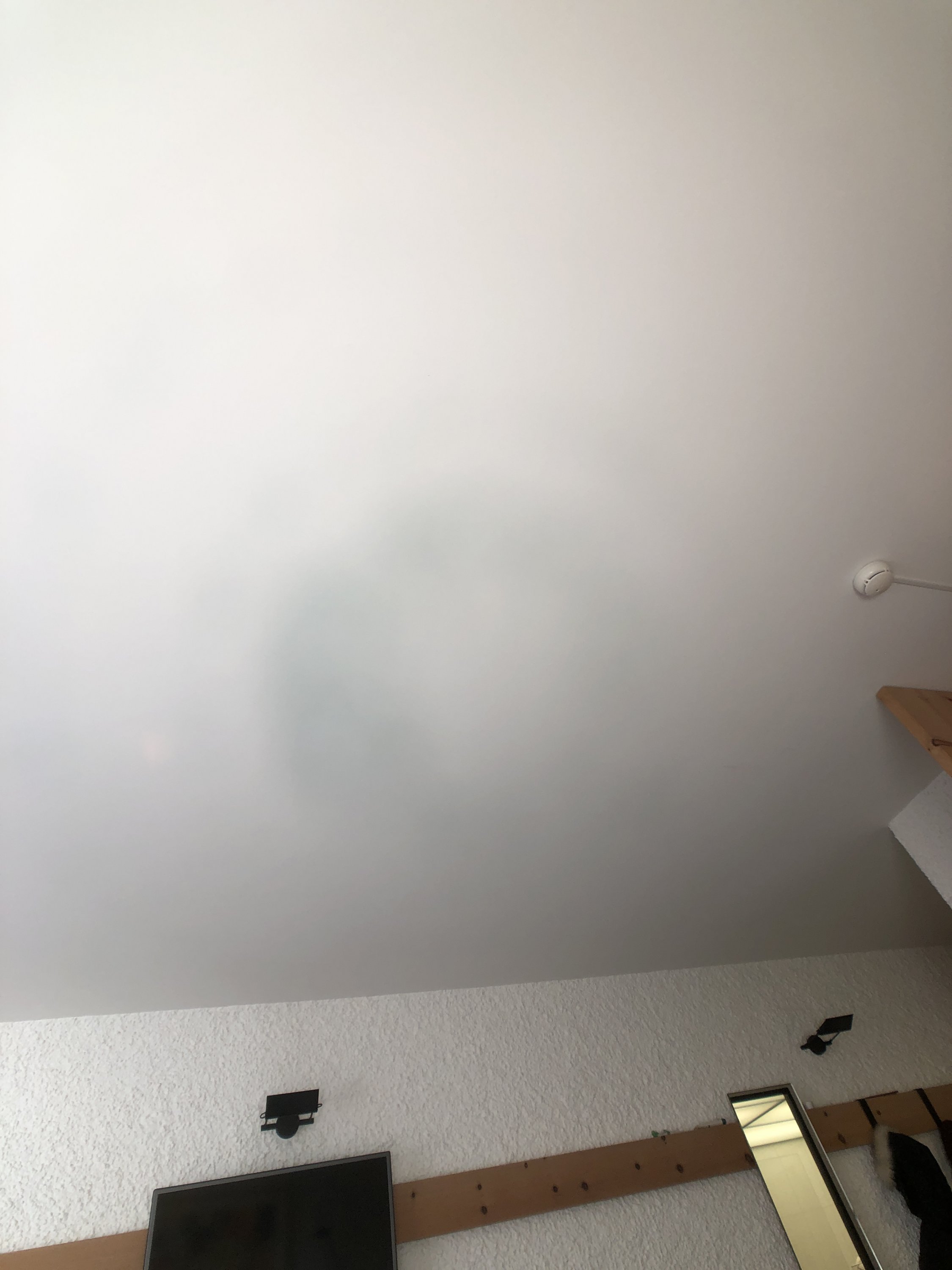

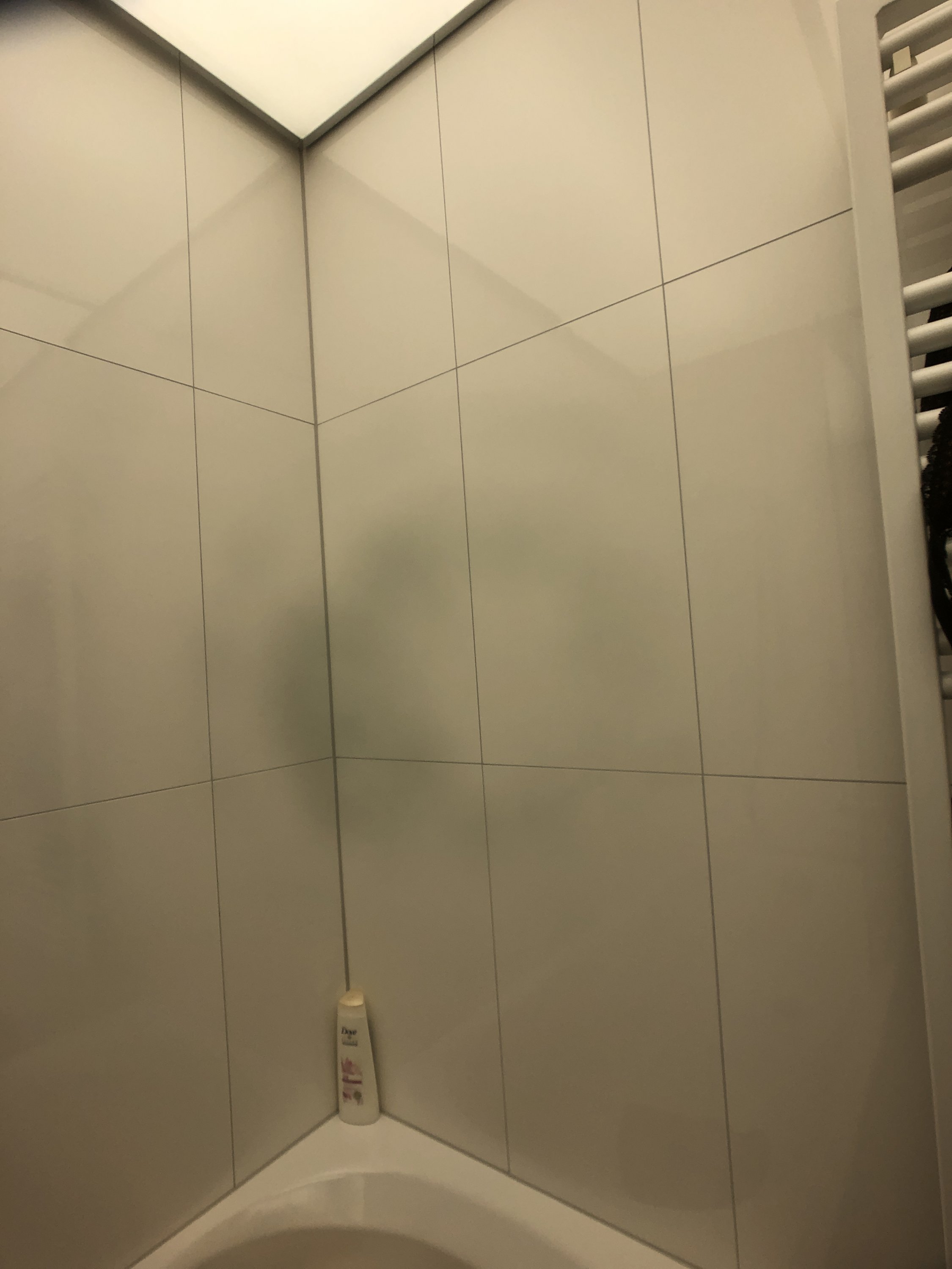

I've been using a wide format lens and have noticed the coating seems to be wearing off. I don't actually see scratches on the lens, but the coating is 'cracking'.
The effects are leaving a blur and dark spots on any backlit object.
Is there a DIY way to remove the coating altogether? Or to repair it?
I'm in the middle of a trip to Switzerland and would love to continue to use this wide format lens.
Thanks!

-) I do not see any "cracking" in your front lens coating. Could you present better photos?
Which means focus on the lens surface in the respective area.
-) No lacking of coating could produce such effect.

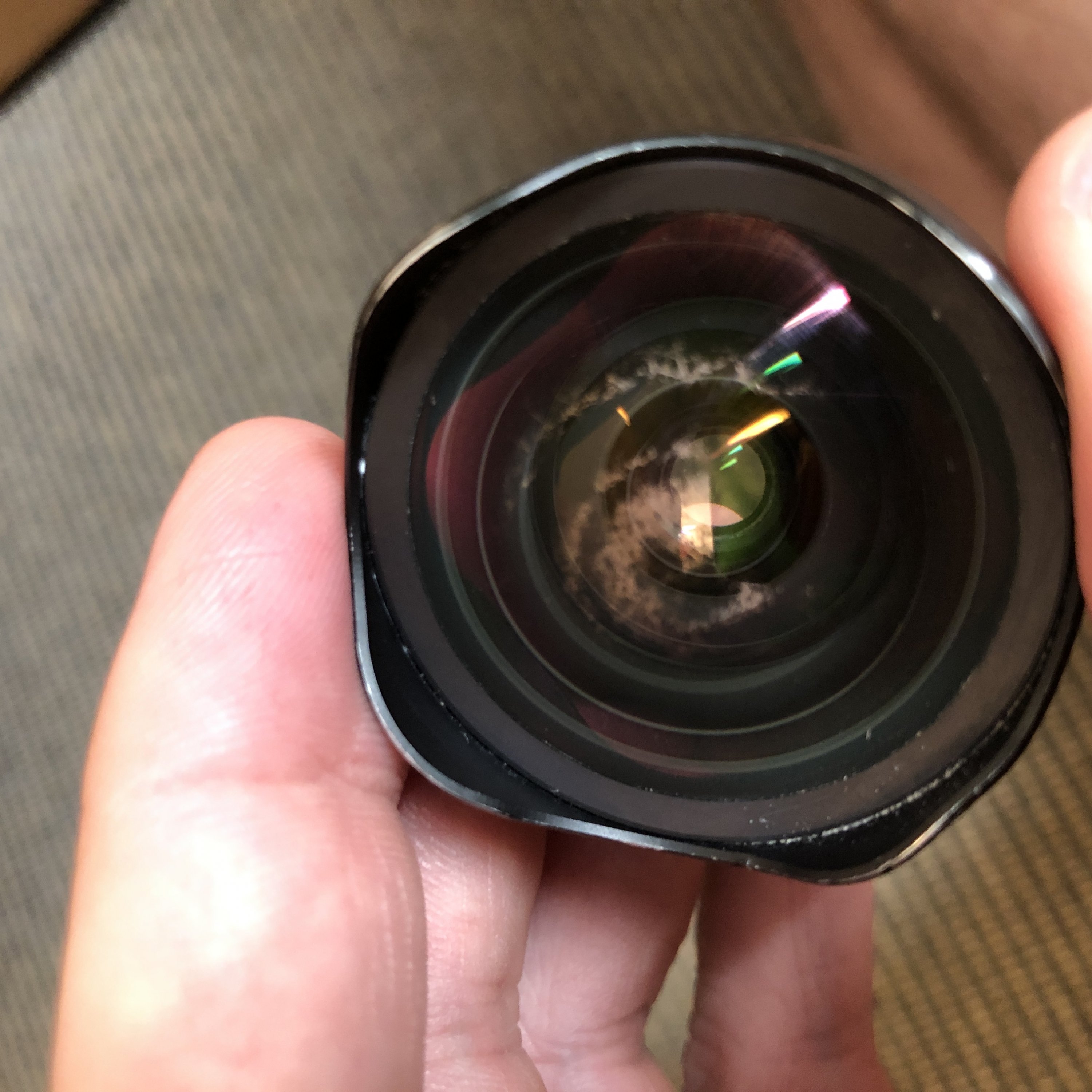

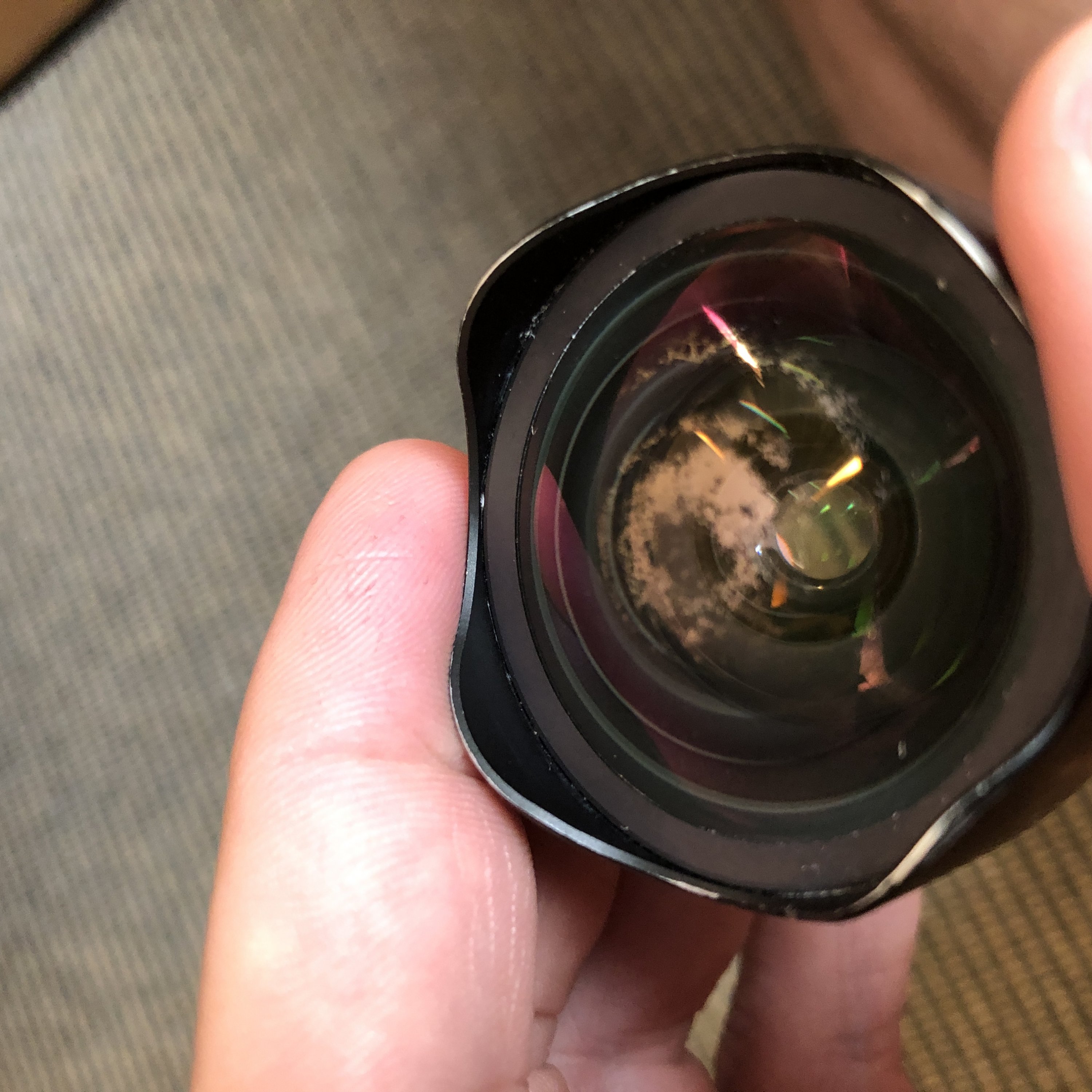

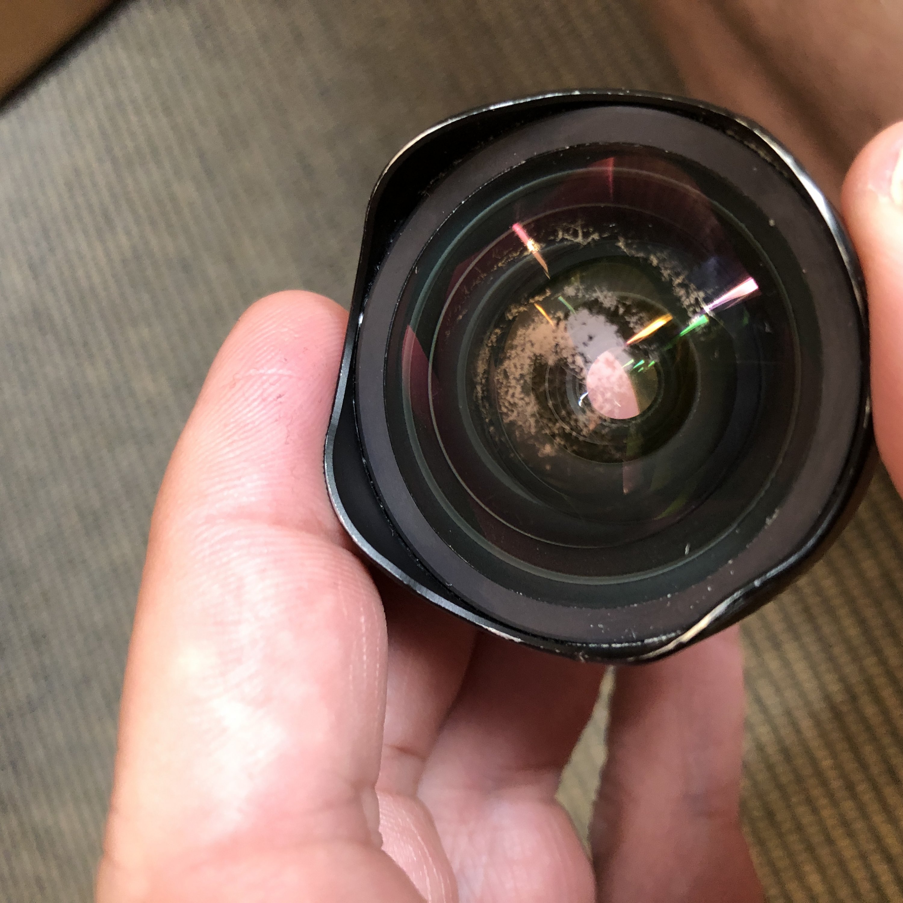

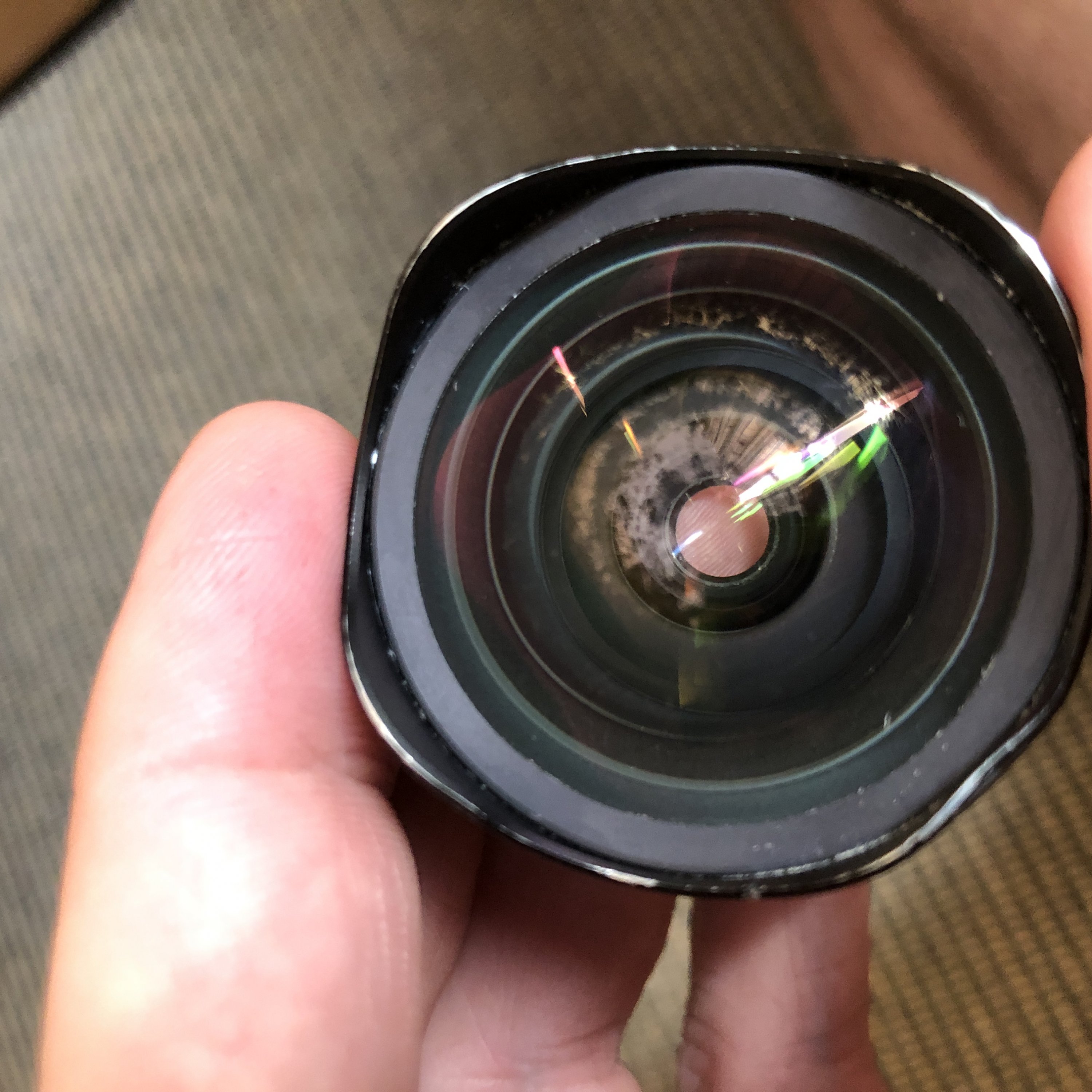

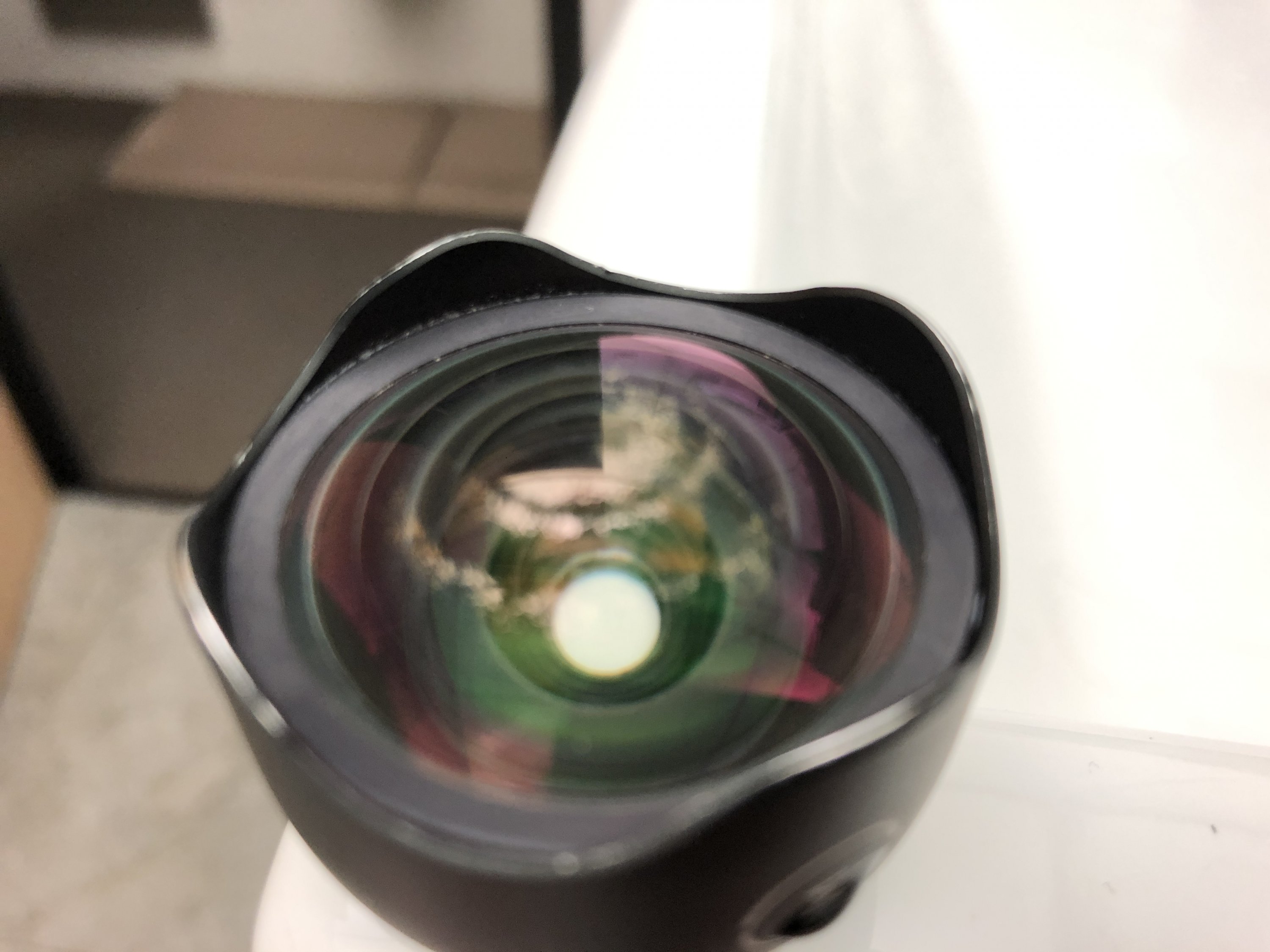

When I look at it up close, I don't see scratches, instead it appears to be a wearing away of the coating. The coating appears almost purple in nature, the glass beneath clear. Of course I could be wrong, just a novice, it essentially ruins the lens tho - for the shadow it presents in the photos. Here are the best pics I can manage right now (traveling)
Are the marks on the outer surface? Looks to be on inside element(s?) from the photos. So this could be something gassing off and redepositing on the lens? Since you don't identify the camera or the lens itself- hint, hint- I'm not certain if there is a shutter in the lens barrel or not. Looks not, but..... Separation? Doesn't really look like it but it could be just a type of separation I haven't seen before.
Was the lens in a hot environment? Glove box? On top of a heater?
Internal cleaning might take care of the problem.
Misinterpretation? I agree with post #7.
I think that there is nothing wrong with the antireflection coating, and thus, nothing to be gained by attempting to do anything to it.
I see clear, crisp reflections over the apparent defective areas. I don’t think this has anything to do with the coatings either on the external or the internal surfaces. I suspect that the clear optical cement bonding a pair of glass elements in the assembly is becoming opaque due to a failure of the bond between these elements. If so, here is no PRACTICAL repair. Any attempt to do so by a professional would likely exceed the price of buying another similar lens in good, used condition. It probably wouldn’t be successful if attempted.
If the problem is truly with the coating, then some chemical must have come in contact with the coating and reacted with it. From the photos you’ve posted, the defect appears INSIDE the assembly and not at the surface facing the observer.
What make and model lens is that?

Looks like fungus on an internal surface, or *maybe* debonding of a doublet but looks more like fungus.

From new pics, looks like an internal problem. Mold? Cement? Years ago, at a small local camera store I was able to buy a 28 mm Nikon lens for next to nothing because it had a deep scratch across middle of front element. No effect whatsoever on pictures. One of my long Kilfit lenses has eroding coating with little effect. On the other hand, cleaning marks can ruin a lens.

I think the inner back surface of the lens could possibly be cleaned and you'd be OK.
Conjecture; the lens was stored front element-down and was subjected to a hot, humid environment. The aperture lubricant evaporated, combined with the humidity and condensed on the inner surface of the front element.
To me it looks like corrosion not condensation. Question is whether the glass suface itself is roughened.

OP here, it's def on the outside (front) of the lens. It's been developing over the last few weeks. If I were totally honest I'd say that it's abrasions that have removed the coating on the lens. We were tobogganing and had a few crashes - so very possible the lens went through some snow. It's most def like the lens coating is being scratched off.
However, the reason I posted is that the lens itself is not rough, nor does it appear (on very close inspection) to have scratches in the glass itself. In the past I've taken many photos with used / scratched lenses (as a younger student) and you couldn't see them on the final results.
With this - you can totally see a dark halo (bruise) wherever the abrasion has occurred. I would have thought if the coating was scratched off, it would be brighter, not darker. I also thought these coatings were bonded to the glass.
I cleaned both interior and exterior with a few drops of alcohol in water - there doesn't appear to be any fungal issues or anything on the lens interior.
Anyway, appears the best alternative is to just replace the lens - unfortunately we're only in St. Moritz for 2 more days and I'm unable to get a replacement until we're back home. Next time might buy a backup.

I see what appears to be paint wear on the front edge of the shallow hood. Combined with a convex front element.
So is there a chance that over time, the surface has been rubbed by contact with clothing?
OP: it's just a Moment 18mm wide angle lens. Only $99 - but almost new.
https://www.shopmoment.com/shop/wide-18-mm-lens
Well, heck, for $99, take some toothpaste and see if you can rub out ALL the coating flaws.
Or contact the seller and get a replacement. Multi-coatings shouldn't react like that if properly applied.
First time I've seen phone camera referred to as medium format. I think this threw people off, thinking we were looking at 120 film shots. I wonder if the small size of phone lenses and sensors leads to a strange magnification of lens flaws?
Don't attack any lens with toothpaste. Perhaps something stronger than alcohol would help if it is fungus, as I suspect. Others with more expertise will probably provide more authoritive information. The lack of a good front coating shouldn't affect most photographs if the glass surface is undamaged.
A partially rubbed off coating, even at the front lens of a 18mm lens could not produce such mark. The difference in transmission would be too small.
Density at such patch must be higher. Apparent density loss by diffusion due to roughness would result in an unsharp image of the background too.

If it is for certain on the front of the element, you might have deposited aluminum from the shade onto the lens surface if it skidded across the snow.
