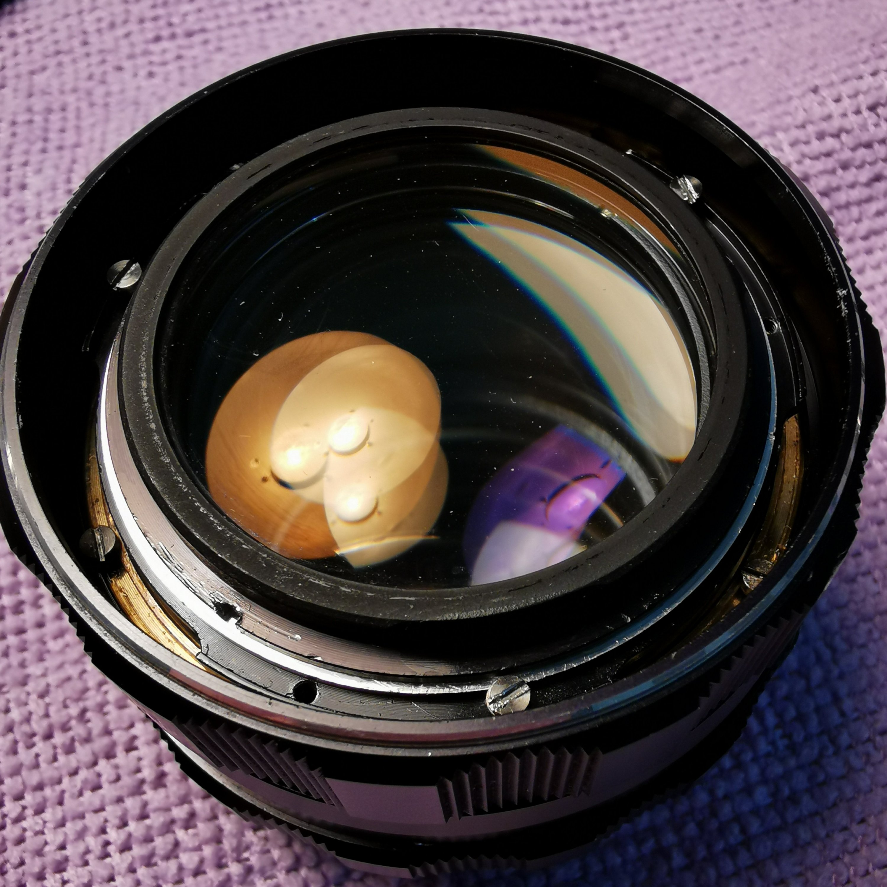

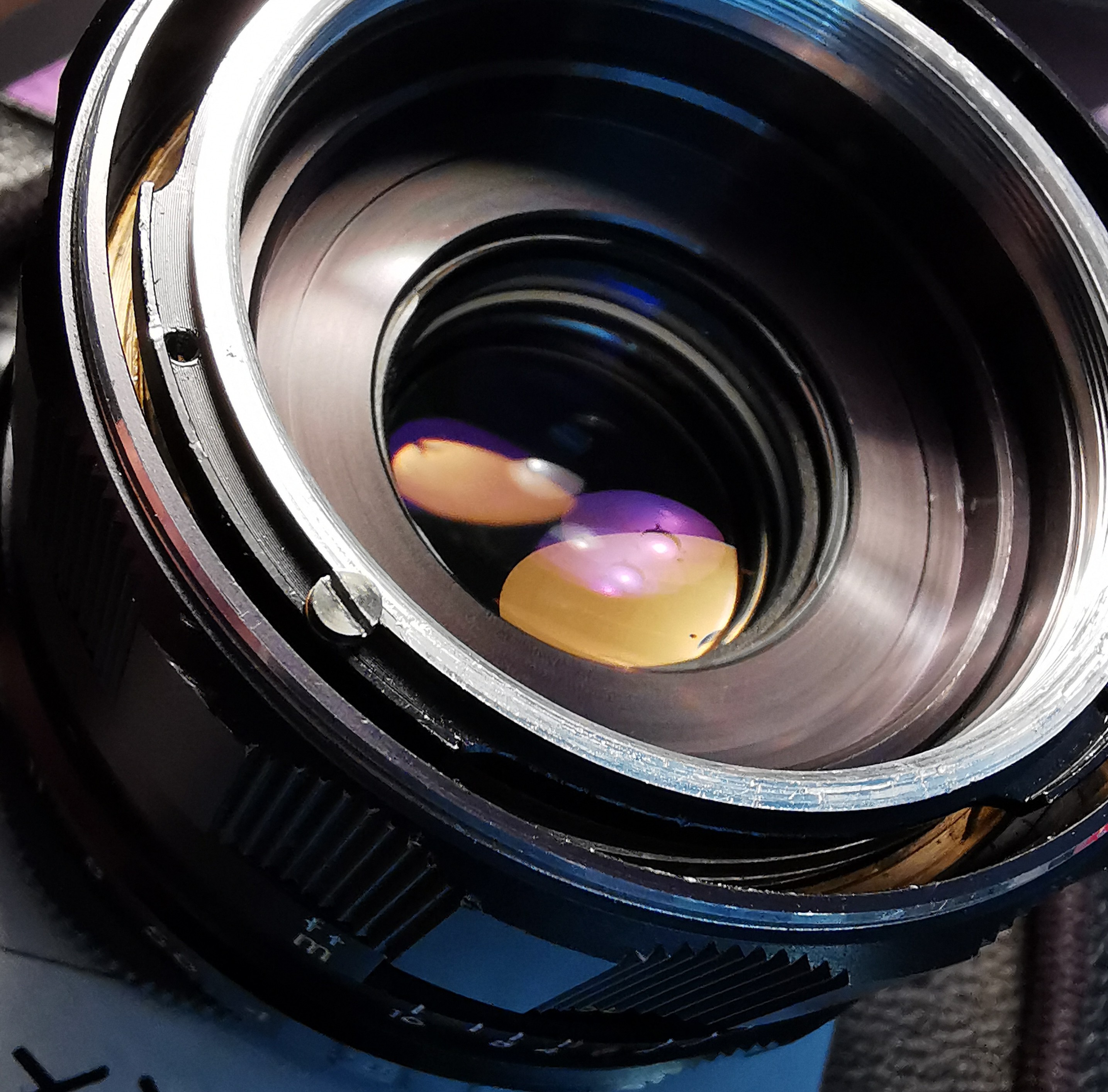

Hello
Here some pix to explain.
No, the lens elements are in correct position.
But when screwing back the front group the aluminium barrel moved, I didn't know this has a thread as well. This way the two groups were brought together a tiny bit closer.
