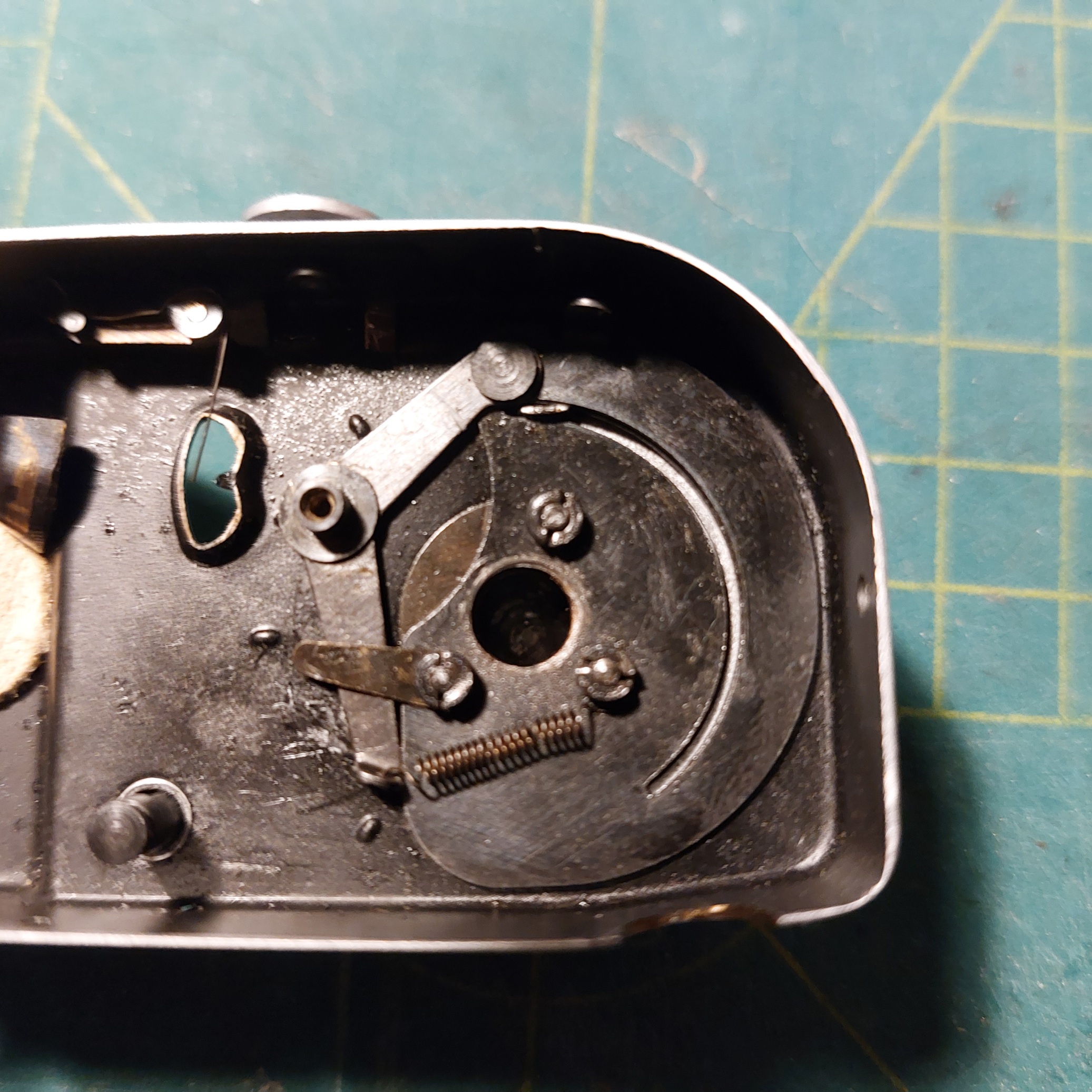

Hey all, don't know if anyone has experience with these camera's but I might as well try.
I took a leningrad camera home from the store I work at, mostly because it's cool.The camera is not functioning, a colleague probably overwound it while testing.
I took off the top plate and can see the following. The spring inside the big knob came loose from the slit in the rod it's supposed to be in, the rod is now loose and I can just pick it out. To put the spring back in it's place I think I need to take the big knob off the top plate. I found very little about this except one post on ussrphoto that mentioned it could be removed by unscrewing the 2 screws on it and just pulling it off. When I try this it just won't come off, it has a bit of play but that's about it.
Does anybody know how to fix it?
(I know this camera is very unlikely to work at all :smile:)

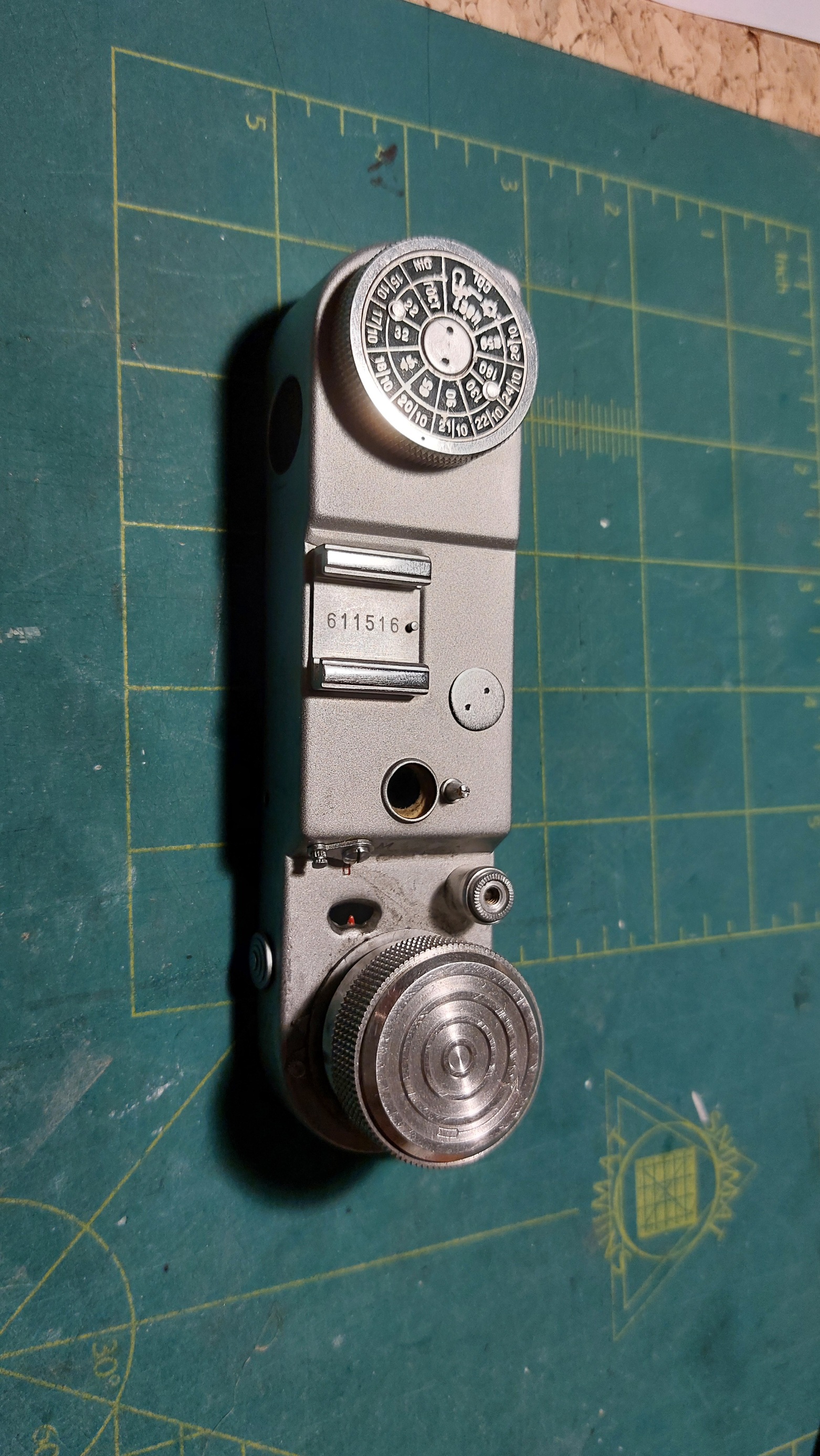

The top plate
View from underneath the big knob

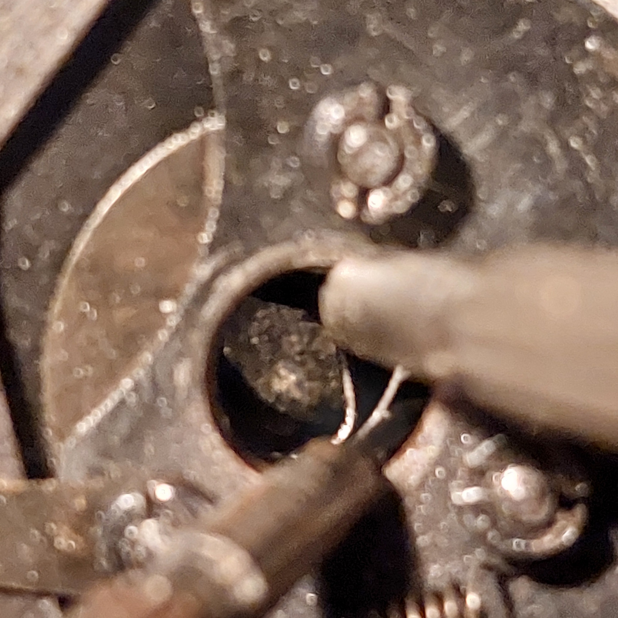

The spring inside the knob visible when i poke it with a screwdriver

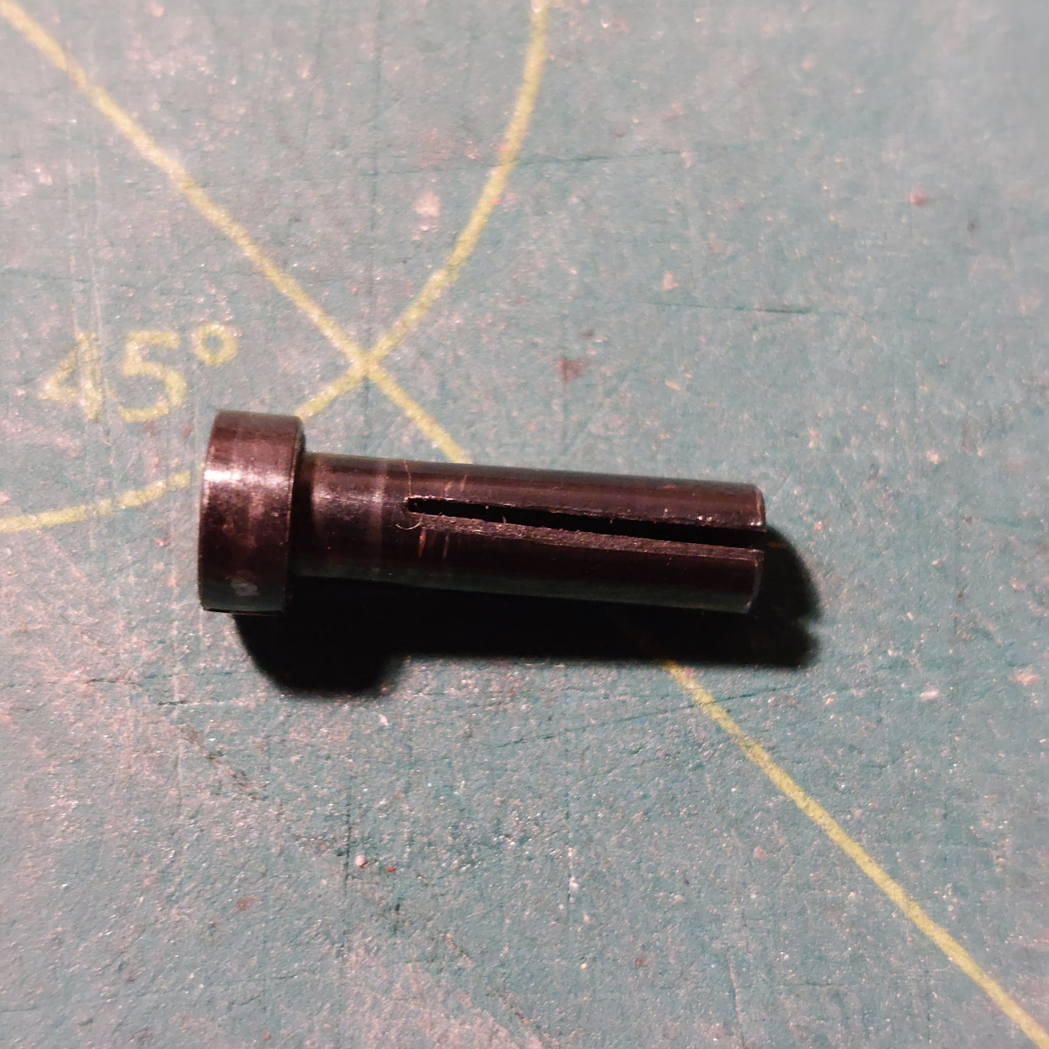

The rod with slit where the spring goes in, in found it in the hole visible in previous picture, slit seems to be where the spring attaches, at the head there is something that drives another part of the camera
