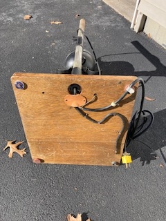

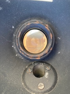

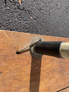

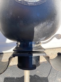

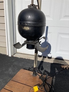

Picked up this early Valoy enlarger from a flea market. Not sure if it’s just 35mm format? I hope to get missing film mask/carrier from Kienzle in Germany. (They helped me acquire similar missing parts for my Kienzke TR-66(see photo).The condenser is supposed to move downward on to negative, handle moves but not condenser. Looks like a special spanner wrench would be needed to take apart? Very strange wiring on bottom separate from light source, probably some type of timing device? I know there are different opinions, but I would like to mount my leica Elmar lens from my IIIG to print with.Thank you.

Well got the condenser column to raise and lower, now I’m looking for a 35mm negative holder. Does anyone know if the holders from valoyII fits? This is a very early Valoy I. Thank you.
Just got a price quote from KIENZLE Phototechnik of Germany. Looks like I will have a working Valoy I enlarger soon. Thanks
Nothing weird about that - it goes from the outlet to a switch to the lamp. I'd scrap all that wiring and put a new cord just to the lamp. All that old wiring is not trustworthy. I replaced the cord in my ValoyII and all the wiring Focomat. The old wiring had insulation that was petrified clay.

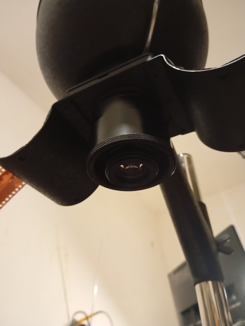

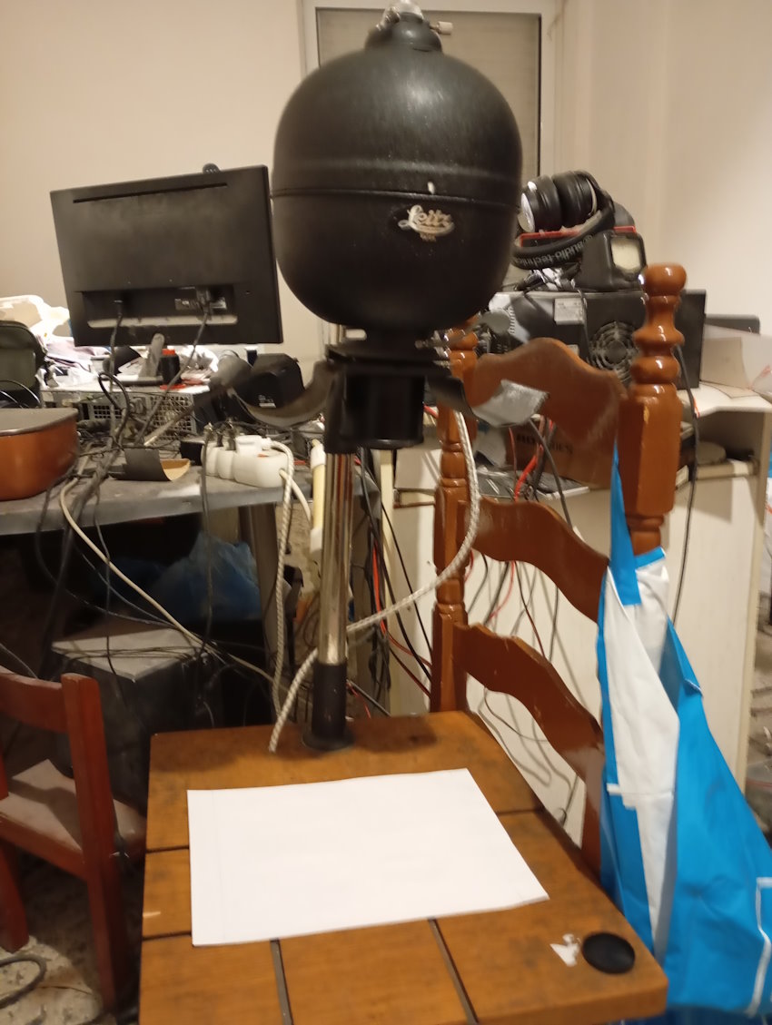

Update about my early (prewar?) Valoy enlarger. I cleaned and rewired it and installed a 9W 1050 lumens 2700K filament LED lamp (which is considerably shorter than usual). The condenser lens is of the clear variant, in excellent condition, absolutely no scratches! The negative holder also is in great shape! The best part is that I acquired (for free) a Rogonar 50mm 2.8 lens (the three element plastic cheap one). Lens installed succesfully and guess what? It focuses perfectly without needing an extension tube even at relatively large magnifications. Here are some photos!

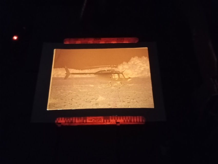

The projected negative is an old colour one , at about 24X18cm. The projection is on a plain A4 sheet. I hadn't the slightest problem focusing Rogonar lens, so I think I'm lucky (and very happy as I put back in action this vintage enlarger spending about 10 euros worth of materials)!!! The projected image looks bright because the lens is completely open at 2.8

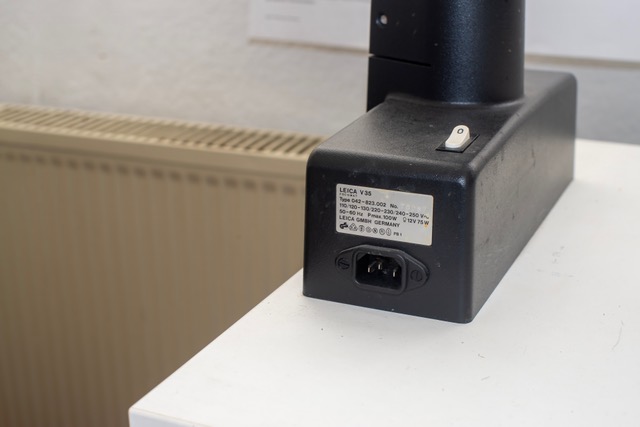

too bad you're so far awy. I could give you a newer Leitz V35 enlarger for free.

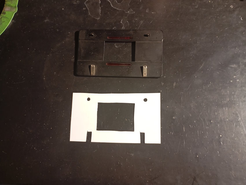

Good going! It's a very simple but solid enlarger. Your clear condenser will create newton rings on negatives (I learned the hard way). There is a circle of ANR glass that can be slipped on the end of the condenser. It may be hard to find. Another solution is to make a very thin mask, with an opening slightly larger than the image frame, to put above the negative in the holder, to prevent the condenser from actually touching the negative.
Yes, I know about this issue, and I think I have the perfect material for this: thin (less than 1mm) ABS opaque white plastic sheets, of the kind used for air modeling, which can be cut easily and make a mask to put between the negative and the condenser.
Just tested a Nikkor 50mm 2.8, and it has issues with focusing (it barely focuses only in very big enlargement). So this one for sure needs an extension tube. For the moment, Im very happy that Rogonar (although it is considered an inferior lens) matched perfectly with the venerable Valoy.

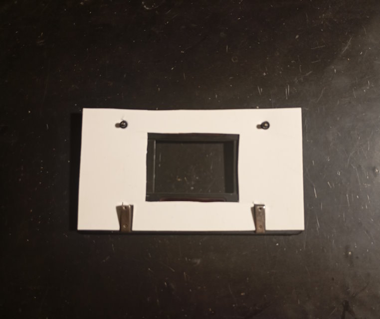

Just made the ANR mask! I used thin ABS plastic sheet and cut slots for the pins of the negative holder. Also I cut the frame window slightly bigger, as advised. I tested it and works perfectly (well this means that negative holder slots just fine into the enlarger's head slot). Also I noticed that this mask helps aligning the negative. I saw somewhere here in the forum that the US Leitz importer sold decades ago a similar ANR mask, made from hard coated cardboard (obviously the suitable material for hot tungsten bulbs). But since I'll use LED bulbs, I think there will be no problem.

Update about my Valoy enlarger: I got (again for free) an old soviet 50mm Industar 96U-1 lens. Also I bought a set of M39 extension tubes from Aliexpress, dirty cheap! They're brand new, made from machined aluminum. The set includes three tubes, 7mm, 14mm and 28mm. I tested all three lenses I have now (Rodenstock Rogonar, Nikkor L 2.8 and Industar) and all of them work perfectly now!!!!!!!!! I used the middle tube, No2, the 14mm one. This tube is roughly (give or take few mm's) similar to the original DOORX Leitz tube. So I think that with this set of tubes, using in our case only the 14mm one, it will work also for Valoy II enlarger and with some adjustment for the autofocus function, with Focomat Ic. There's also a similar soviet 3 tubes set sold mainly by Ukranian sellers at ebay, with slightly different tube lengths, which I guess it will work just fine as well. I bought also a used Marumi focus finder (a very similar design to the well known Patterson one) and the film grain when focused is sharp and well defined. Especially Nikkor lens (and this I guess is not surprising) gave the finest and sharpest grain focusing of all three (Rogonar is just fine, but not as sharp as Nikkor and Industar is a bit on the soft side, but not bad at all).
