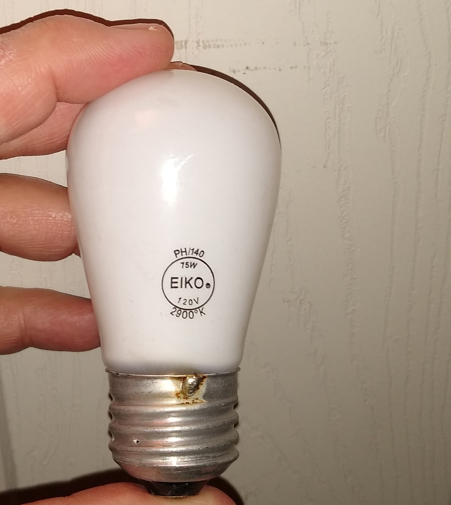

Here is the "correct bulb" for the Valloy II, as I spent a week or so looking for which was needed, though it was so long ago, I can no recall the 'authority' on the matter.
A quick check tells me the bulb is l, from toe to apex, 3 1/4" long.
In this picture, you should be able to see the information needed, but, in part, its an PH 140, 75w, EKIO, 120V, at 2900°K.

Thanks very much for the additional information - really useful. That explains why the search for short neck bulbs is fruitless. Cheers for the picture Eli - I will pick one of these bulbs up and see how it goes. That bulb correlates with a shop here in the UK who said a while back to me that the PH1400 75w is what they suspected to be a 'short necked bulb' - its the same bulb made by Photolux.
Eli, Ben, let us know your results from actually printing with this bulb!! I believe 3 1/4" is 8,25cm, right? That's quite a bit smaller than the original bulbs. I am very curious about them. In particular about their yes/no even illumination.

Hilo, my Valloy with this bulb prints quite well.
I had tried a larger long necked bulb years ago, when I first rewired it, but the lighting was poor, too much and just good for turning my Valloy into a benchtop 'monkey heater' on a winter's day.
I quickly researched what was needed and it was this bulb, which, if I recall rightly, was from "Bulbs Unlimited", which was well set up for enlarger and photographic data on bulbs needed for particular tasks.
I think I've one or two spares, bought at the same time as this one, which has been flawless, but I'd have to go exploring my currently untidy darkroom at some future point.

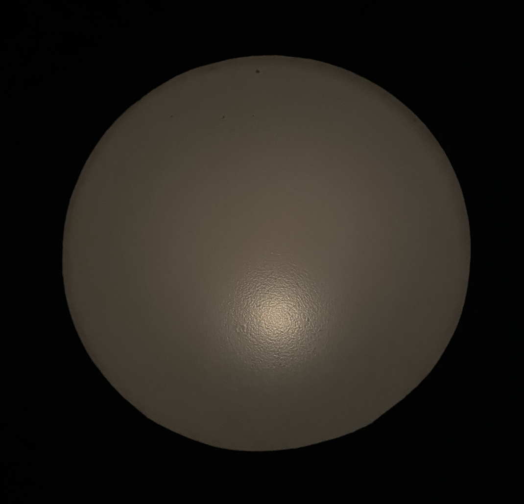

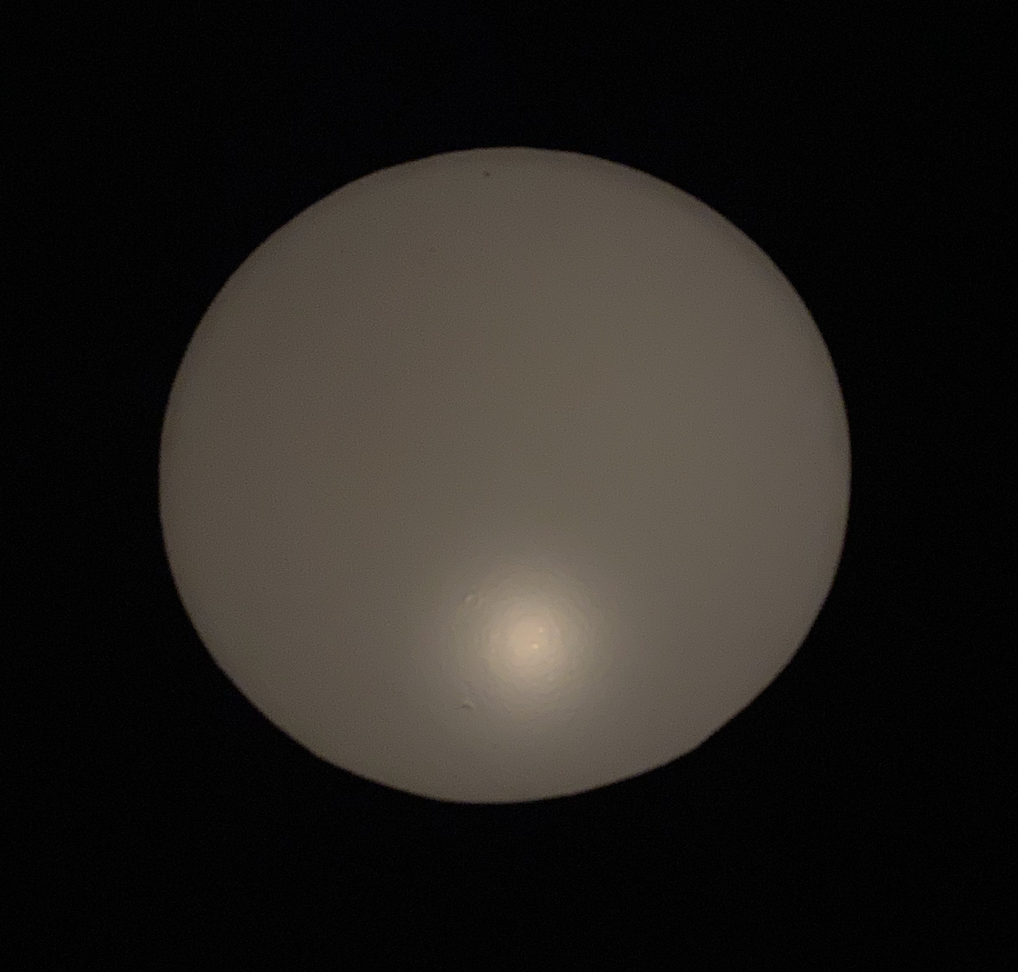

The 75w PH1400 arrived - first picture is the light on a white baseboard @ f16. Second image is the Philips PF605 150w bulb ive been using on a white baseboard @ f16. I dont really know what to look for but both look fairly even to me. I won't be able to test the 75w bulb for a few weeks on an actual print.

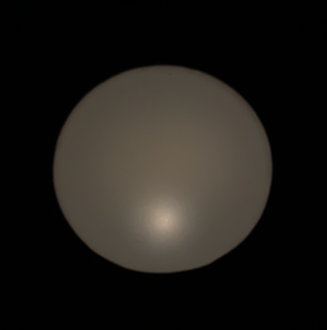

Just realised first image (75w bulb) isn't in focus - oh dear. Better one attached

Remember, even in small prints, a lower power level gives you more time to (accurately) dodge, burn images.
High powered light levels strips you of that option.
Let us know your personal results, whatever you choose to use, please.

Clearly the 150w bulb gives the most even projection. The projection of the 75w brightens in the center, both out and in focus.
If I were you I would use a very even negative. Even in mid tones for sure. Best for a comparison would be when you'd find the old bulb of 75w.
Having said that, I truly dislike testing and I never do it. So, if I were you I would just use the new bulb and take off. Just stay critical of you results.
