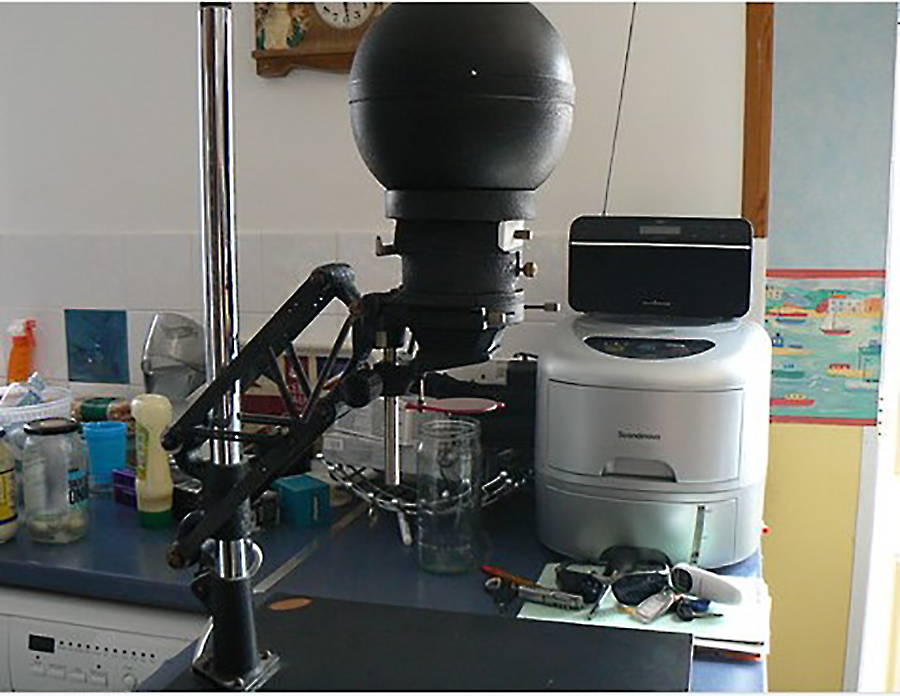

I am not well versed with Leitz enlargers except the V35. I know about the Focomats and the Valoy and wasn't sure of the build of the Focomat with the parallelogram height adjustment was common on some of the Leitz enlargers. I know the AF on the V35 could be problematic at times.
I used to have an enlarger that was made in Britain called Gamer. It was a hybrid of bother the non AF Valoy models and the Focomats. It looked and worked exactly like a Focomat but retained the large heilicoid focussing of the Valoy. I owned one in the 1980's but sold it on when I partially went over to colour printing. It was very well built and even had small drillings in the focussing pivots for periodic lubrication to stave off ear on the bearings.
With the increase in price of colour materials and chemicals I am considering going back to B&W only and if I was to come across one of these Gamer enlargers that may just be the push I need.
The picture below is the same model that I had (but wasn't mine)
This Gamer enlarger looks very special. And yes, it seems somewhere in between the Focomat Ic and the Valoy II. The Leitz Focomat enlargers also have these small holes which were painted red. We're supposed to drop some oil in there now and then.
Was your Gamer enlarger 35mm only, or also larger? Without the automatic focus system, to go larger was much easier.
It was 35mm only but what well engineered piece of equipment it was. The only problem I had with it was due to the very tall column it was prone to shake if you were not ultra careful. I fitted an angle bracket to the wall behind and screwed into the metal pate at the top which sorted that out.
