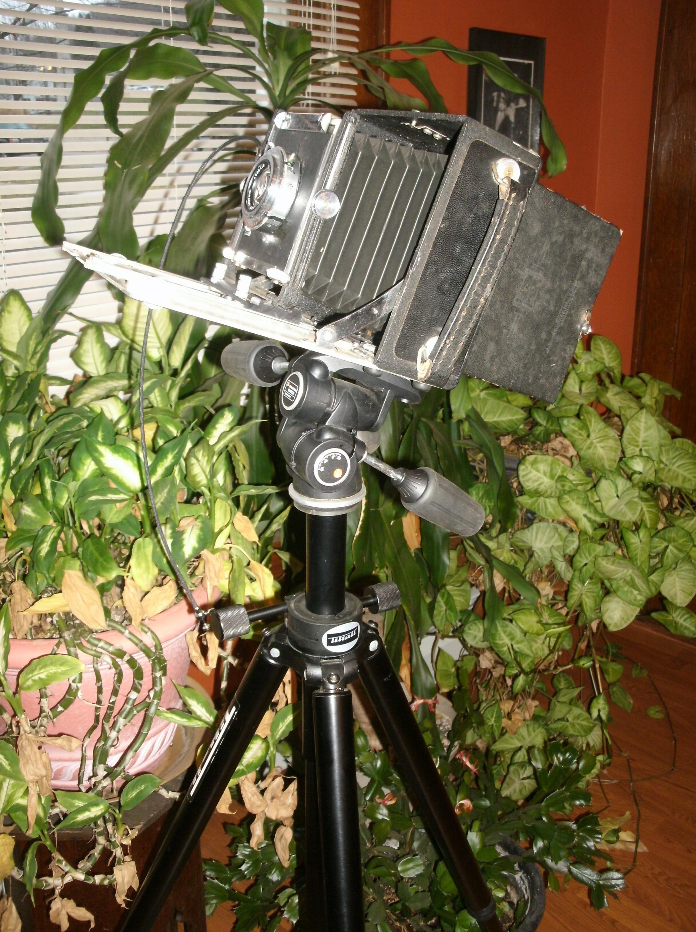

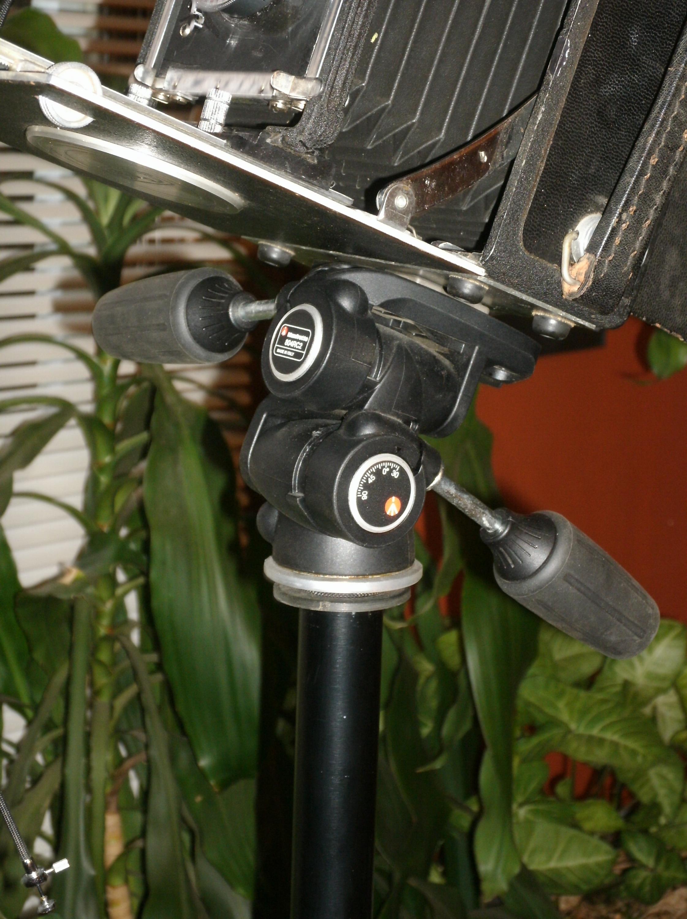

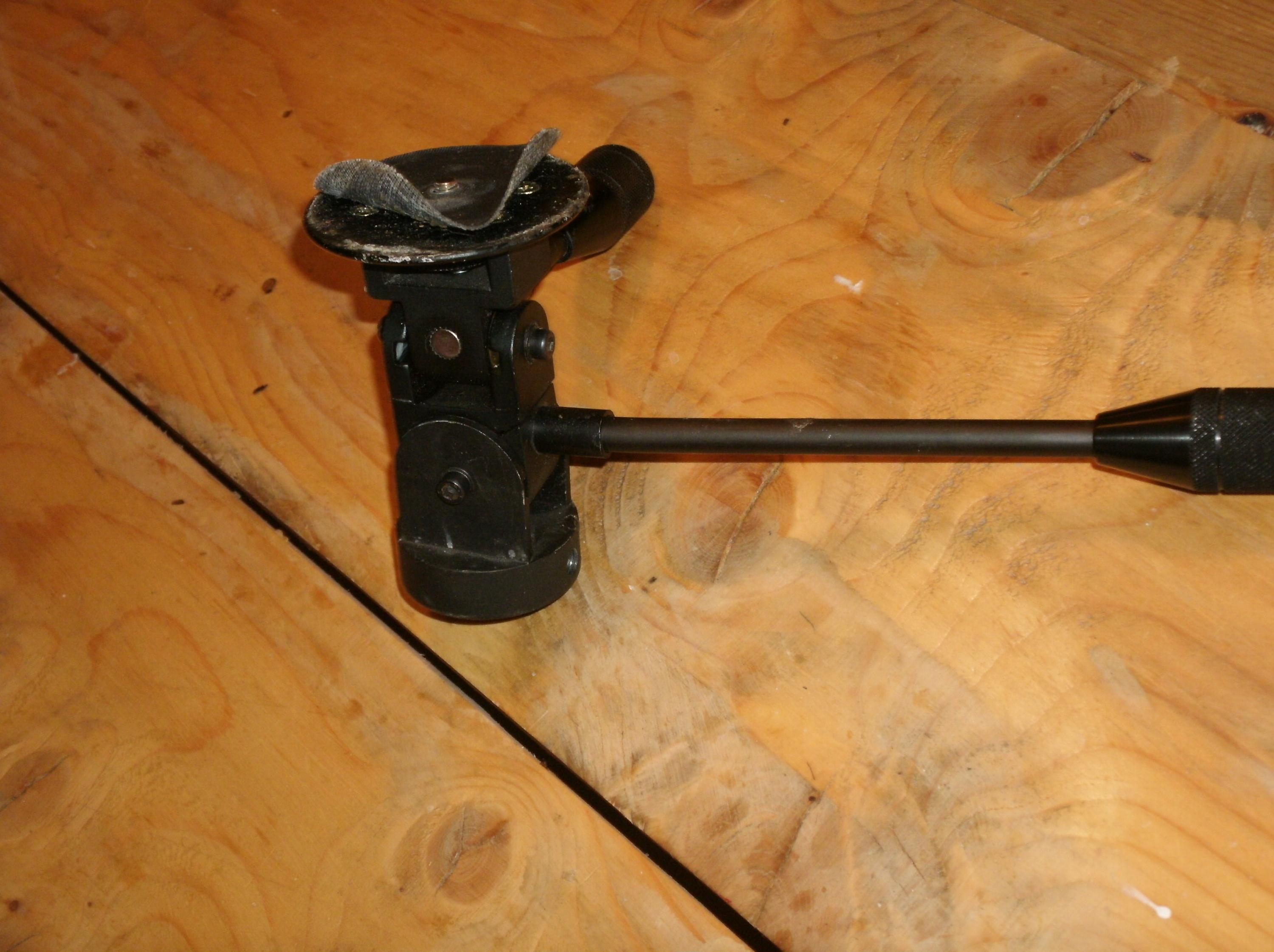

My modified Tiltall, you can't do this with Marchioni Bros. or Leitz models. I can still reattach the original head if I want to, but this works better for my arthritic hands.
