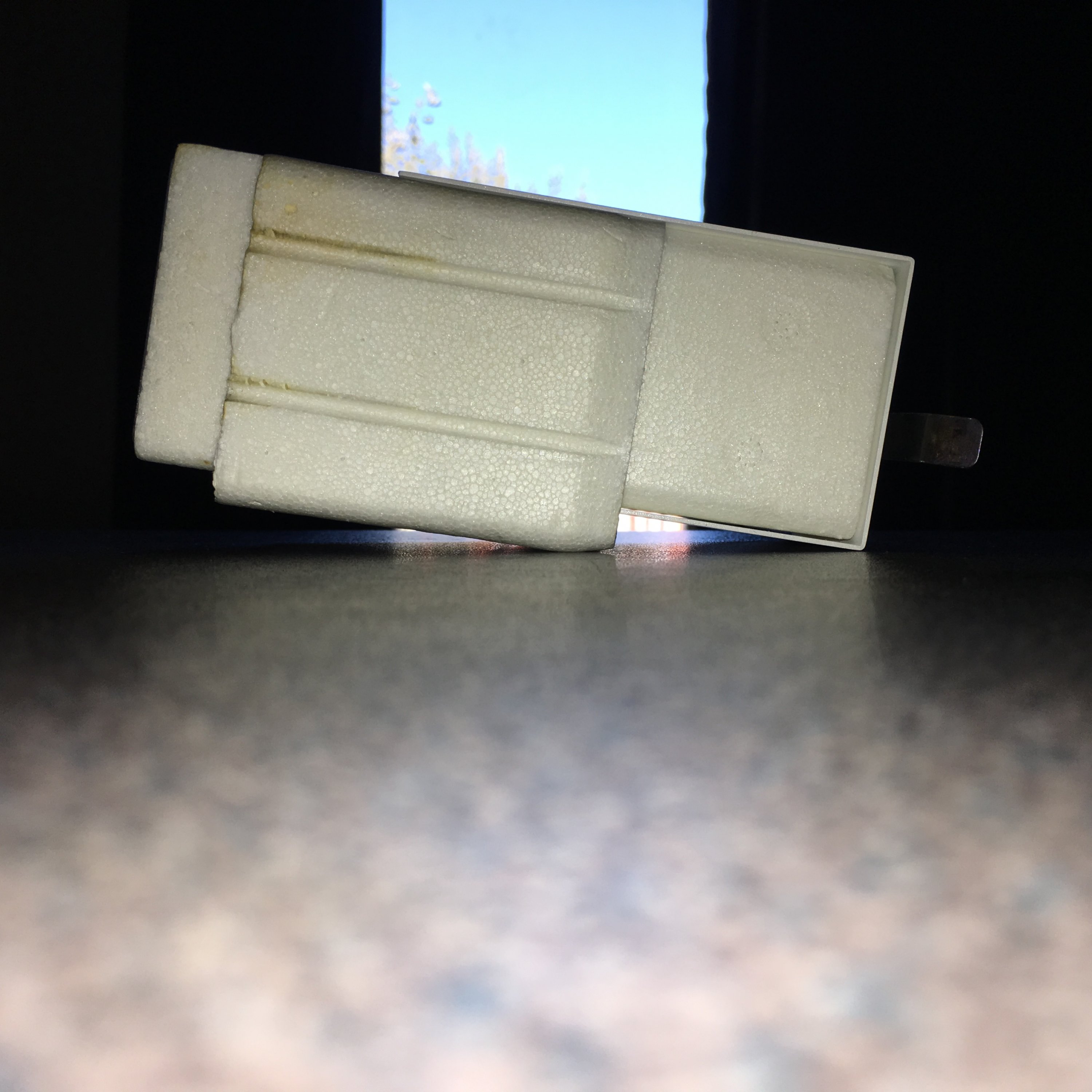

On to my little layman's test to ascertain whether the lightbox is a single- or double-condenser lightbox.
Directly below is an image of the V35 single-condenser lightbox on a flat even surface, with the light entrance for the IR cut-off filter facing upwards. The single-condenser lens is to the left of the image and the unit balances out with a slight tilt.
Leica Focomat V35 single-condenser lightbox

It appears the weight of the extra condenser lens suffices to balance the unit out flat - this does not happen with the single-condenser unit. Hope this makes sense.
