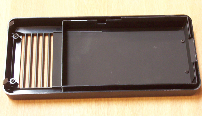

    I don't have a photo of it but it's got a spring clip that keeps it in place. Two protruding notches in the back of the cover slip under the rear lip and the spring at the front locks it in. Or as it the other way ? doesn't matter.
    You don't really need the cover to lock into place since there's not really a lot of movement when raising or lower the head. I would just fashion something from a piece of aluminum or similar and bend down the sides a bit to keep it from sliding off. You could add some foam seals around it to control any light spill or spray some matte black paint on the underside.

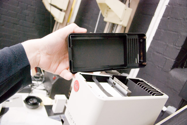

    Here you go. Two crap photos!

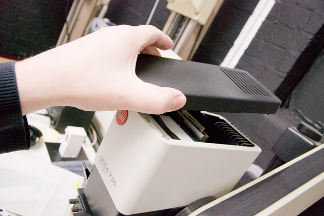

    Oops!
    Hopefully here's the second one.

    Everybody thanks for the help( especially Mike), I'm very happy with the second "crappy" photo it explaines how I have to fix and bend a metal plate. Now it's up ,to me to make it work. Albert

    Keep in mind that there is venting in the top so that the bulb doesn't overheat. It gets seriously hot!
