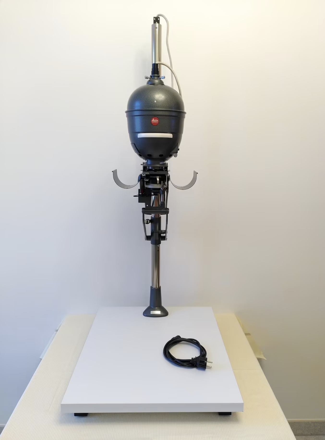

These decent? There is one for sale locally, but I don't know anything about them. If I were to purchase it, it would mostly be for nostalgic purposes as I already have a Beseler 23C III XL. Doesn't come with lens, but I'm assuming I can use similar lens(es) that I use with the Beseler (maybe my assumption is incorrect).
It is a lot better than your Beseler. Looks complete. Has a neg carrier and has a filter carrier. Looks like a custom one but good enough. Most 50mm lenses will work on it. One of the best enlargers ever made. Easy to use too. Once you get the autofocus dialed in you won't have to bend over a grain focuser at all. Should you buy it? I suppose you would be a fool not to if it doesn't cost too much.
This is one of the early versions of the Focomat Ic. You can tell by the black oval nameplate and the two small metal colored parts that portrude on either side just below the lower half of the enlarger head. These lock the enlarger head when you bring it down onto the negative which lies on the negative mask. Leitz improved this locking system to only one such locker on the left side of the head which made it quite a bit easier to work with.
It is difficult to see but I think there is no Anti Newton glass on the condenser. Difficult to find and will cost anywhere between $ 75 - $ 125. This round glass sits in a black metal ring and you slide it over the condenser. There are other ways to avoid Newton Rings, like cutting a a carton mask that you put on your negative, so it doesn't touch the condenser's glass.
One screws the lens into the helicoid and in between lens and helcoid you must use an extension ring of about 1cm. This is called 17675 or DOORX. $30 - 50. . . It is possible this ring is already installed.
I imagine this has the short column of about 85cm. There's also the version with the longer column, 120cm, but I am not sure if the first Ic's came with this longer column.
Given the age (1950/1951) it is important to know if the condenser is clean. You will need to remove this condenser to see that: 1) take off the top half of the head, 2) unlock the black bayonet ring, 3) remove the spring, 4) pull up the condenser.
If the AN glass is actually attached under the condenser, take this off first. Otherwise it will fall off when you pull up the condenser.

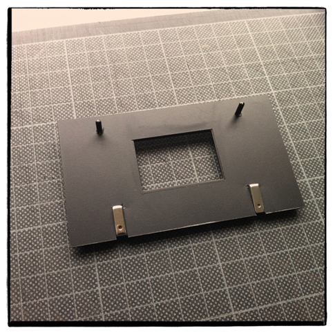

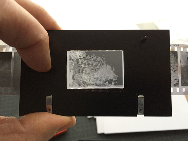

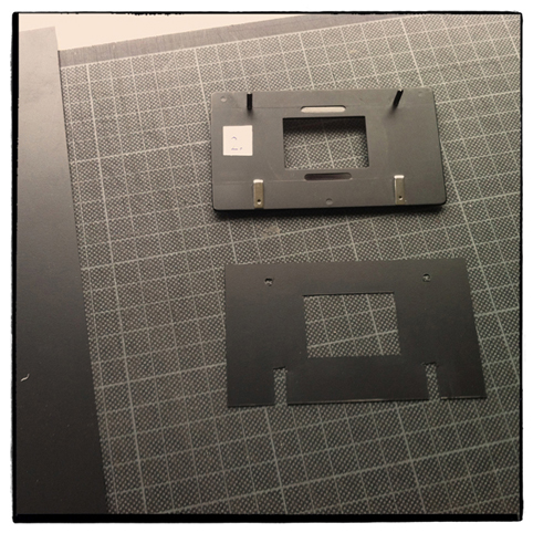

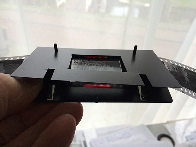

Pictures of a solution to Newton rings with the Leitz Focomat Ic and Valoy II
I got these black pvc sheets at the office supplies store. Very thin stuff, like not even half a millimeter.
For those unfamilar with the Focomat Ic and Valoy II: this is the negative holder that slides into the lens stage and fixes itself. One positions the negative strip on top, then you lower the condenser to land on top of the negative. This presses the negative flat. And it is why Leitz made a AN glass that slips on to the condenser. For the early Valoy II enlargers Leitz made a brass ring, with a cut-out the size of the negative, which you could slide over the condenser. The later Valoy II versions came with the glass of the condenser AN treated.
View attachment 290402 View attachment 290403 View attachment 290404 View attachment 290405
That's a good, simple solution. I get Newton rings using my 1c every now and then. I only got the enlarger recently, so hadn't looked into how to prevent it.

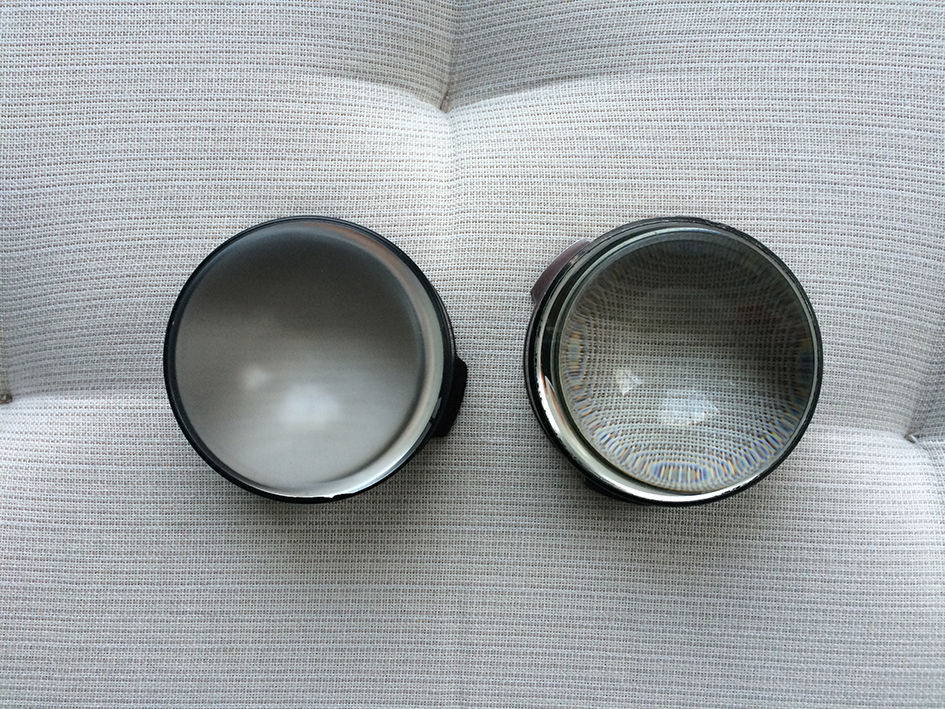

Leitz being Leitz and always improving, then made the anti Newton treated condenser for the Valoy II. The latest version of the Valoy II (light grey, smooth paint) came with that, but also some of the second version Valoy II did (darker blue-ish grey, wrinkle paint). Of course this AN condenser can be found on any Valoy II, also the first black version: one could just buy one. Second picture of the two condensers.

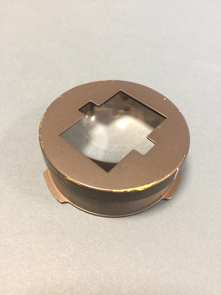

For the Focomat Ic Leitz just made the Anti Newton ring that clips onto the condenser and presses flat the negative. Third picture.

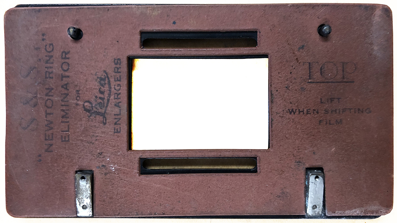

Oh, actually some company did make a so-called Newton Ring Eliminator for Leitz USA or Leitz Canada. Fourth picture.

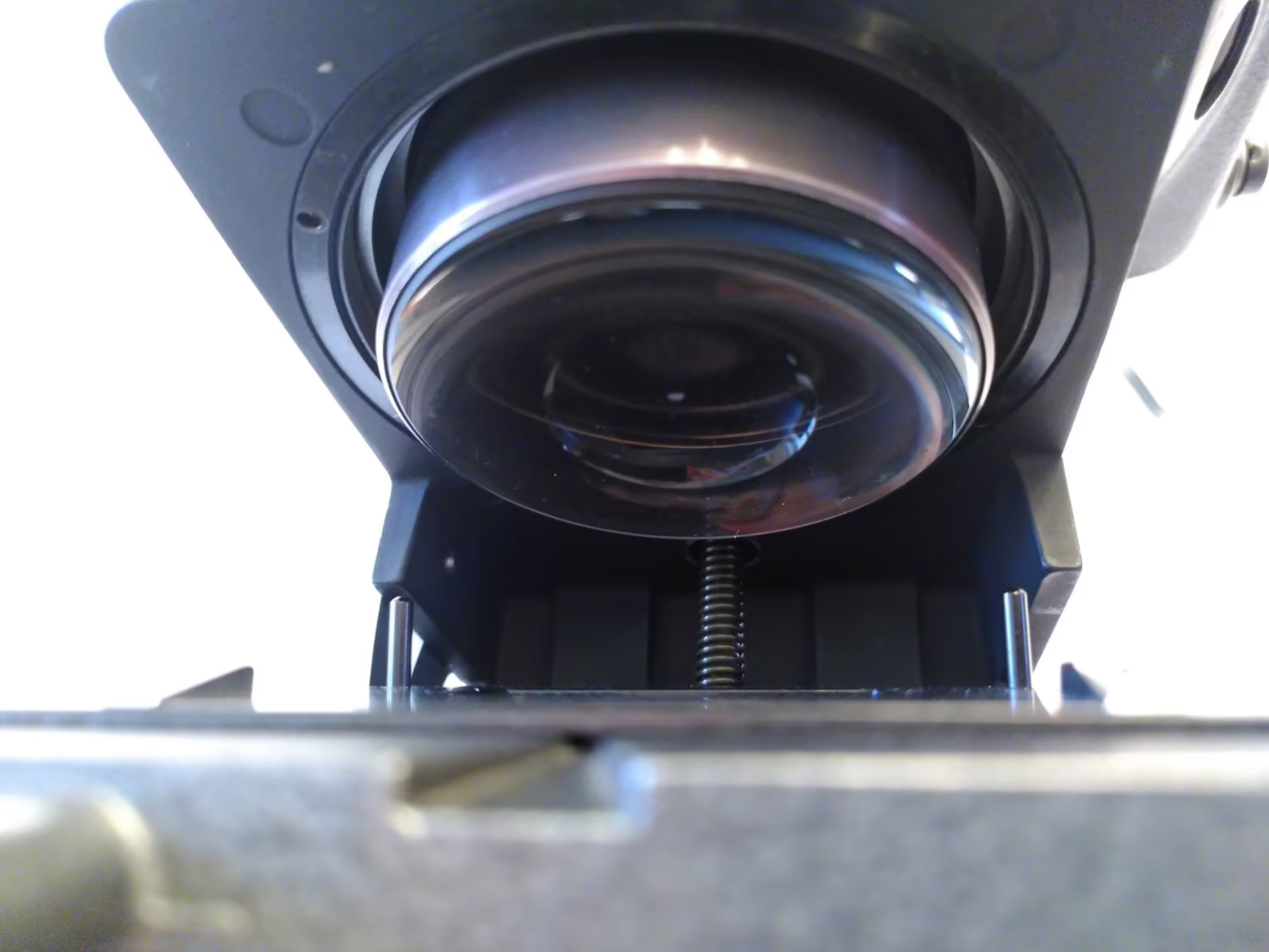

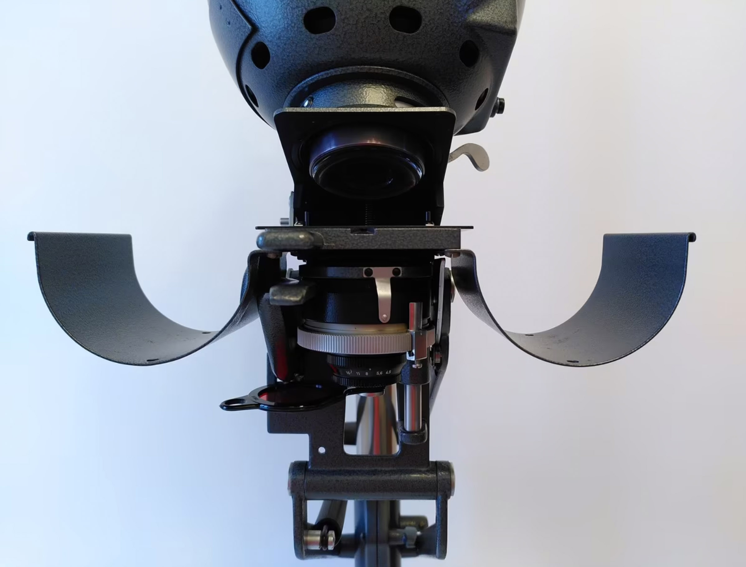

Would you be able to say, from the attached pictures, whether this Focomat Ic (apparently the late version) has that anti Newton ring installed?
Thank you very much in advance!
