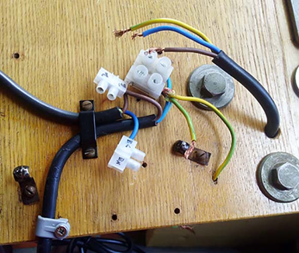

Hello my friends. I have just received my recently purchased Leitz Focomat 1c enlarger and this is how I received the cables after removing the black cover, Can you help me arranging them? Thank you.
EDUARDO
I live in Colombia where we have the same power standards as in the USA.
