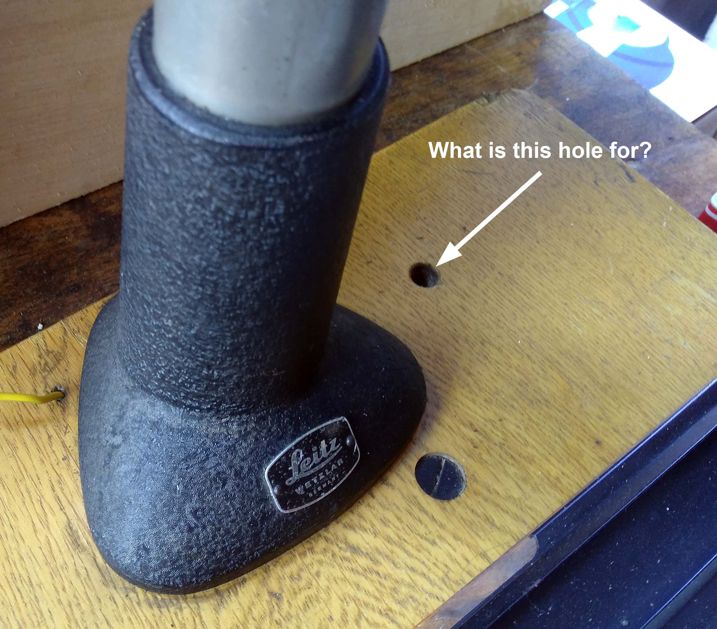

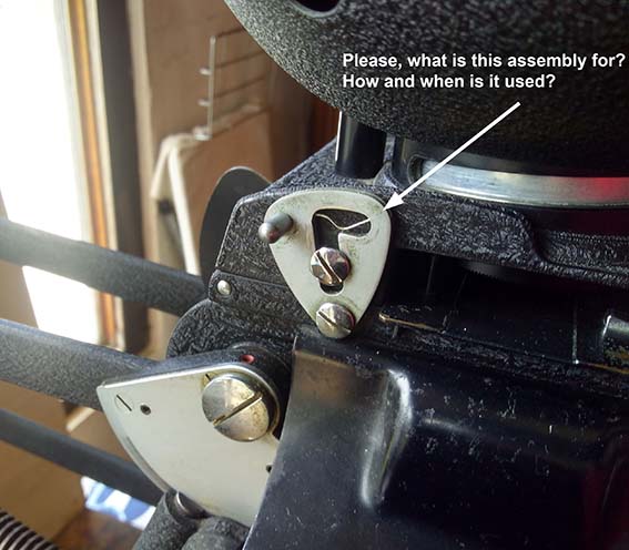

But I have more questions and concerns. Please check the photos IMG_20180310_100627152_HDR.jpg
. Can you help me with this issues?
AgX
Apr 5, 2007
29,973
Germany
-) my question regarding the use of a clear bulb was directed at member Saganich.
-) that thing is a lock to arrest the enlarger head, as the head can be swung back to give access to the film stage.
-) that hole on the baseboard was intended as hole for a mains cable, leading to a mains socket mounted just on top of it and intended to feed a specific Leitz accessory.

Thanks. What specific leitz accessory are you referring to?
AgX
Apr 5, 2007
29,973
Germany
A magnification scale. It was illuminated by a bulb and thus needed mains feed.

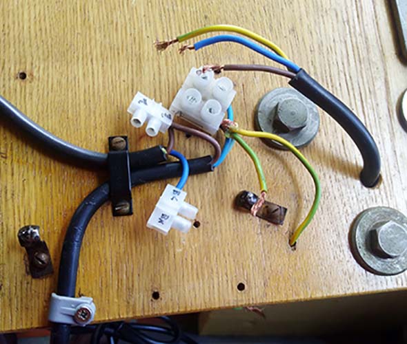

Another question. can you help me how to organise the connections that I found under the enlarger base after removing the black cover?
