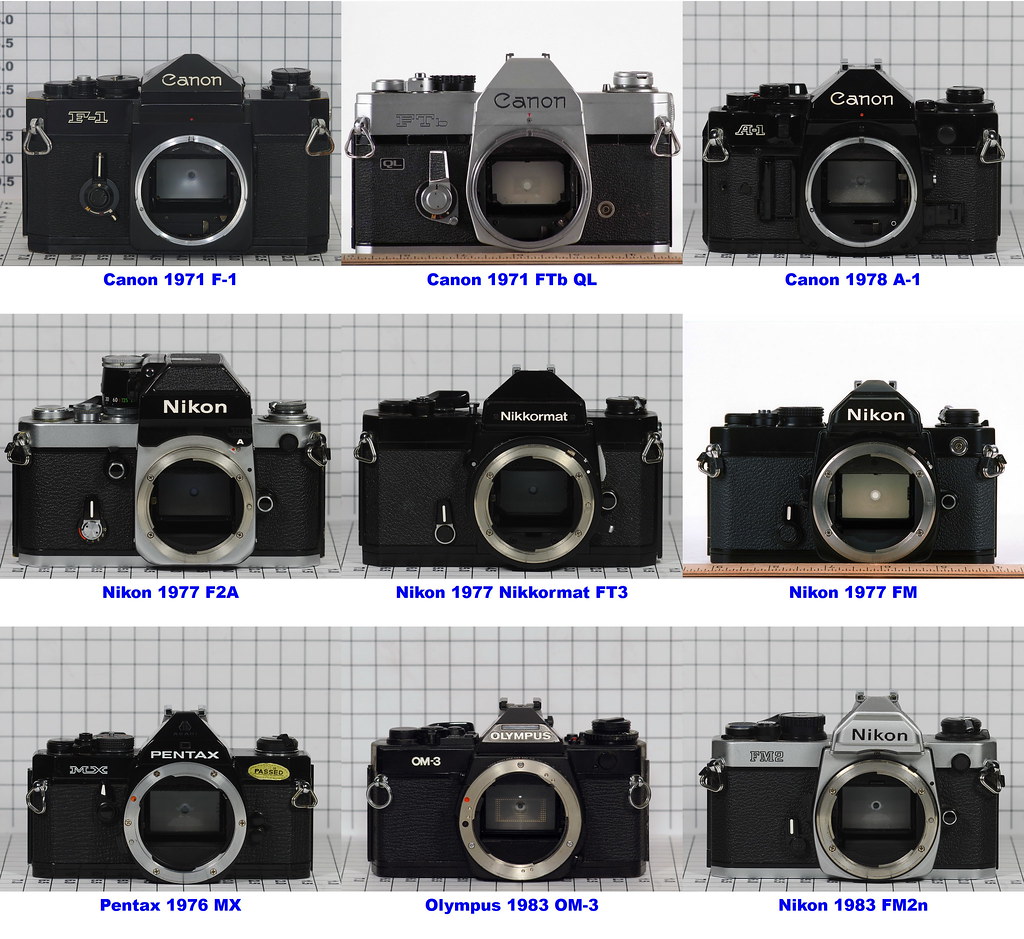

Note that the camera has a metal body. It's only the top and bottom that are plastic (plus the grip and battery door).
Inside, it's mostly metal, save for some nylon parts.
The F-1 cameras (all of them) are much better made than the A-series cameras (all of them), and yes, they're on a different class altogether.

But you know, X700 is as solid as one could hope. The A-1, first thing that I disliked, was battery door/grip not staying solidly in place, sort of having some small but detectable play, it was off putting. I don't remember if I managed to get passed it. But I sold it as soon as I managed.
