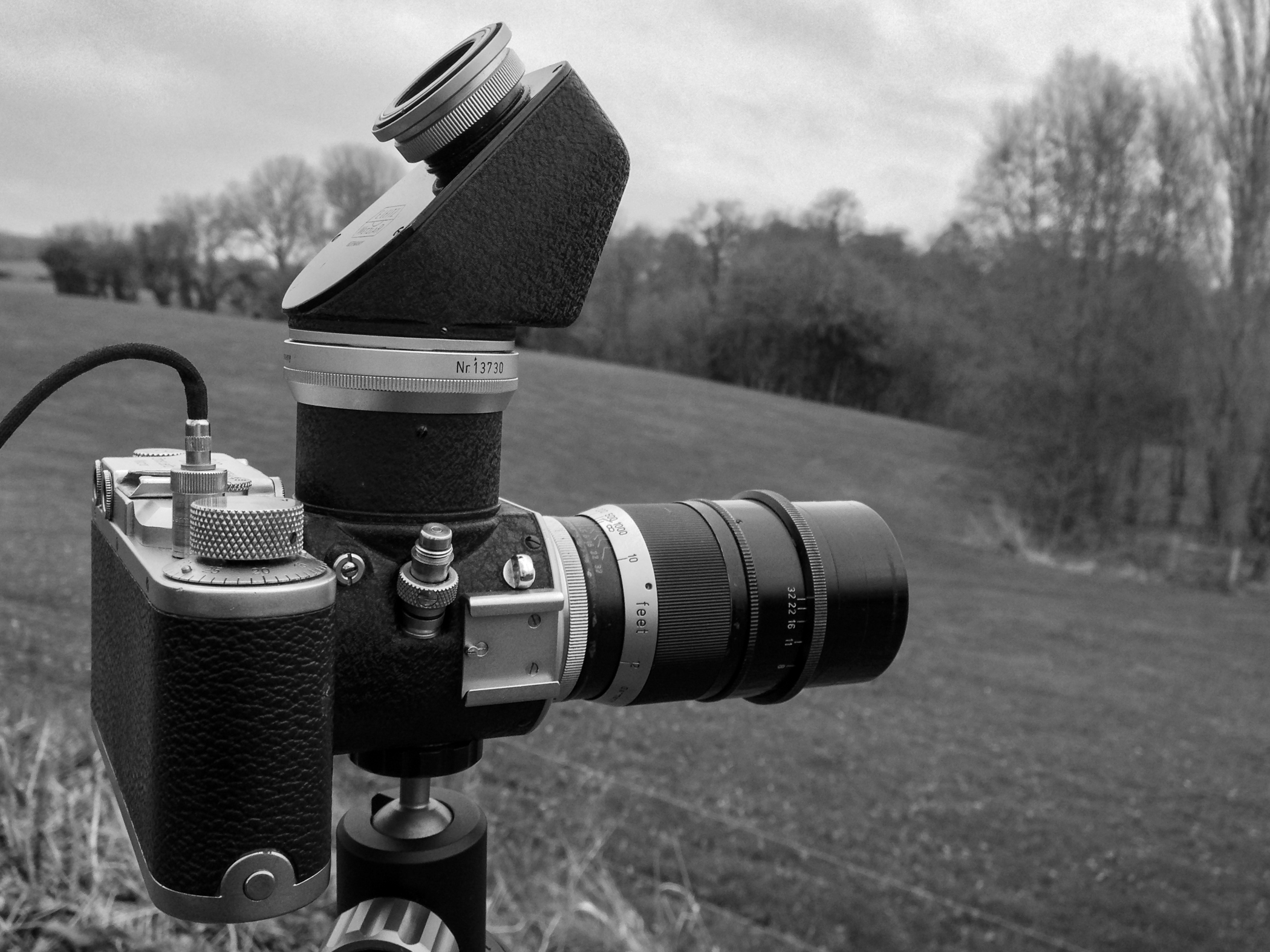

I'll stick with my 1937 Leica IID, Visoflex I
and Telyt 200mm... I don't really need anything quicker for landscape shots and I was out shooting with it today. Actually, I really like the ground glass focusing on the Visoflex :smile:
Craig
Apr 8, 2004
2,522
Calgary
I have one of those as well, fits on a IIIc., but it's still a bit clumsy to use compared to a true SLR.
vickersdc
Jan 8, 2007
454
Somerset, UK.
I agree completely... compared to a true, dedicated SLR it is lacking a certain 'refinenment'. But st least this way, I get to keep my superb rangefinder camera and then, when I want, I can convert it into an SLR. Yes, it's slow, but for landscape photography that's generally not a concern.
