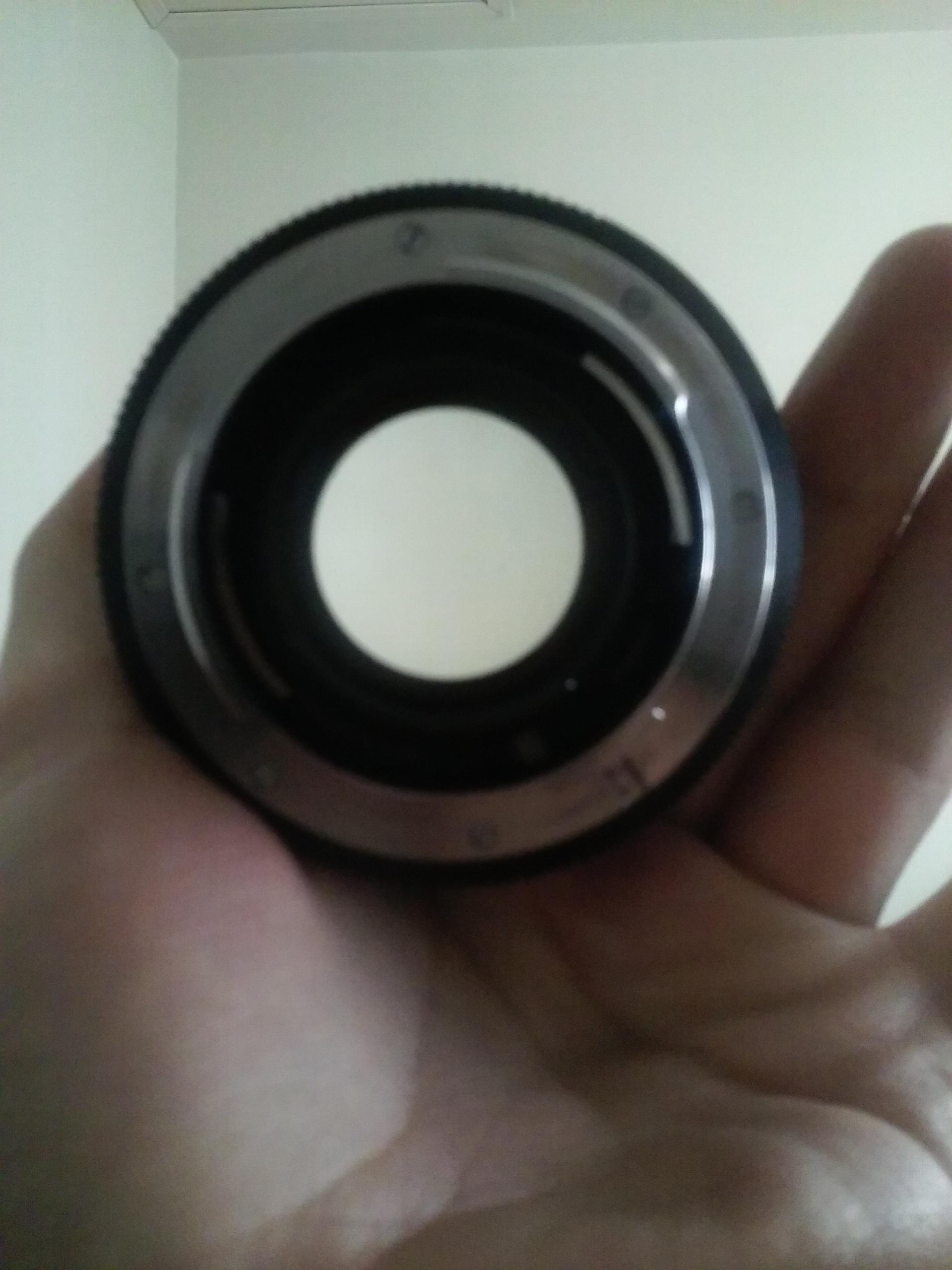

That would make more sense to me, I have always wpndered why the window above the lens couldn't reveal the entire f/stop on the LED light. I always assumed it was because it was an older lens, but I know leica camera's are made with such detail it didn't seem right. Here are some picture of the lens. If they are too poor I can send a different one.

attachment.php
2402325 leica summicron-R 1.2/35.

I did some reading and think I understand now. The lens I have is 3 cam so to get an aperture reading for the meter I would choose my f/stop and then meter for my shutter speed, then hold down the DOF lever to see what the meter says is right, release the DOF lever and adjust the aperture as indicated and then take take the picture? The manual warns against holding down the DOF lever while adjusting the exposure because it assums I am using an R cam lens, but for a 3 cam I would want to do that and hat is how I get my expsoure. I tested the settings in my dslr and it seems to add up! Thank you!
miha
Feb 15, 2007
2,963
Slovenia
With a 3 cam lens stop-down metering (using the DOF level) is not needed. Unfortunatelly form the above picture I can't say whether yout lens has all three cams.
