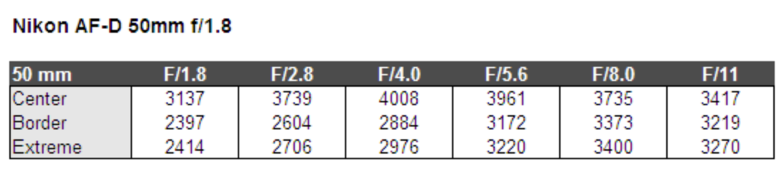

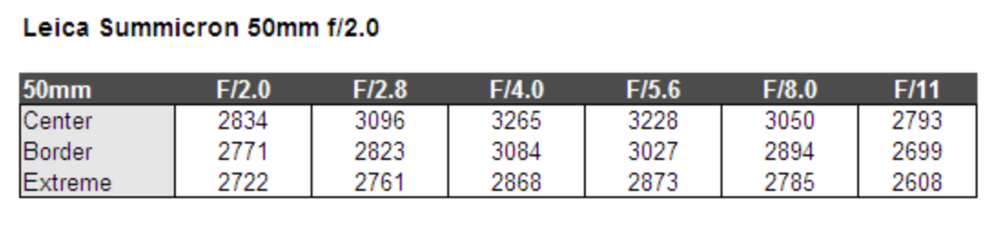

I am not the only one with that results, as the well reputed lens test source Opticallimits (former PhotoZone) had the same results:
These numbers?! The numbers where a plastic fantastic kit lens is better in the centre at f1.8 than 10x more expensive lens at f2 and absolutely destroys it at optimal aperture?
Before you jump, I know how to interpret these numbers and know Summicron is not as bad as a well reputed lens test source would lead you to believe. :smile:
I highly recommend to you to read and understand the test procedure of the Imatest test system used by Opticallimits.
Then you will understand that your comments above are wrong.
Of course the absolute numbers are different, because the test was done with different cameras and sensors. 18 MP sensor with Leica, 24 MP sensor with Nikon.
The measured data must be put into that context. Exactly that Opticallimits is doing by adding the written zones on the left of the chart (poor - fair - good - very good - excellent).
So you have to look where the bar in that bar chart is ending, in which zone. And you clearly see that the Summicron is surpassing the Nikkor in most cases, especially at the wider apertures and towards the borders.
And as explained, I have clearly seen these differences in the photos I have made.

To be fair, the 50/1.8 lenses they ( Canon/Nikon ) make are amongst the best out there. The Canon EF 50/1.8 as tested by LensRentals is one of the most tightly-toleranced and consistent lenses they ever tested.
And I highly recommend that you don't pretend I didn't write this sentence:
But it's good that finally somebody noticed that comparing tests of lens on different sensors is pointless (people here are posting lens tests on digital sensors when we have film in our cameras!). How pointless is that? There are undeniable advancements in lenses on digital sensors, but how much of that do we see in our prints? I would really like to say that I see "huge" improvements. But I sadly can't show that on my prints. I'm still hoping that maybe somebody here will finally post examples of huge differences one can observe in prints made with the latest lenses.
Btw, linear resolution of D3x is 16% higher than that of Leica M9. Nikkor 50/1.8D max. center resolution on D3x is 21% higher than Summicron's on M9, max. corner resolution is 18% higher, at f2.8 centre is 20% better and corner is 2% worse. All in all, it's pretty close with evidently better uniformity for Summicron at wider apertures (undoubtably also helped by M9's offset sensor microlenses).
Neither are lens tests on different sensors pointless (you just have to know the resolution capabilities of your sensor), nor are lens tests on digital cameras irrelevant for us film users.
Henning has posted results here on a 12 megapixel sensor. With very clearly visible differences. And he has explained that the differences are even much higher on film because of the higher film resolution.
And he is completely correct on that!! I can absolutely confirm that by my own tests over the years.
