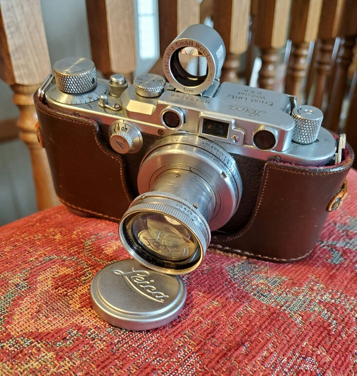

Here's a 1934 5 cm Summaron f 2. Aperture is marked f 2, 2.2, 3.2, 4.5, 6.3, 9, 12.5. Distance is in meters
Leica III (model F)

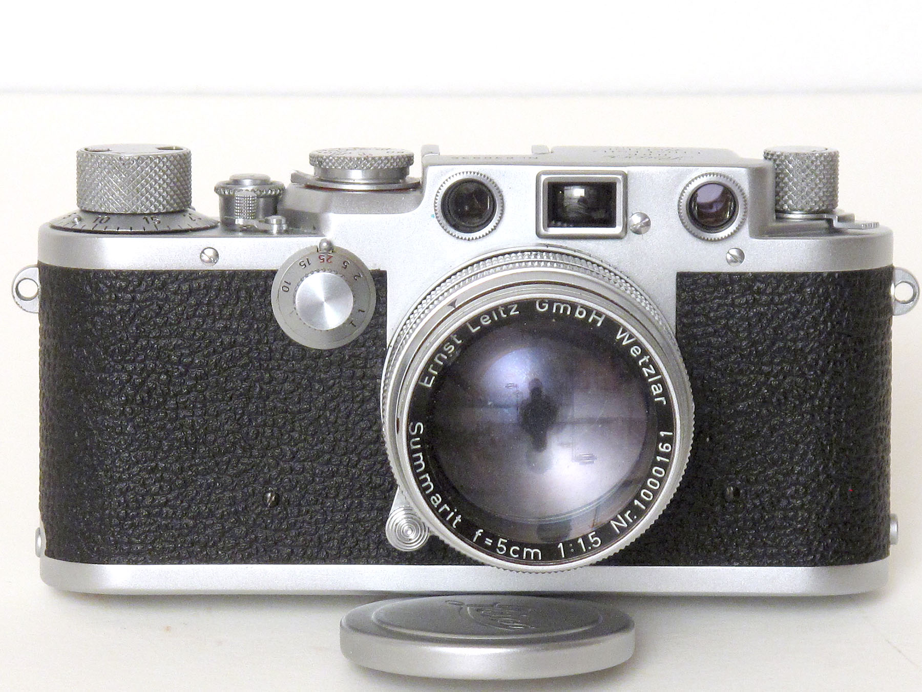

The topic started with the M6 and its various viewfinders but soon evolved as a discussion about frame lines and magnified viewfinders on all Leica cameras. Some on M6's also M3's. My 111f with the Summarit 50mm is an example of a viewfinder that provides100% of the image. No goggles no frame lines. Also I wanted to show off my 111f. which i consider one of the finest Leica's produced to date.
