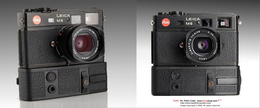

A motor winder that kicks back through the shutter button shaking the camera is about as inelegant as you can get.
imagine, you would retain all the kickback and shaking and you would add that thing on top of it all, thus a step further down.
The current design is the best that can be done. The modifications would need to be made on the M cameras, not on the winder,but that would mean the end of M cameras as we know them.
As it is, that poor winder all it is doing is working around the constrains of the M cameras.

IMO, this motor winder issue seems to be an example of Leica being boxed in by its customer base and perhaps its engineering tendencies. I've never used these cameras, but think it's a little elaborate to want electronically controlled auto exposure to be compatible with a mechanically controlled electrically driven winder, while at the same time preserving winder backward compatibility with previous mechanical cameras.
There are mechanical shutter cameras that work with an electronically controlled motor drive (I have one), but the drive interface uses an electronic contact. Leica could have designed an M7 and motor that worked together seamlessly but sacrificed motor compatibility with the previous cameras, or perhaps even designed a motor drive that used either mechanical or electronic triggering to preserve compatibility. That sounds a little Rube Goldberg, but perhaps no more so than asking two electronic devices to communicate through a mechanical connection. You'd have to ask the oracle of Wetzlar why they did it their way.
There is nothing wrong with the Leica M Motorwinder and it's kickback if you are a professional and it's all you have to keep up with the Nikon users sat next to you. It is however appalling for a dilettante who's nerves are shot by using it. This should give a clue for who this compromised half-arsed design is meant for, it works, sort of.
A 2fps motor winder is not exactly professional grade gear. And those pro Nikon winders could not only advance the film at 5fps with no recoil, but also rewind it. That Leica winder wasn't keeping up w any Nikon users.
Can I share a secret with you guys? I own 8 Leica winders. They were like 10-20$ each. And when you need a winder, they do the job. Some are really loud... but all in all they’re ok.
I read somewhere - and it was a legit Leica source but I wish I could place it - that the steel geared Leicas (M4-2/P etc) were better built to withstand the use of the winders. Apparently there were some reports of the later stuff (including M7s) that could have mechanical issues if used extensively with the winders. I'm sure there a lots of peeps out there that have been using them forever w/ no issues, but it made me pay attention. Pretty much as one more reason not to use it on my later gear.
Man, I wish I could find that source. Score one for steel vs brass gears.
Yes, the winder is tough on gears. Originally made for the M4-2/P’s steel gears. Comon Leica knowledge.
The way to use the winder is to always switch it off, never leave it on. The swotch is so well placed, though, that it becomes a partnof the shooting routine. I use it on and off constantly within a riol of film, depending where I am. I don’t mind the extra base length, it gives proper counter balance.
The newer “Motor” is not dangerous for brass gears. It has a refined sensor that makes it stop pushing when there is a counter force, when the camera is cocked.
