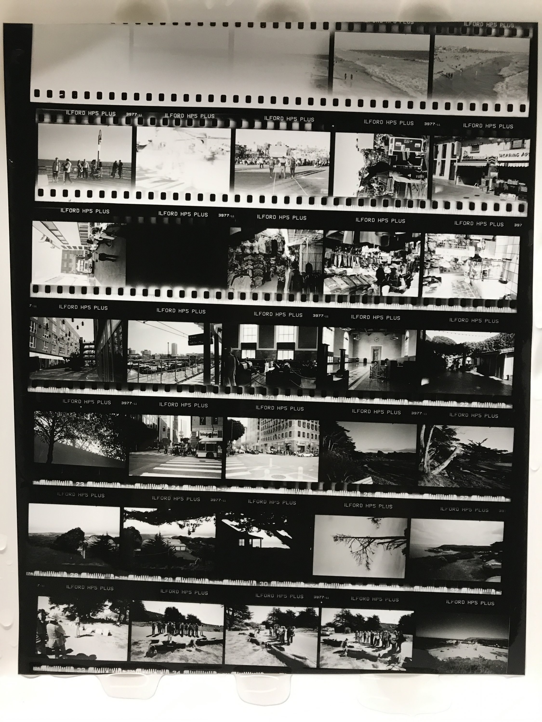

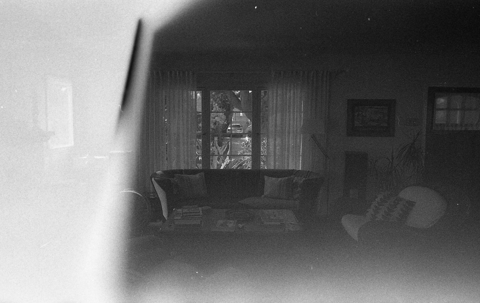

I recently purchased an M5 from KEH. First roll of film seemed OK, send and third exhibit a strange light leak. I have attached some examples (bad scans, but you can see the problem). The film is badly fogged for the first 4 frames, then the next frame is partially fogged on the left side (example 1). The entire roll is fogged along the top and bottom sprocket area and into the image as well (example 2).
I only see one light seal on the back door on the right side. Should there be more?

Developed at home or commercially? The light leak along the bottom seems to intensify at intervals that match the sprocket holes which would indicate that perhaps the fogging occurred with the film outside the camera - perhaps a leaky changing bag? Need more info....

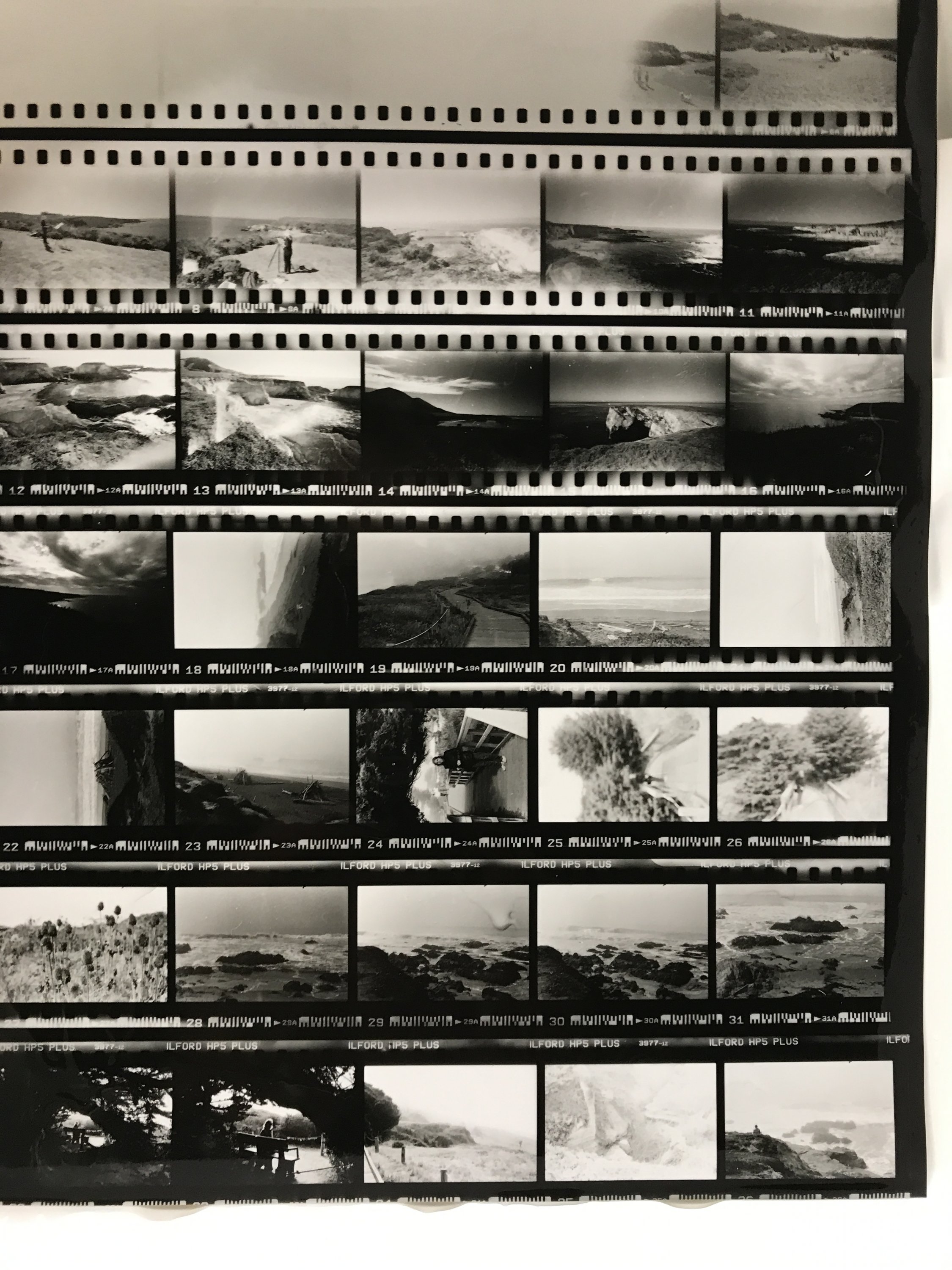

Developed at home. Both rolls at the same time. There is the same issue with both rolls. Also developed 3 rolls of 120 under the same circumstances the same day, not issues. I'm attaching a couple of quick shots of the contact sheets. The first 5 frames are totally white so I did not proof. What I don't get is why the film is severely fogged at the beginning of the roll and not at the end. As well as the edges.
Hmmm, to me it looks as though the film was loaded on a reel and the outer spiral was exposed to light causing the first frames to fog and the edges of the inner spirals were fogged as well (the innermost frames would be protected but would still be edge fogged. Second theory: they resemble a roll of 120 that wasn't wound tight and the edges get fogged after removing from camera in daylight.
Intuitively, I can't see that a camera leak would cause this kind of fogging but I could very well be wrong. The M5 has a flip-up back like my M3 and if the bottom plate were leaking light it would affect the top edge of the film much more so than the bottom (top of neg closest to bottom plate). I still think it's a leaky sleeve on the changing bag - I've had similar experiences with cheap bags that produced the kind of fogging you're seeing. I changed my film loading from doing it in daylight to using the bag in a darkroom and the problem disappeared. I would examine the sleeve elastic on the bag and see if there is a possible weakness. I mostly had problems with 400 speed film and didn't see it happening with Pan F+.

The rolls were in a 2-roll (Jobo) tank. They were loaded in the darkroom, just minutes before 3 rolls of 120 that came out fine in another Job tank. It occurred to me that there might have been a problem with the tank but the fogging is so similar on both rolls, leading me to think it is the camera. Also the major fogging is at the beginning of each roll, which would be toward the center of the reel. The HP5+ is fresh, was kept in it's canister before and after being in the camera, and transported in a cooler bag. Could there be a problem with the 35mm cartridge? I noticed the film box had changed from previous rolls I had purchased, these had a black band across the bottom of the box with the Harman name.
