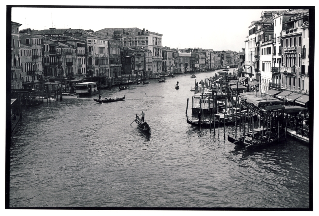

Brian -- I shot Leica RF and Nikons with a range of lenses side by side for decades, and never found any significant difference between them in image quality. The cityscape you posted is terribly unsharp for any quality camera. Leica rangefinders can get out of adjustment, but this is rather easily corrected. I've also had slightly unsharp images from the lens head of a longer Leitz lens not being perfectly seated in the focusing mount. I retired one 50mm Summicron because of scratches on the front lens surface doe to careless cleaning in the field. A Leica iiif produced images that weren't sharp along one edge due to the back getting bashed in. Nikons aren't foolproof, either.
Jim hi,
Thanks for your interest, the image posted is only 489 kb, I didnt realise how large Photrio make them when posted on the forums etc this has probably not help matters !!!.
As previously mentioned I did run a roll of film through it yesterday and had noticed straight away that there was problems with vertical focusing (the image just posted was taken around Christmas, I believe focusing was all correct at the time).
I have now adjusted the rangefinder and its now focusing correctly which is a relief, obviously the lens is taking the picture not the rangefinder and I will do another test film test as a comparison - processing/scanning both test rolls (FP4+) should be an interesting comparison !!!
The Summicron rigid 50mm F2 was sold to me as a very good "user", it is clean with a bit of dust but the glass is good, I paid about $650 for in your money last September, a mint version is currently advertised at $2,300.00 here in the UK, they are hard to get here in any condition.
I do 100% take your point and on the sharpness, I will probably get the CLA'D soon.
Thanks
Brian

It looks like that pic is out of focus, and you also mentioned you have RF alignment issues. As you had mentioned, get the CLA, then see how the pics turn out.

I can understand that Leica or rangefinder in general does not work for some people. But if you are getting anything but exceptional sharp pictures from any summicron - then either something is wrong with your camera/lens, or you are doing something very wrong.
Also resolution of jpeg does not have to be big to show if the picture is sharp or not, here are 2 examples (one from Summicron, and one from old LTM Elmar) that are 0,6 megapixel big:
