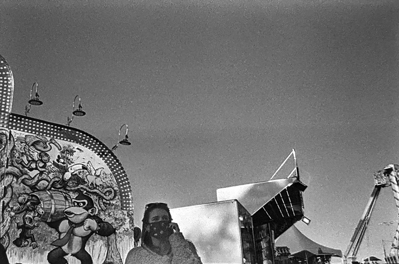

(process: M5, outdated but refrigerated Neopan 1600, Rodinal, scanned from the neg with my phone. The gate looks to have been pretty flat)
