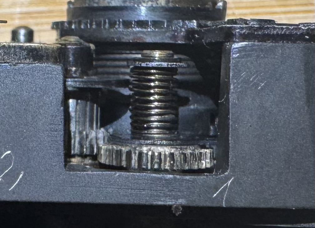

Hi,
I got a great deal on an M2. Cleaned and lubricated the slow speeds.
Tried to do the same for the winder “which winds hard” but without success. Unless I don’t know exactly where to do it.
When I look on the inside it looks like a sticky substance has leaked inside. I don’t know if it is dried lubricants.
Gears look fine.
Any tips will be appreciated.
I don’t really want to spend money to send to CLA. Not this year

So I cleaned everything I could see is related to the wind. No change.
The one thing that I could not see where it came is this.
This gear seams worn out.
It appears to be mis-aligned with its neighbor...maybe a spacer/washer is missing from underneath the worn gear?
Perhaps the "hard to advance" issue is from that gear rubbing on the bottom edge?
* I am not a camera repair person, nor do I play one on TV.
I lifted that gear and winded. No difference.
When this is lifted and wound, you loose sync between take up sprocket wheel and winding lever. There is a specific jig to align this.
Winding force depends on several things.
Lubricant in the assemble bellow winding lever.
Lubricant in this gear and sprocket wheel bearings.
Lubricant in and around the gear on the bottom side of the sprocket wheel.
Most common case is the shutter curtains were adjusted to move too fast hence the resistance in winding.
In some cases it's the combination of all of these. How to sync all of these is described in the service manual. All illustrations and clearances are there.
Travel speed of the curtains should be in the range from 12.7-14.2 ms (I try to stay within these specs as that will make camera work properly and wind easily).
If it's taken apart, sprocket wheel, winding mechanism bellow lever, take-up reel notch, main shutter drum, stop for the winding drum all need to be synced to work together.
Cause for need to speed up the shutter curtains in order to get reasonable shutter speeds is most of the time dried grease in the spring drums (smaller ones on the right side when looking from the front).
Main drum lubrication and clearances can be an issue.
Difference between standard CLA offered is that camera is serviced and returned back to specs.
Leica service and complete CLA are several times more and camera is basically stripped down to the last screw, everything is cleaned and then assembled, synced, aligned and properly lubricated.
When done this way, it keeps adjustments for a long time.
There's a long list of what needs to be in place and check out for Leica to work within factory specifications.
