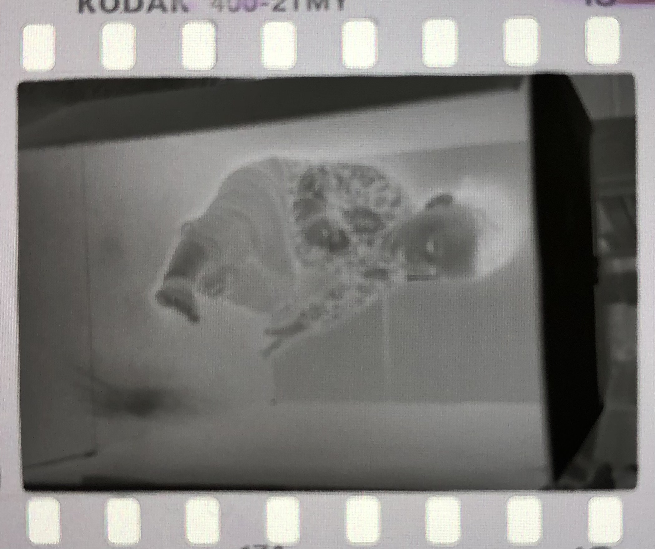

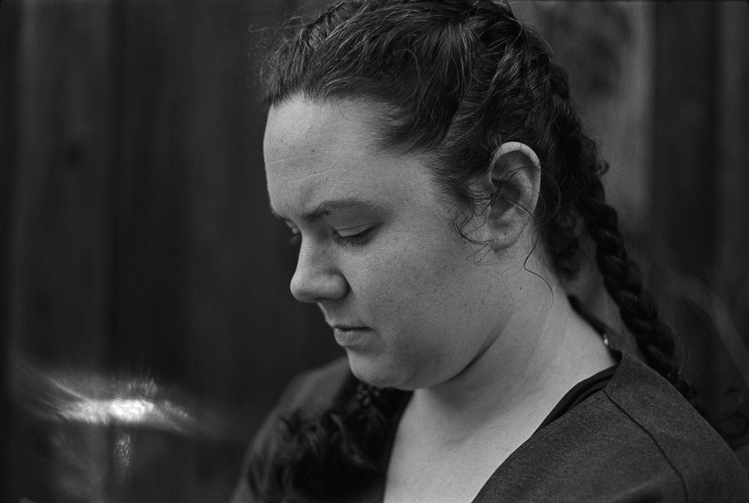

I'm wondering if anyone here who owns an M-A has found these light leaks as well. I got one leak in the most recent roll, and some 4-5 in the third-to-last roll, all in the same general area - lower left of the negative.
I do know about the light leaks on the M5, and these look a bit similar. I thought that issue was specific to the M5?

Hmm, that almost looks like a hole burnt in to the shutter. Which can happen on any M film camera.

Is the light leak the same on all images?
It might not show anything in these two positions.
If it's half wound, metal edges of both shutter curtains will be in the middle of the frame. Very often when shutter curtain fails, failure is located next to the crimped metal edge.
On the other hand, if it was a hole in the shutter, I would expect more effect across the frame. It would be either well defined if very small or travelling smear if it travelled the whole way.

What does the negative look like?
One can clearly see it on the negative, so it’s not a scanning artifact.
Correct. Lower left on the frames it’s appeared on.
But how does it appear on the negative, and does it extend outside the frame?

Remember the lens flips things over so look at the top right corner for the light leak or shutter hole.

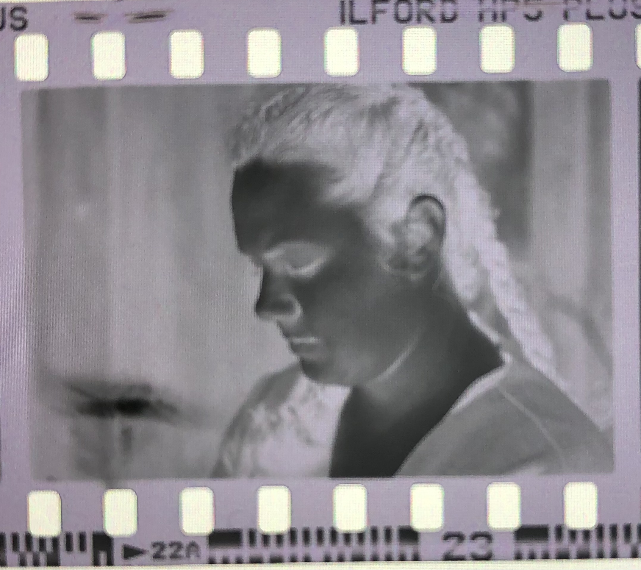

Please see two example negatives. One of them is from a different roll.
Indeed I did take this into account.

The mark of the light leak is the same on both negatives.
Does it appear on unexposed frames at the start of the roll?
Light leak is in the same general spot but start of the leak is around half sprocket width different. Intensity and shape seems slightly different.
Characteristic of very small pinhole light leaks is that it will be very weak if time between shots is short and if more time passes between shots light leak will be stronger.
Light leak on second attached image is much more pronounced.
From my many light leak investigations, I found more than few leaks that couldn't be easily found with a flashlight test in a darkroom.
To gain little bit more sensitivity, eyes can be closed in a darkroom and one eye is brought close to the lens opening and basically left in the dark.
You can use black foam or cloth around lens mount to isolate eye from any stray light and then shine the flashlight from the back.
Other way. More sensitive. Is to use a digital camera from the mount side and again use black foam or cloth to prevent light from getting in between the digital camera lens and shutter curtains and shine from the back side.
Long exposure on high ISO should show if there are any light leaks on curtains or not. This can be tested in wound, half wound and tripped positions as well.

I see the leak extending down into a sprocket hole, which complicate the matter somewhat.

As MattKing noted second image of negative shows light leak going into rebate section. It could still be leak through the shutter but light leaks can be quite unpredictable and hard to diagnose.
I dealt with many light leaks that couldn't be seen in normal way. Different intensity, location and shape of the leak on two images is also adding complexity.
Method of elimination is always the best. Eliminating possibilities one by one at a time. In this case it would eliminate any leaks through body and leave shutter.
Other thing that is very helpful is using few frames at a time and doing quick development in tank pulling film out and cutting. That way one roll and few hours will troubleshoot the most stubborn light leaks.
A couple of shots with body cap on will eliminate shutter. Exposing body to strobes from different angles will show leaks more easily.
My personal method in this case would be digital camera on high ISO and long exposure combined with strobe from different directions. That would save lots of time.
Checking through lens mount would resolve that side. The easies way with film is to use darkroom changing bag for testing. Elastic sleeve can be put around lens and only light is coming through the lens.
If this produces light leak, than it must be through the shutter.
So far, in my opinion, I don't think any causes are completely excluded.
