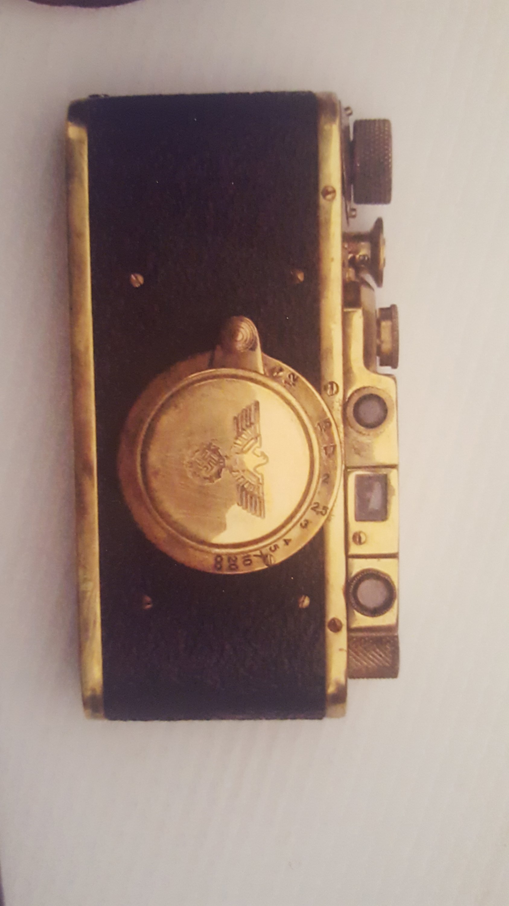

A blind man with leather glasses could tell that's a fake.

I know nothing about vintage Leicas but I ask myself what sort of military organization would commission and issue gold plated cameras, certainly not the WW11 German air ministry in 1941, and also because any equipment authorized by them had to be engraved with an F.L. contract number https://www.cameraquest.com/luft.htm

This is the first time I see the Leica actually listed as aerial-reconnaissance camera.
If that is how that listing is to be interpreted.
There is no trace of such in any aerial-reconnaissance literature I know. So far to me that only was a story told by Leicaphiles.
And I still have my doubts.
Any more hints to the contrary are welcome though.

It is easy to fake these cameras because what makes them special can be easily added to regular Leicas by adding engraving or paint. AFAIK all authentic Luftwaffe cameras were painted gray and never had plating. Using gold is really unheard of. Reflections from the camera metal were considered too dangerous in warfare. As reported in either Popular Photography or Modern photography it was routine for the US to destroy all Leicas and Nikons just after the war's end. This was done this by driving a large screw driver through the lens into the camera. The article contained a photo of this being done with a pile "modified" cameras in the background. So any surviving cameras would be quit valuable making them desirable to fake. At one time there was quite a thriving cottage industry doing this.
Gerald C Koch
Jul 12, 2010
8,129
Southern USA
What makes these cameras special is their provenance. Mechanically they were the same as any camera picked off the assembly line.

Thanks for your replies! I will check out the websites. The information I have seen online is that all the gold ones are fakes. The person selling this indicated it belonged to a prominent Nazi.
Of course it is a fake:
-) Why would an armed forces have a camera guilded?
-) Why would a prominent Nazi have a camera guilded that bears state-ownership marks?
(You then could argue with some ifs and whens. But that then would apply to any weirdo camera with the appropriate weirdo story. But buyers like weirdo stories.)

This is a genuine one https://www.cameraquest.com/luft.htm, no gold plating eagles or swastickers just the German air ministry Fl contract number 38079, and Luftwaffen Eigentun ( airforce property) engraved on the back. One of the reasons these cameras are so rare is they were issued to some aircrew member usually the observer before missions and had to be given back to the stores on their return.
