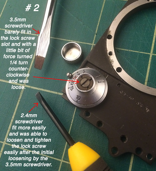

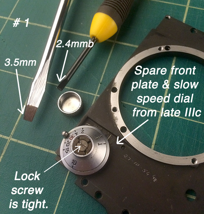

Ok here's where I'm at with the screw extraction effort. Just got my spare part and tools this past week.
The spare part looked very nice and better than the eBay photo! I love the date someone at the factory etched into the front plate!
The 3.5mm screwdriver barely fit into the lock screw slot but it worked. Took a little hand pressure effort but it came loose easily.
Once loose it was easier to use the 2.4mm screwdriver to keep loosening and re-tightening the screw. The 2.4mm fit much easier and there was less of a chance of slipping. Now I know how my lock screw should work and how much effort it should take to loosen or tighten it.

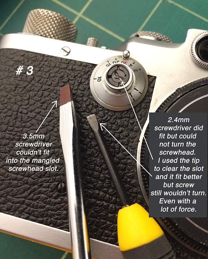

In my IIIf camera, I couldn't fit the 3.5mm screwdriver. The mangled screwhead slot wouldn't allow it to settle in. I was ablle to clear the slot slightly with the 2.4mm screwdriver tip and get the 2.4mm tip to settle in but it wouldn't turn. I put a good amount of pressure on it but it wouldn't turn. I placed a drop of WD40 with the tip of a tweezer on the screw head and will wait a day or two and try again. I'm tempted to take the slow speed dial and front plate out of the camera to be able to really lean into it. Let's see how it goes. Something is definitely odd about how frozen this screw is. Hmm...
