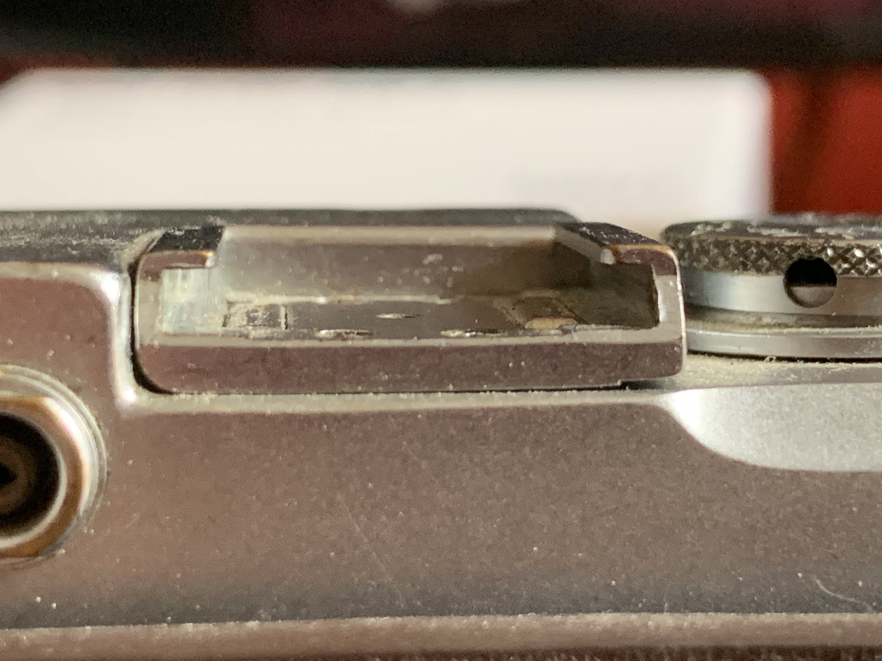

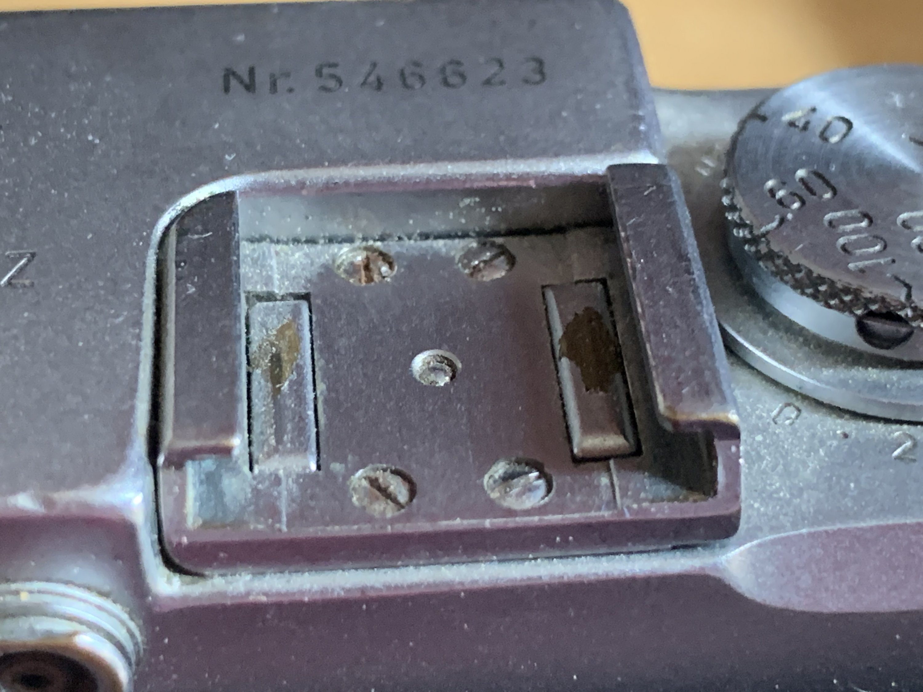

I’ve had my Leica IIIf for awhile and I want to use it with a 35mm Summaron lens. Haven’t been able to so far because any VF (or flash) I put in the accessory shoe just falls out when I tilt the camera. The shoe itself is a bit worn, but I don’t why it isn’t holding anything in place. Any ideas on what I should do? I could use some electrical tape, but that looks rather tacky on such a nice camera.

As you suspected the shoe is worn. Consider putting on a thin piece of plastic on the underside of the flanges or on the two worn pads. See if the two pads have springs that can have padding added underneath.
Take it off and do a wee bit of bending on either it or the 2 springs, as you study it to formulate your needed course of action . It would't take much. No big deal.

I simply insert a thin piece of paper along with the finder to keep it in place whenever I use it. Haven’t lost a finder yet. Even use 50mm finder on sm cameras unless going ultra compact. Leitz accessory bracket never as refined as the Zeiss when these cameras were new, but then Leicas were a lot less expensive than Contaxes.
Removing bracket to adjust seems to be a bit of overkill.

+1 I've used thin plastic shims as well.
Getting/making perfectly fitting screwdrivers is the first endeavour of the budding camera repairer...
Exactly.
And in this instance realising that there is a spring missing or damaged in the shoe will help too.
