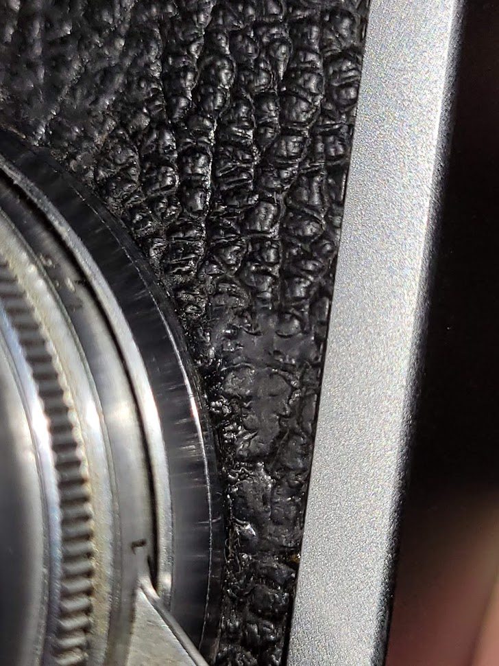

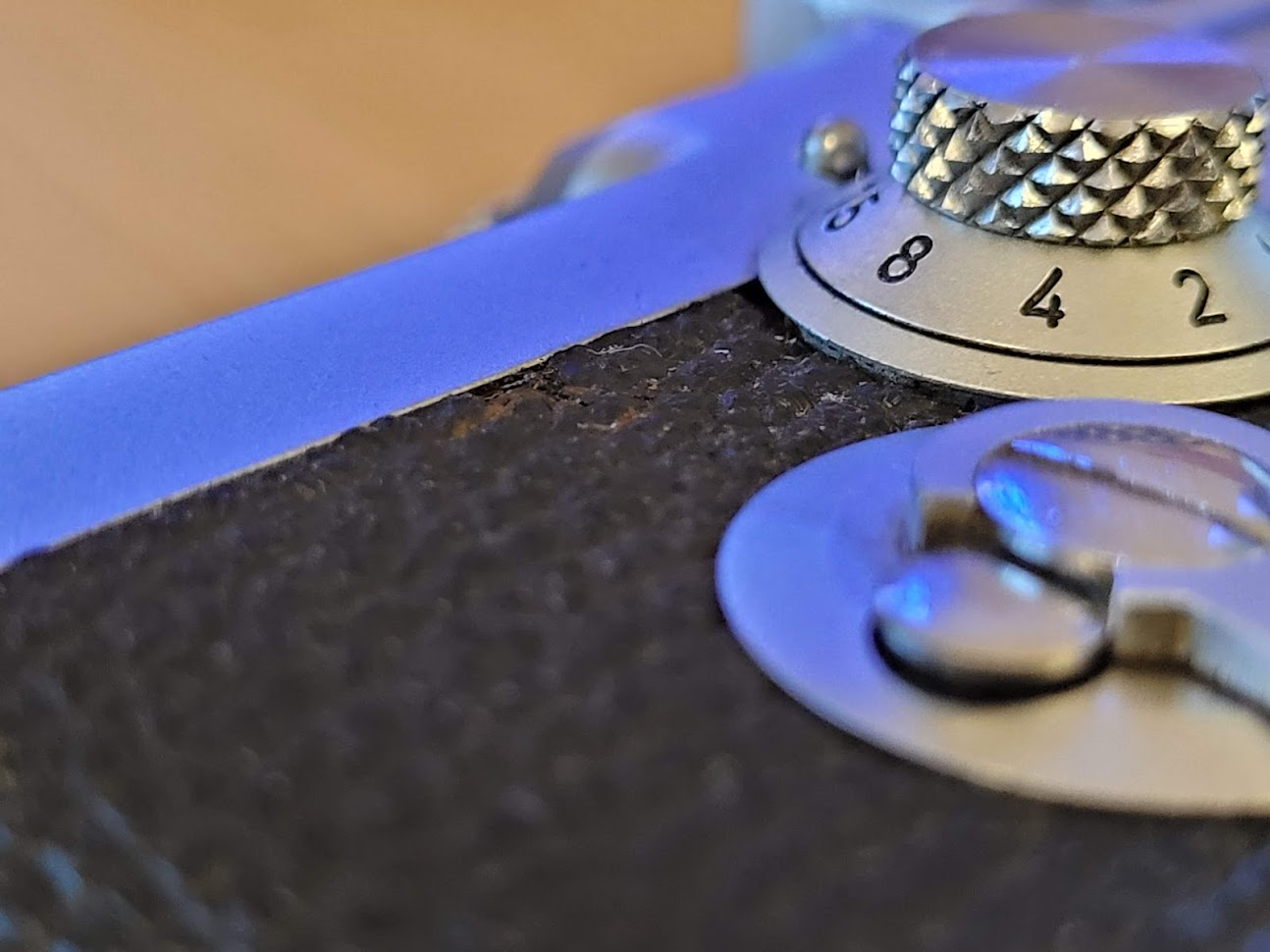

I've got the same leak in my iiiG although not quite as pronounced as this. I havent had a chance to properly investigate but my initial investigation showed a tiny piece of vulcanite missing near the slow speed dial. When exposed to direct light it casted a little light into the take up spool region of the camera, which matches the marks seen on the film. i.e the spool clip. What is the condition of your vulcanite? Maybe open up the bottom plate and shine a torch around the camera to see if you can localise the region which is causing the issue. Would love to see where yours is as it gives me somewhere else to check on mine
I tried again to do it insisting on the low speed dial but haven't succeed to see anything inside. Even tried to move thing and press on them but nothing conclusive... Sometime it's bit hard because I think I see some light but trying to localize it I find in comes from the open plate...
Vulcanite is not in great shape, has small cracks and crumble a little but I wasn't thinking to replace it because it was only aesthetic for me and only small things. I bought this IIIg to use it and not be afraid to scratch it.

Here are the defect I can see on the vulcanite:

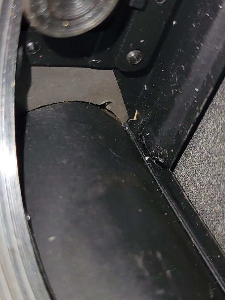

There are some light baffles in the camera that could be out of place or missing from a past CLA or someone tinkering with it. Look at the 5th drawing on the web site below, those are the baffles I’m talking about. The one to the left of the lens could possibly cause the leak if it’s out of place.
http://rick_oleson.tripod.com/index-154.html
Wo very interesting, thanks @BAC1967 !
To my eye they seem to their place but as I don't know how they should be positioned hard to say what is normal or not. At least they don't move.

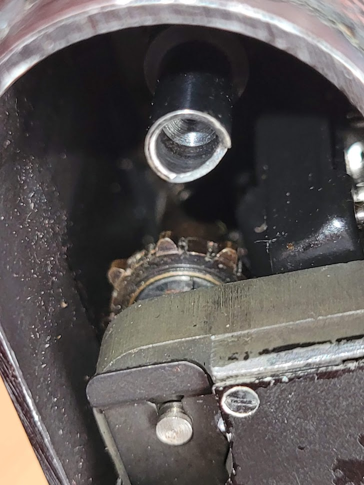

In the meantime I tried a little reconstitution to try to understand where that could come from.
So on the 2 positions possible, the first one:
hkj6UL9Ooyc2_3v3lBGHYPgPbVd7_Bf3mfGevdy0k8pxmnTB-nl-Z_sCitAr0y5kSzA_I5PQNkEmiEY72Mk72OlatGYAu4mkmI76fbpnTbTZKuSJvbAtn8_kBgd4ncCvV_1LQBKB2vUi8leMjDse3wNzEA2p68Xz4ExLOZilOuCOgDDAWERZO8cUiNiaWPXVP0dXeCTzFohpEHX_K6FPpQQy2LKdG52rEUSDsIBl9WI1i8TZKYjGw7mdfZ6FP1XJSnrSXh0PHTvKpOi6rwXJ__z9dSoEI4h7kBF62dgSA7WEaaaw6-pHBJHAIatPMHnmfF9kDDZbRiNqfXxkwlCFYI658eynQIYSjPD6kFK58OceFdwCklPElu29Hx2R8zr_rLxmVtFrs3hTVG99uRMRKc6zaPkXD7sxXyVV72JsVENRrBY-qSy86xY1RdYKqwjIVQ4vuKKSTTbP0pBCbnUtbyjMtNuxdlPNmr1fpxKS0pt-t5aEHirT7vCFlOMKyFshBKXvUSiEt5LozV5TdW6UuNra6w281AX_vUgz5VKRTguYIuRQzl1BbpGmxdrsIENiWk7M4WZChpa50nAs5F8QIrTB8WF-Xi73DBQt0wSVc1ow6XuoyPva7MvcPpK5S0mLqZHX17giiB1L8btb7tToD-OoVI7kV3frz3e45mAhO2Y_op8iDy1pAwVjXcdTkJJSxM1aBszaYHu0j6-hJFMmsYun=w1294-h970-no
I don't believe this is where it happens, because it could mean the light leak propagate inside, outside and on the window of the frame.
Next position when advancing film:
lNo_-x84x--jBjecYYM-w22u-ChfbcPHOoX1F-g_6OfFaoJBSQnu2jvTgGO4C83qU3S2V9b-uZl_ThQirNNwxYzW9r0bJYqpiw6ZxU-u797OZVUuDjlDgBf1OX2IlZwg5FEq_LQldsdDOEYt4GPULl1EPUSJydPz3P8BNLAQ7_O1BsM7VCxl31QtIXlysAEQ-eGL9Ash5QhmnTmDRlgay2Twx3BWtPNmQWsYBC2ubAkpJ_1qzpt2Bs7N_wG6LftnhkME2yMZChLiAhnB4GWFn2P6uggTrDuQjIkc_gZGxZnHxvqYGcwD8aM5EzYrtikXAqb16YUjQ4LEydeqVl5e1k-2Ys5F8Cu-4gfvuWRZHgj_Az4QW9MHBeEyLKEo0RcJ5dfm9iairDWEmMzkV0Jm9_2Qyy6leCThGKIofzw-2th0FuTkW0y0bbOskVReOOxkrB-qP-fDJ9fyn8M8QiWfxTH35VOyo2yAYL_-o9iSjEtj9Ya0fd_27JiRlRK62-KEb2X-d13hxvjejOB5RYbqKZJ6do3Oocs1vzZ7yIKp8dk5u0UlV7QZOoxtcrOn1D1xDUIfdgEsmZFY6SQGez3cz0C_xyOLlp8GZSbTC13T0PIL9b-01VAoZpmg-j1_2WncvFJE9eMnmbVdm1OH03UQ9i-hx40iKEizgQonFy0TaeSYd3gv0nFLCWVyAxoo3fOjMBxzJaSUhSo9YeiLPjZU_APj=w1294-h970-no
5LrK1VNEQDBezJrTtelK7dQNVKRBnkaspqIEaMsqSCkFLk21kMpirdeBdwhIY9mBRoVfmg1cmmXDyKoWmzYjZaSmHdorHf7G_KK7cLAwZqK4DGj1fg_Jh6vyZ9pAgpSW6taugLZRs0xMD4SH4IbBA1KllyzXyVks1yjsgn28il5HNQFR_ik9ZNRuRCHIk6KogZ23Z4Nm_3l23vwKqD863wyi-JBL1o3Yt8E6i2WulaZyfgLnEGnh39nC3knLbUjCpulQKDdkWHMlGV0MDOLDvvGxRy6lfS7i_4wnSqFIT2wmrpr9UbAtcjdZqnJlc9iyj1JQdzzDkalhBF6Z7QbXS8lGnDk82Det2xsL6c-Clg0_95AwV6X4ep-oqXJvDk82V3E7ty8pibjQ6vBKCbjDDFflYyTXgVEN1TW_SvEzTMrPlS38Uy0DkrR3CV_YLqyZu3oVhr1bzCoItZafuRoROT9cPAui3xrTKBPtcNbtl0AagG_T9liGQIEs286qqsnOVzSxPLjoA8b5TxWzGIBuNrrsB5W2iKN4lRNQ85NqXE9hHDTx-qIZWl55nz7R2QawrStoICciBVL_U9ZLJIh3S7IFKH007wnukc9Zc2cRIoIdir494r8Jlm9LXBijO40Q64elV0pAd-g8QZve6KQ8aXUxzHBtSuQRlpOxLOo44aHLSjc-sqgAY-RERgVzDQnAJVt5v7GVLGuRUip2dOLfqXYs=w1294-h970-no
With the consideration that at this place where I have the diagonal light leak on my photo is exactly the place the film is crossing the camera from the back to the front.
Which after a lot of tries to get this picture would give that as an alignment:
ILiKyjMYrUdrzmEobsPEJInCdcZNUSMHKZRvB2ba3n0dNQDOyf8SBHnBSfqSGW4BHAQfTlL4dJZ-qui3h4-9HGR7pc7VKA5c6lr5QO9kEgnT_w-f4ceHZ-gMBx08CBz7CIbob8ODMeNWCroLPyKYoZp6652faHsXh3cbf_N5jKgukJplSm65Dz2RVZHhhaUdSC2Sh8oC-cRST0V2QEggeF17wN4zwT0C5HJd6s1HGN9dBXcSFyD3ev96jockEIXbtvVf7pCC1UM73ucUfE1OVrARfyMGvHgdX3d8Fg5vdhNHY-tavbFQSDPAjG2goJ9xvrfepdXkZpIHu08tucPhIXimUKFsFiO1TMorkXA1nvIXUAoVeQu52y3wVCqW1l7WMonah8LgpKs-eMhb73Vn1m97AWILB_JbXI4YZ1HhwN1CdwuUg1L31i6Ji2-YJIB1Ac5fXMXcDl5MOq4_YCGdEOZT1HNdogNc7x2vbAiVWO3uSwSTUZnB4HgHGB97vrIyWWuOKLrR28V-qCttndx8zfdBFEiUPMfqGkUnSB7Php_6TKgU-INH7xCV-dhF-2gsFDjucZnuNE3q2UuqQ2fyZUgqv27d-KnnEl9nCFvHiiVjkLOCHx1CQqKbnvHWQCsl5ZN2clj6OGs1D7XtVA2uPnaMOk0PWFqO5HRVF_hyRUJXRzORmciBoMwfSfZCJwfGcoAefQuJxtelX1TTAx4-_3HY=w728-h970-no
Wouldn't this diagonal light leak be casted in shape by the shadow of this?

Well after another look, it appears the curvature of the take up spool clip doesnt actually match the curve of the light leak so there goes my initial theory. Also I did try my torch test again and typically, the missing vulcanite around the slow speed dial does not appear to leak light now. I did spot a leak however as indicated in this photo but still not confident that this area is the reason... As for your suggestion, I cant say for sure but Im glad to see someone is trying to get to the bottom of this. I await other Leica experts to weigh in with their suggestions.iiig leak.JPG
