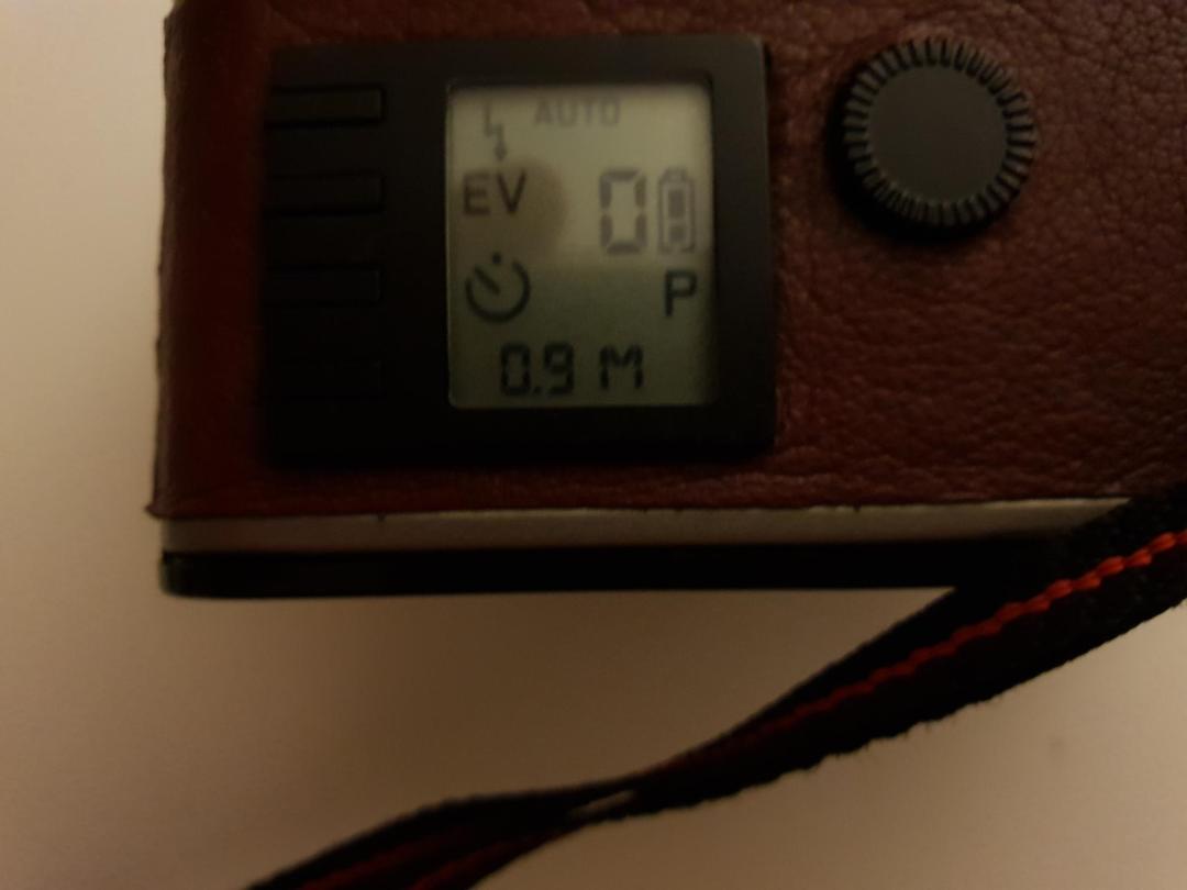

I purchased camera as broken, but it looks like it works just fine (it has plastic bottom, not original, but all works fine on dry test). Still need to test it with film, then I will sell it. I don't see many of those anywhere, so it would be interesting for me to hear if some of APUGers used one of those?

Just developed 2 test negatives: it works fine, and negatives are looking sharp, with nice contrast, and well exposed. Will post later some examples.
I know that other cheaper P&S can also give same picture quality - but this camera is really joy to use, with manual focus presetting - nice and quiet on the street... damn, now I don't want to sell it :smile:.
