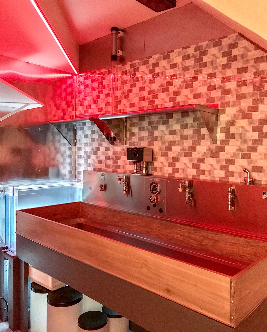

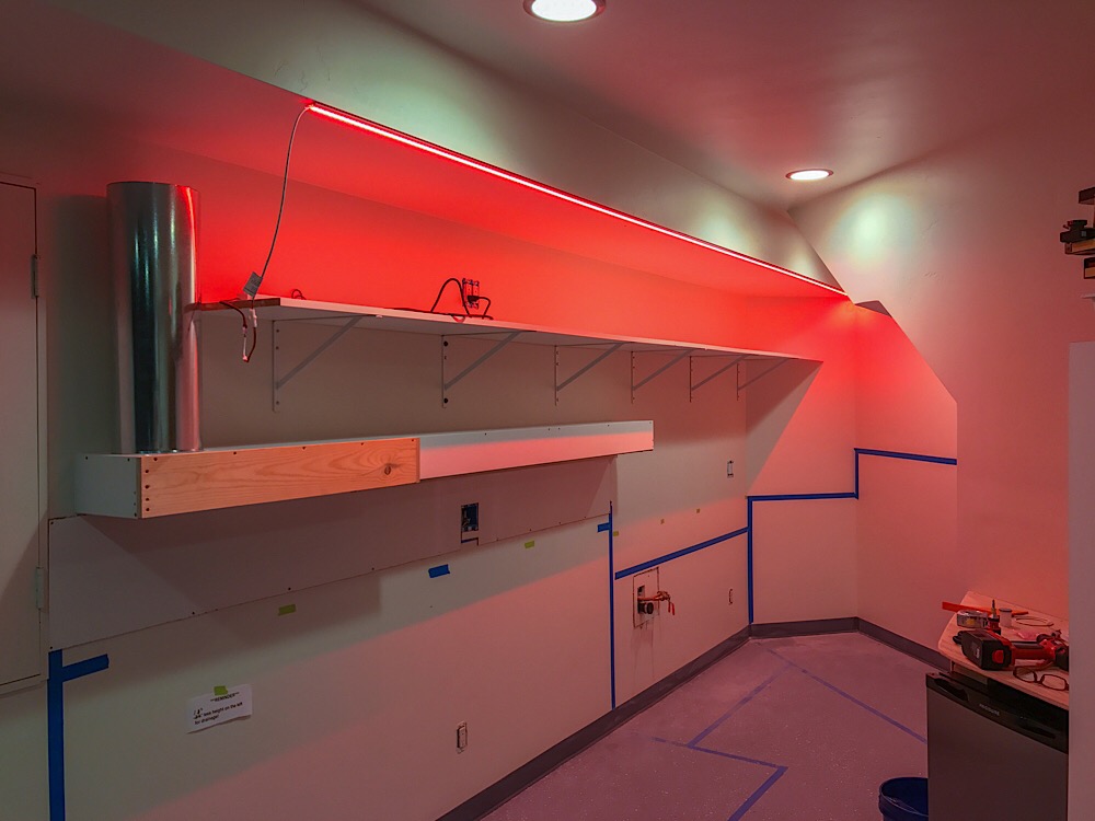

I have decided to just to do the LED on the wet side for now since that is what I am working on for a couple months. I have a Nova LED safelight set I had been using in my other darkroom that I will use on one enlarger and will figure out the other two later this year when I get to dry side work on my build.
So I put in an order for a 16.4' foot strip of red led, dimmer, power supply and moulding with frosted lens. I plan to add rubylith tape onto it. That will take care of the main stretch of sink, the other 9' feet of sink will be print washer and film development territory so my standard safelights ought to be fine there.
Ai Print
May 28, 2015
1,315
Colorado
Got the 16' foot red LED in, looks really clean and *very* red, was a breeze to install. I am able to dim it down quite a bit but won't know if I need or want to use rubylith or not until I run a test.
All in all a lot cleaner than a few Premier safelights with cords hanging everywhere. The lower shelf is actually my chemical fume extraction duct, the length of the 9' foot sink.
