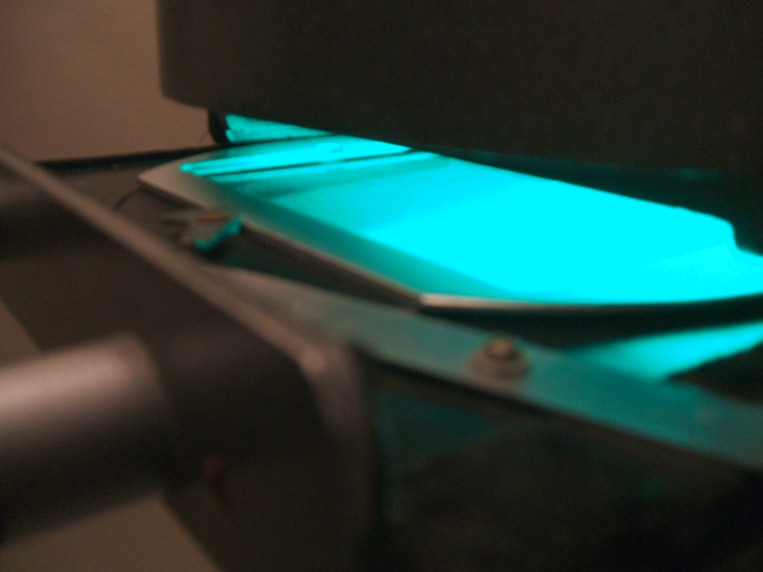

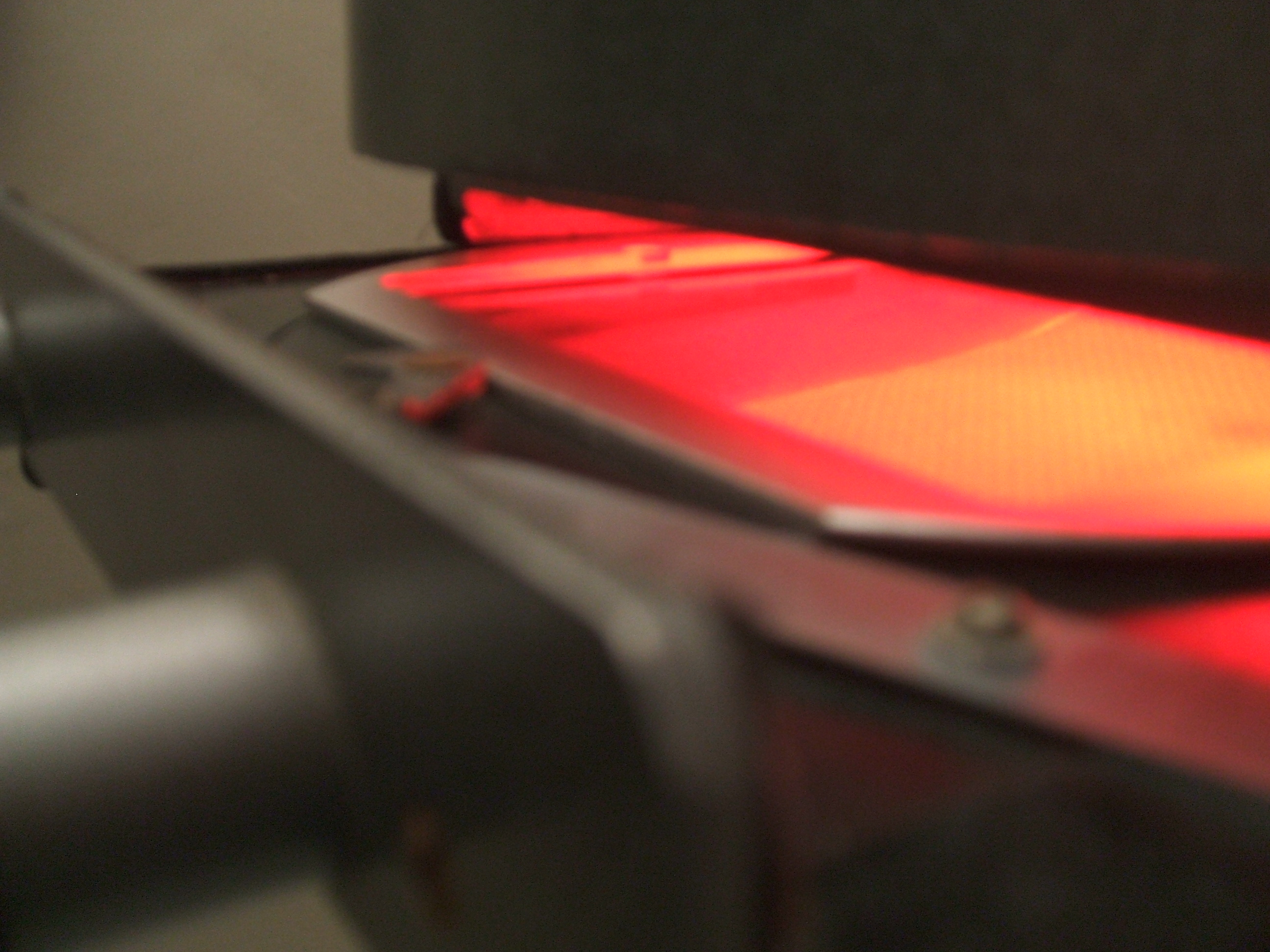

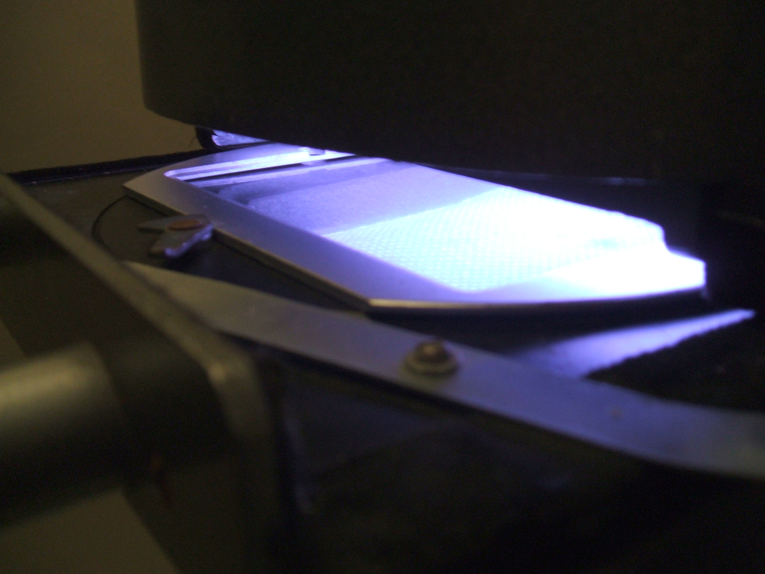

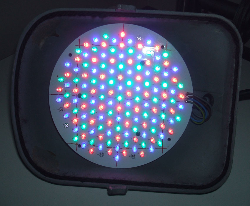

Here are the pictures I have made so far:
Steve.

Well done, Steve!
So you balance contrast by altering how many green and how many blue diodes are illuminated?
It's great to be able to focus with green light also, because that's the color our eyes are the most sensitive to.
Forgive my ignorance, but what are the red LEDs for?
Thanks,
- Thomas

It that a 74AC14 Hex Schmitt-Trigger Inverter? Do each LED have a separate circuit or can they be group in Red, Green, Blue etc.?
If the light is right then control is the problem to be solved. Thanks for the photos Steve.

(re: red LEDs)
They could be used as a safelight for aligning paper etc, like enlargers which have a red filter which can be put beneath the lens...
I'm not the one who designed and built it, but if they're the right color (and if the blue and green LEDs are the right color), the whole setup could be used for color printing, too. This would be conceptually very similar to a Philips Tri-One enlarger, which uses halogen bulbs behind red, green, and blue filters to provide light for VC B&W and color printing. I've got one of the Philips machines and it works quite well.
How safe are they Steve? (and where can these be had inexpensively :tongue: )
I don't know about the LEDs that Steve used, but I've got a red LED safelight above my darkroom's wet side. It's bright, compared to other safelights I've used, and safe out to at least several minutes. (I don't recall the limits of my tests, but it was probably at least five minutes.) Of course, the intensity may be less than what would be projected by a red LED light source in an enlarger....
The contrast is balanced by the relative times the blue and green LEDs are on. It has red LEDs because it uses the PCB from an LED stage light. The red is useful for checking the easel alignment or for working out where to dodge or burn a bit like the red filter on some standard enlargers.
