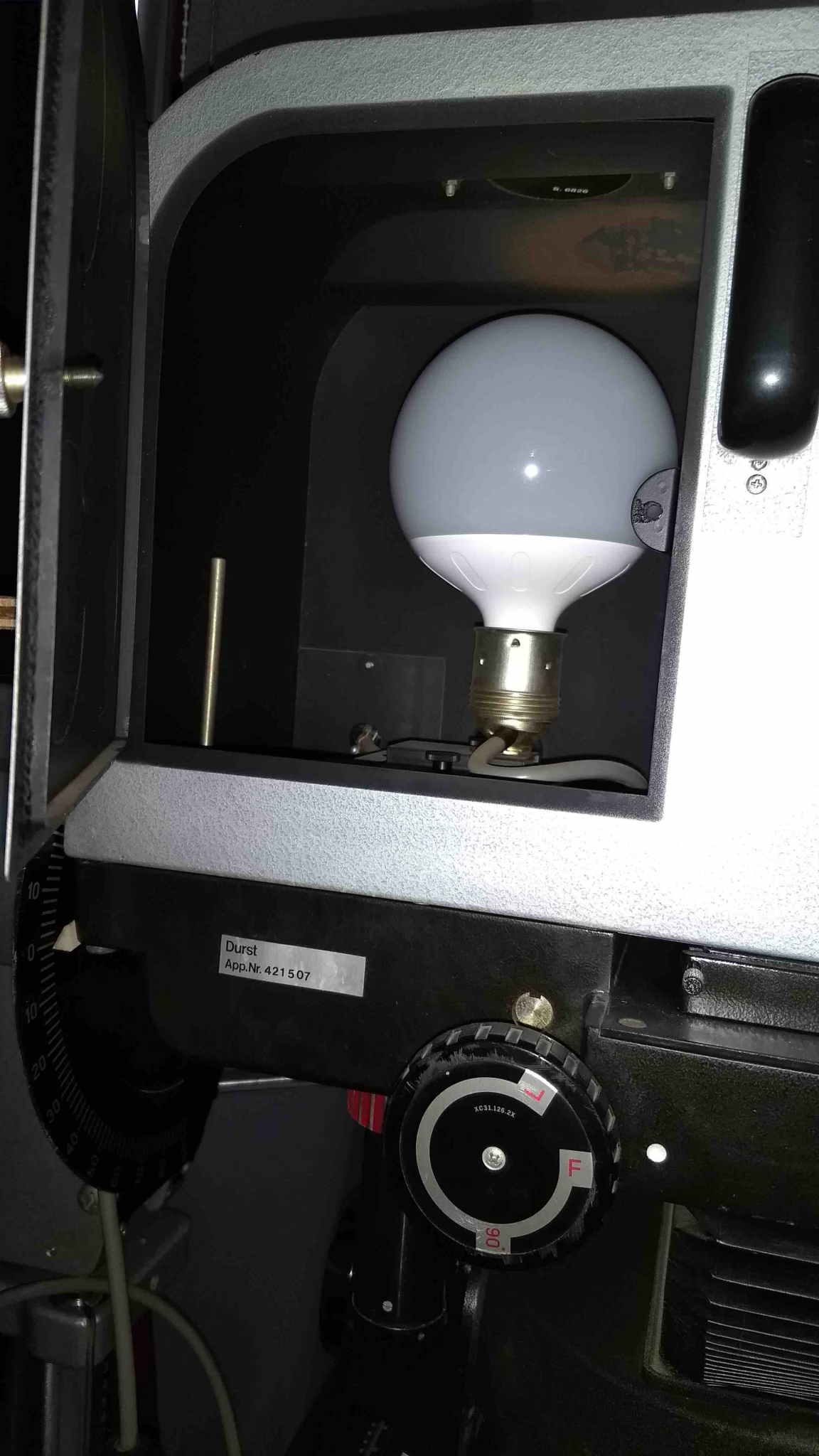

I am willing to replace a bulb in MF enlarger, which had 75W bulb, which gave long exposure times.

Hello Ron,
I would be interested in more information regarding the led bulb you mention for your 138s. Can you elaborate on the specs - wattage, approx size, etc. any chance seeing a photo of it mounted in the 138s.
Regards RD
I did some research and learned that this bulb is a:
Aigostar E27 LED Globe 20W=170W White 6400K 180° 230VAC
The diameter is 12 cm.

I really appreciate this information Ron.
I am assuming your 138s LED setup provides ample coverage for 4x5, which is the format I use this particular enlarger.
Looks like it's time for me to look at my equivalent options available to me here. Though in a 120v E26 base.
Thanks again.
Ron789
Nov 17, 2014
354
Haarlem, The
Yes, I use it for 4x5.
But frankly, you don't really need such a large bulb to get acceptable even coverage. I tested the coverage with a 150mm Rodagon lens stopped down to F/16. I used a Gossen Sixtolab to measure the brightness across the entire image, without a negative in the carrier. I double checked the Sixtolab results using a Sekonic light meter.
With a regular size bulb of 7,5 Watt the Sixtolab indicates an exposure time of 3.2 sec in the center and 4 to 4.9 sec in the corners.
With the large bulb of 20 Watt this is 7.3 sec in the center and 8.5 to 9.8 sec in the corners.
So the large 20W bulb gives a marginally better - more even - light spread but interestingly enough exposure times more than twice as long as the 7.5W regular size bulb!

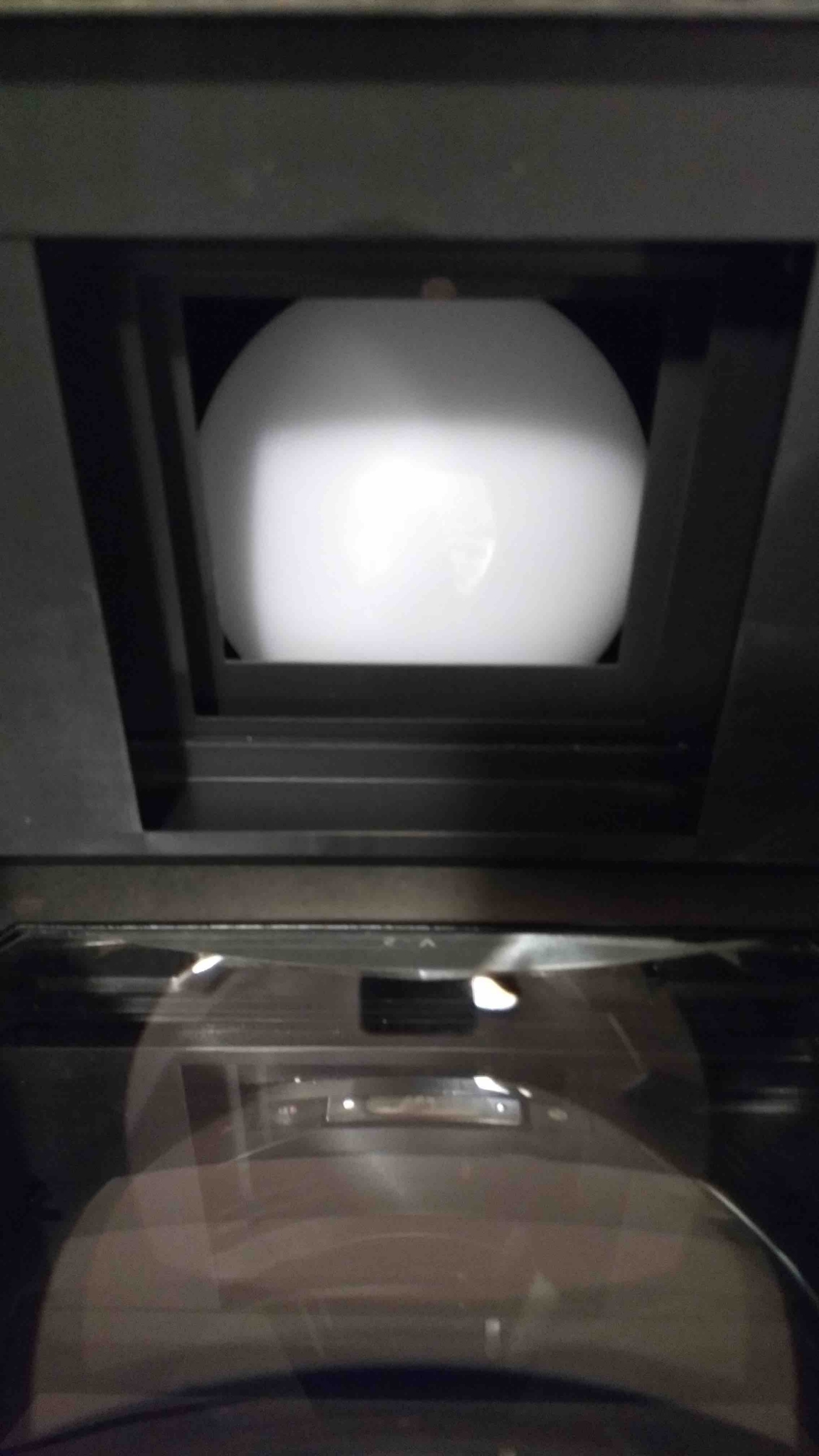

My theory to explain this: with the large bulb only a small portion of the light flows to the mirror and condensors; the filter window is smaller than the bulb. Most of the emitted light is absorbed in the lamp house.
