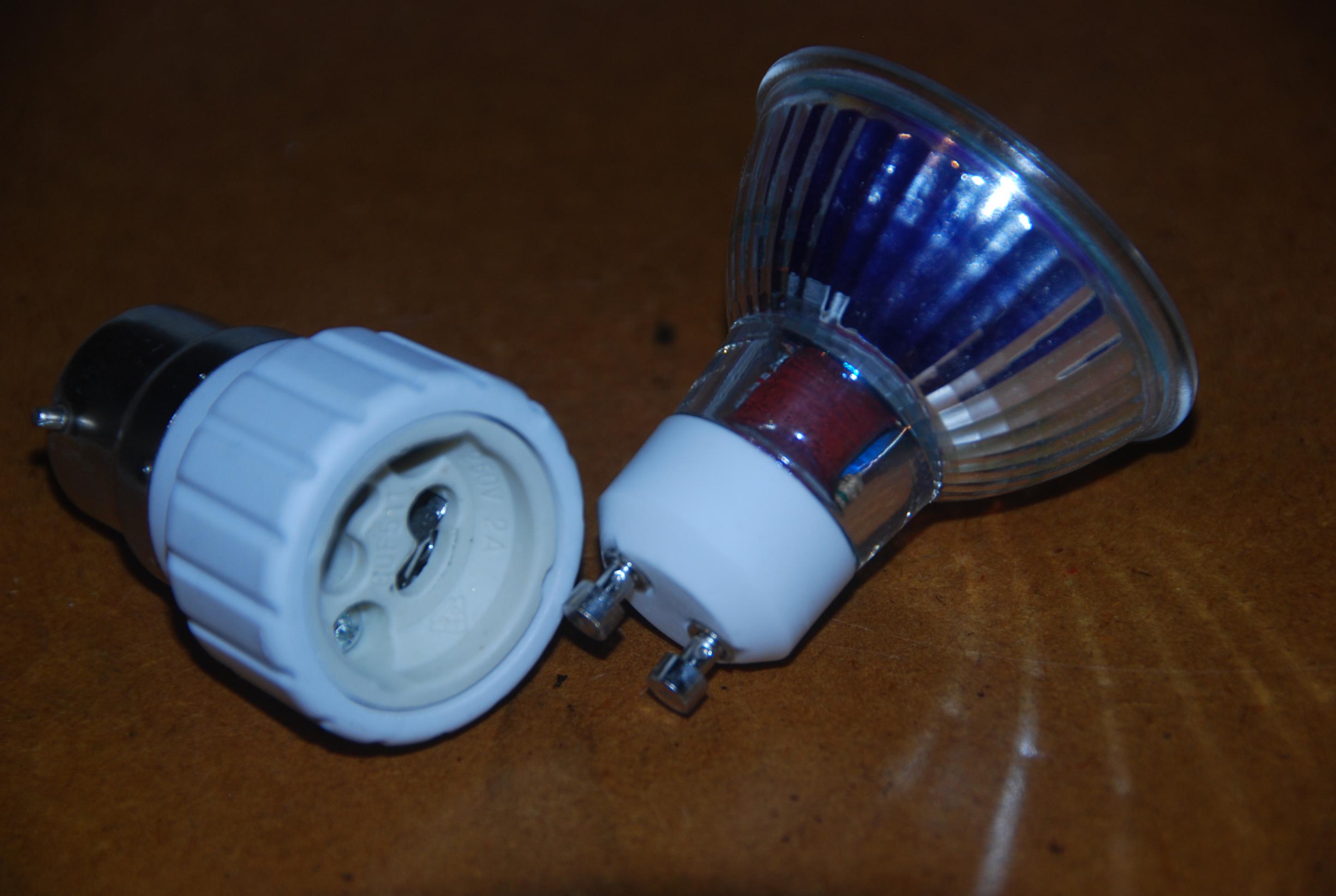

I put mains voltage LEDs , orange or yellow from Maplins (UK electronic chain) (had to get GU10 or whatever GU number the fitting is) adaptors. See picture. Put them in my Beehive safelights with OC safelights; they are a bit directional so you see the light is brighter in the centre of the safelight glass, but they work a treat, and satisfy my fogging tests.
Richard
