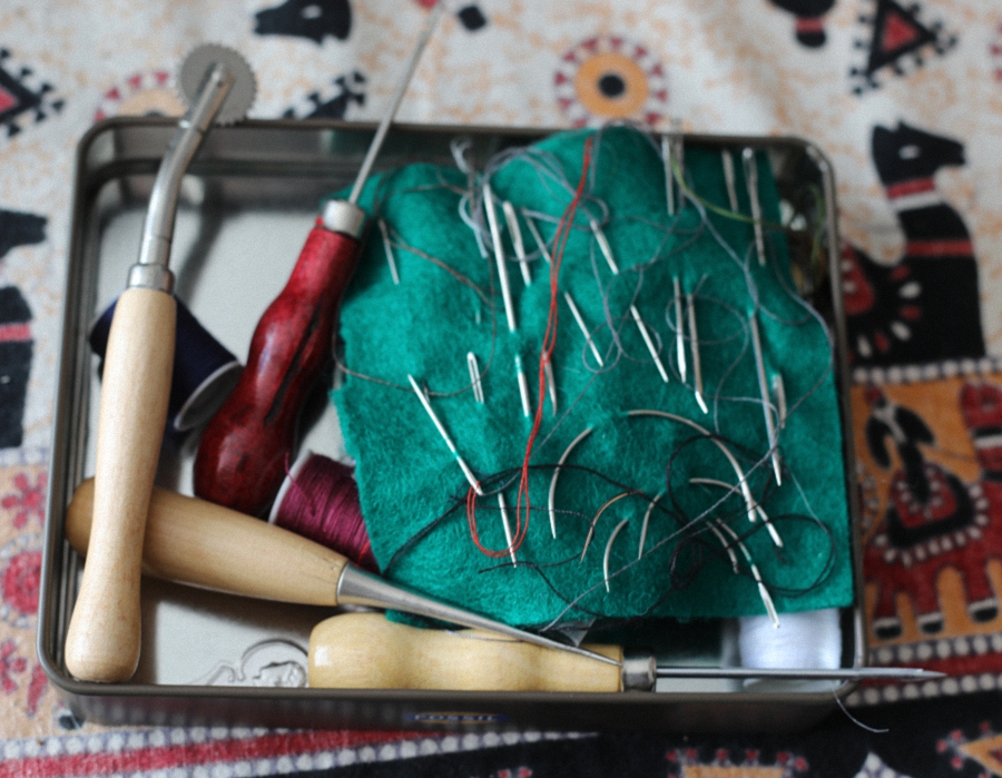

I've repaired two Yashica TLR camera cases as well as two LF camera kit cases, one for a Kodak Specialist 2. I found that I needed a mix of needles, some curved ones. The tools were from a leather repair kit, and came with the range of needles, easy to find online.

... The tools were from a leather repair kit, and came with the range of needles, easy to find online.

I tried various haberdasheries (sewing, needlework, knitting shops) even their plain needles were unsuitable, it was the same in craft centres. In the end I found a good kit in Wilko (a UK budget store loosely based on Woolworths), and a more specialist kit specifically for leather online, this had the tools needed as well as the correct threads etc.
