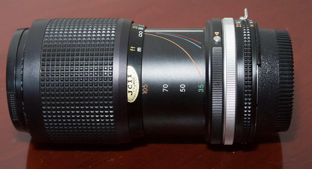

I miss the days when I used to be nostalgic. I've had mine for 39 years and counting, and for 15 years or so it put a few thousand lot of shots "in the can" for me. Now it comes out to play about once a year along with my Nikon FA.
This was Nikon's first AI-s variable aperture zoom. It was also designed for a consumer price point and it won't sharpness contests in 2023. But by today's standards, it's solidly built. Like Mr. Mann, I heard reports of sample variation and even of a "bad batch," but mine has been a solid, if unexceptional performer. My biggest gripe is the minimum focus distance of 1.4 meters unless you shift into the weird macro mode. At the short end, I frequently found myself wishing for closer focus.
If you think you'll enjoy using one, they are certainly inexpensive enough. But don't expect a life changing experience from one.

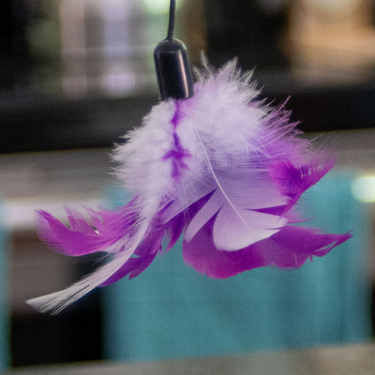

Just for fun, I broke out mine and slapped it on my newly acquired Nikon Z8. This was shot wide open at 105mm, with the focus being on the feathered cat toy. I did minimal post-processing, but you can download the OOC image at:
Sharpness is acceptable to me even with this sensor. Bokeh? I see nothing terribly strange about it. There's overcorrection of spherical aberration present in the background, but that's typical of both Nikkor zooms and primes of that era. There's also some longitudinal chromatic aberration (bokeh fringing). Given the lack of ED glass and high magnification, that's not unusual either.
