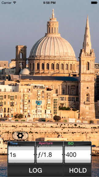

Maybe this could be a simple way to practice. Get a simple (but good) light meter app for your smart phone, like this one: https://itunes.apple.com/app/pocket-light-meter/id381698089 (for Android and iPhone).
Anywhere anytime you can, just guesstimate the exposure and check quickly with your app. I'll often do this for f /5.6 (since this is a common aperture for most lenses) and ISO 100 (for Fomapan 100 or Ilford FP4+). If I use another ISO or aperture I just calculate the difference in stops from there and adjust the exposure.
BTW: This app is very good. I've checked it with a "real" handheld meter and got the same values.
attachment.php
(screen shot from the app)
