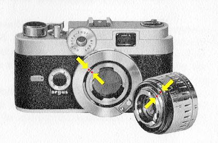

I have always thought that the Topcon Uni was an interesting concept with a leaf shutter just on the front of the body which the lenses bayonet into. No noticeable extra space required.
I don't think he designed it to be the status symbol that it became. He was being practical about cost, form, function, marketability, etc.
The Yanks made one like that also...
