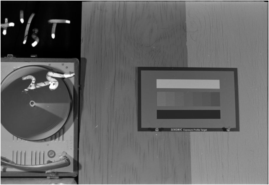

So I thought of another test. One involving actual photography with the camera...
I setup two targets. One is the exposure target from Sekonic with a set of gray patches 1/3 stop apart surrounding 18% gray. The other is an old record player running at 78 RPM, with a black sheet of construction paper with a white bar. The idea... to measure the angle of the bar recorded on film. I did a series of tests trying to get exposure as close to nominal as possible (by incident meter). I tried both Tungsten and Sunlight. It was harder to hit nominal with Tungsten because the f/3.5 lens and 100 ISO film couldn't be properly exposed with two 500 watt photofloods. So some tests are a couple stops under nominal.
I also added a sensitometric exposure to the film.
When it's dry I'll measure the sensitometric test and graph the result. Then I'll photocopy that graph and plot densities from each camera test shot on the graph. For that graphing, I only mark the density recorded where the sensitometric curve hits that density. Because the entire roll's characteristics are defined by that sensitometric test.
Then following down from the actual densities to the LogE axis... And noting the deviation in exposure from nominal... I'll be able to deduce the effective shutter speeds. There will be flare included in this but I'm measuring mid-tone densities where I expect flare is less of an influence.
The angle of the record player rotation will be used to confirm or contradict the exposure test. I expect some "greater" angles than expected due to the "bell curve" way a leaf shutter exposes, but I don't think I that my test is able to measure the bell curve because of the simplistic design.
Tests are hanging to dry next to the film from last weekend. At first glance, it seems all my real photographs are well-exposed. So that makes me think my shutter really IS a bit slow. Since I rated the film at 50, (assuming the shutter is one stop slow instead of my originally measured two stops slow at 1/250) I may actually have "exactly correctly" exposed all the photographs.
Here's the simple math I did to figure out the angle to look for:
Using 78 RPM turntable as shutter speed tester
1/100 second = x degrees of rotation:
1/100 second = 0.010 seconds of time.
78 RPM = 1.3 Revolutions per second of time.
Sanity check: Expect three tenths more than 1/100th Revolution.
0.010 S times 1.3 R/S = 0.013 R
Revolution is 360 degrees
360 D/R times 0.013 R = 4.68 D
So 1/100 should be 4.68 Degrees.
1/500 second should be 0.936 Degrees.
1/250 second should be 1.872 Degrees.
1/100 second should be 4.68 Degrees.
1/50 second = 9.36 Degrees
1/25 second = 18.72 Degrees
1/10 second = 46.8 Degrees
1/5 second = 93.6 Degrees
1/2 second = 234 Degrees

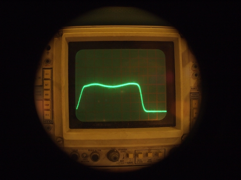

I use a photodiode press fitted in a block of acetal. A very small drilled hole forms a tube to limit the angle of view. The block is pressed against the ground glass.
The light source is a floodlamp, its 120 Hz ripple allows a handy way of double checking the scope calibration.
The light is adjusted so the photodiode stays in its linear region when it comes off dark current.
The thing is sourced with a 9V battery and a storage oscilloscope measures the bias resistor voltage.
I have tested a few old shutters and I think the tester is quite accurate, showing penumbra too.
It also works on the curtain shutter of the Speed graphic.
Curiously, although the Speed Graphic rear shutter is completely clockwork and the camera has no batteries, I have observed the rear shutter emit a solid electromagnetic pulse when it starts to move. That sometimes triggers the scope early. I have not figured out what causes that, maybe some part in the clockwork is magnetic.

I'd be interested in seeing the test shots.
I've finished crunching the numbers and have come to the conclusion that I will keep the numbers from the electronic test for the slow speeds. The turntable test was amusing but not precise. The exposure test (18% gray patch) gives me new shutter speed values for the high speeds.

taking some of the Retinas apart can be difficult...
So I had a hunch the exposure method would throw in a wrench...
1.0 LogE from metered point to speed point (0.10) is for approximately 12% but my target was 18% gray.
So I shifted my shutter speed estimates 1/2 stop towards being faster speeds.
And you thought there was no practical use for knowing the trivia about 18% gray cards...
Also I said the rotational speed was a sanity check. You can see from the photo... There's no denying... at 1/25 the rotation in degrees is extremely clear. Shutter speed is really 1/20.
I made up a new cheat sheet for the camera where I use Exposure-based high speeds, rotational-based medium speeds, and electronic-based slow speeds.
As you can see, no one method (as I've implemented) works effectively for all speeds - but the entire set work together well.
