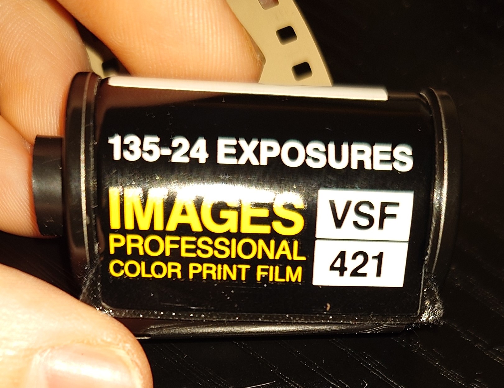

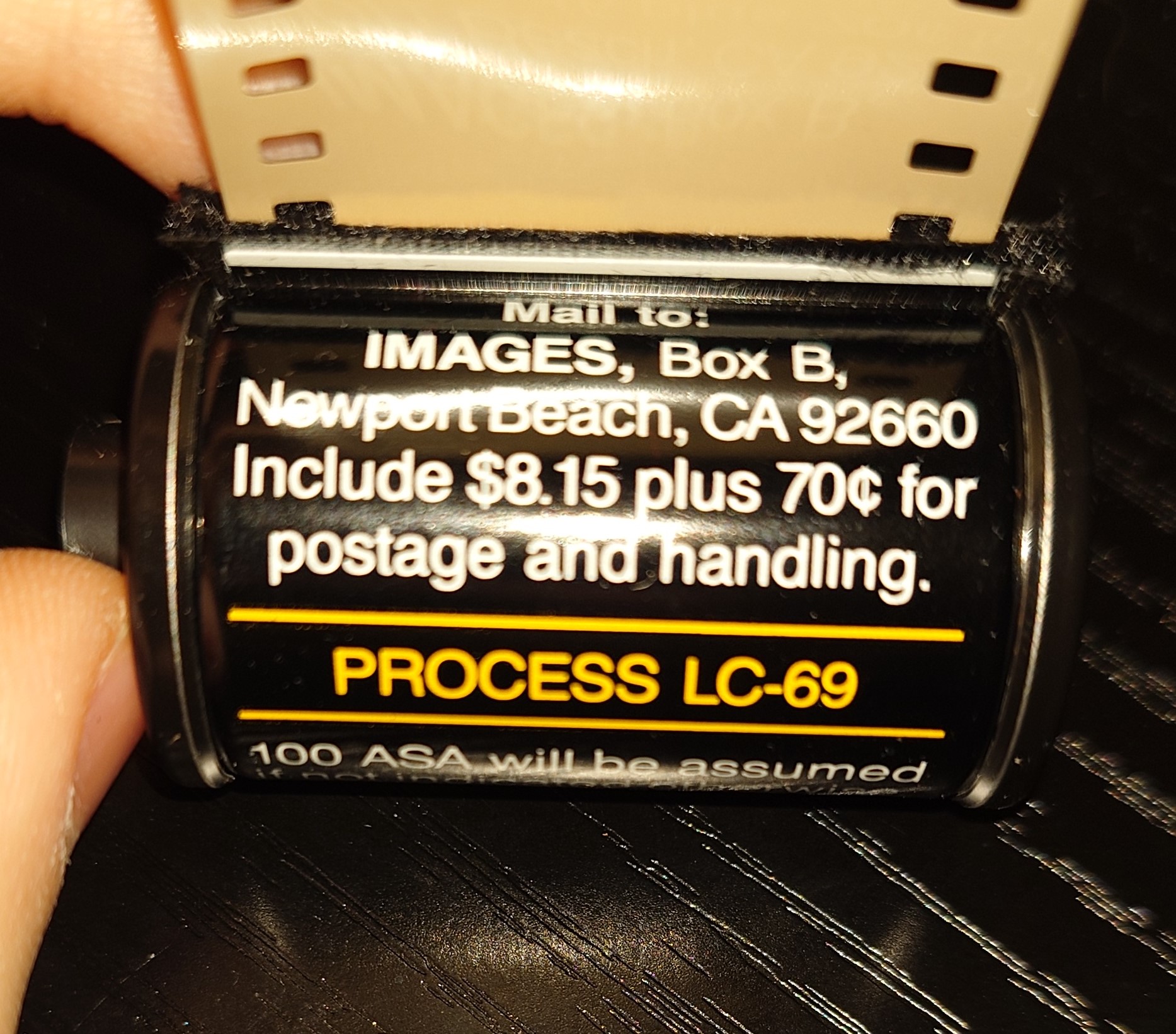

Hello all,
During a visit to a local antique store, I came across a 35mm roll marked VSF 421 and Process LC-69. I had never heard of either the film or the process before, but I have since read that LC-69 is a motion picture film process. I am looking for information on the film and process. As for shooting and/or developing this roll, I don't hold out much hope for any non-cold-stored mystery color film, but I might send it down to Film Rescue International. I question shooting it, as I am unsure if it is unused.

It seems likely to be re-spooled Eastman 5247 - similar to Seattle Film Works and a plethora of others.
Which means that it is likely to be remjet included motion picture film, and probably designed for ECN-2 processing.
I say "probably", because I'm not sure if there were earlier versions of such films, designed for earlier motion picture processes.
I suspect the cryptic description of the film and LC-69 process was an attempt to assure returning the film with $8.15 and .70 postage to Images in Newport Beach, CA. I would guess like Matt that it’s old respooled 5247 mopic film. If it has remjet on the back (distinctive black coating) it’s most likely 5247. However I think some of those respoolers switched to private label C41 in the end days of that era.

Geeting back to the original question, many of the "captive sales" film schemes - besides using Movie film used Non Kodak process films "made in Belgium" or otherwise which would of course fail miserably in c41 or even C22
Good catch! Unless it’s Soviet prior to 1989…
Soviet or other Eastern block origin came to my mind too. In this case, it would be Agfacolor II, known also as Sovcolor and Orwo color. But in the US? Not very likely. Is there any clue when this product was sold. Probably the postage of 70 cents for returning prints would be a clue.
