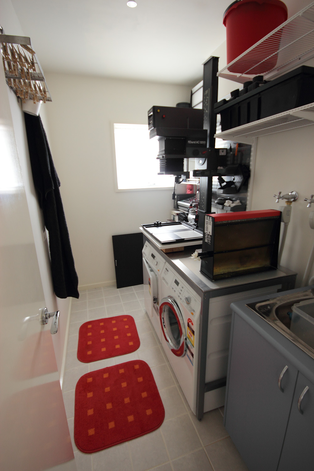

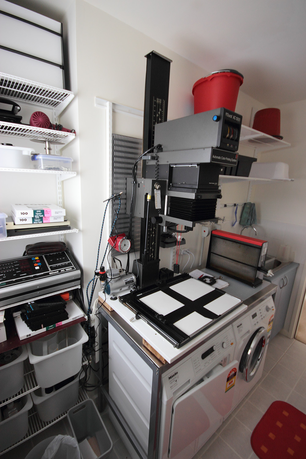

I solved my dust problem by replacing the dusty old clothes dryer with a $$$ :-( Miele one that has a condenser system. Now the only dust is regular room dust, and I have a mini compressor to blow that off negs and so on. So far, so good.

I'm glad it worked for you. But the mere in and out of fluffy clothes creates enough dust to make me uncomfortable. But I already have a great darkroom so I'm being picky here.

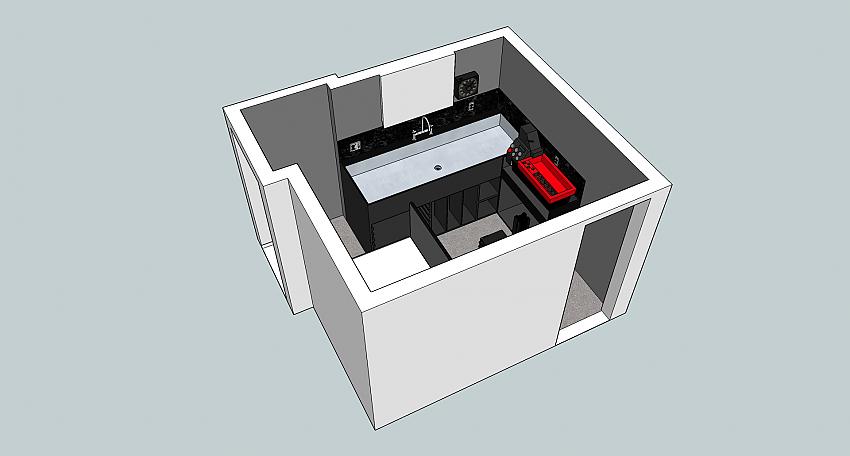

Well, I've developed film and printed in far worse situations than this.... LOL

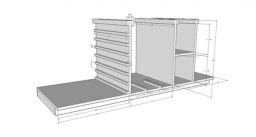

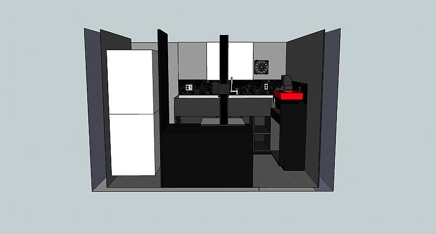

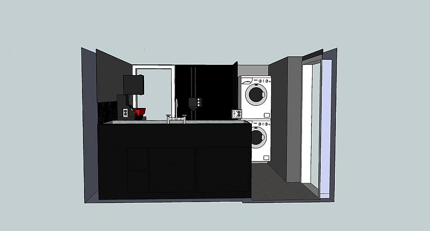

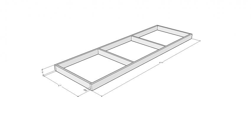

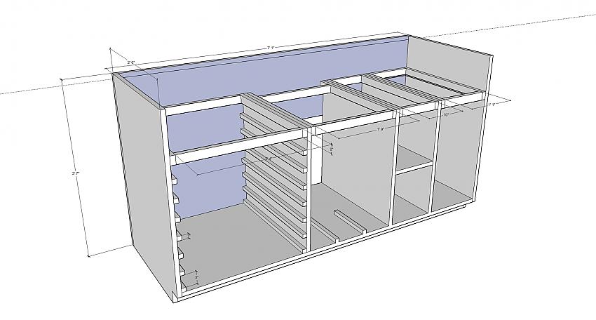

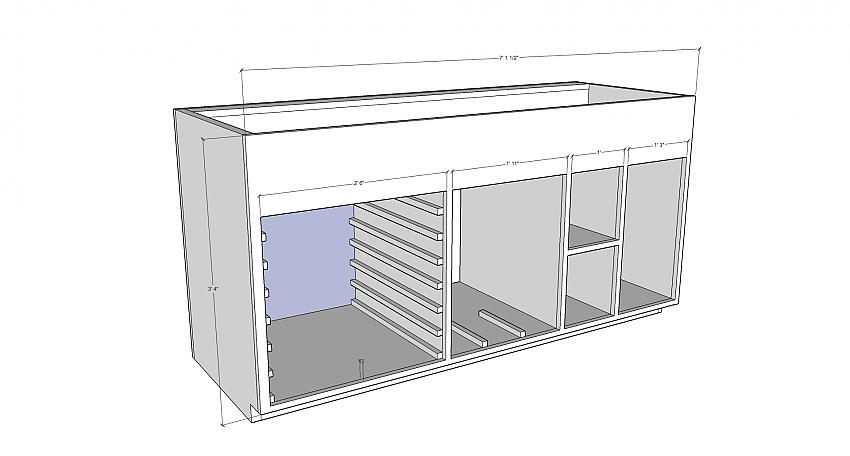

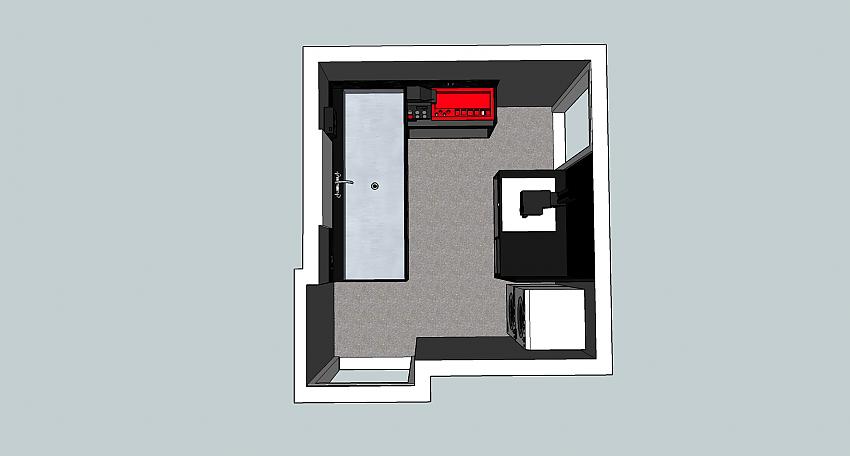

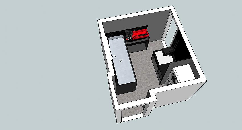

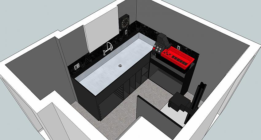

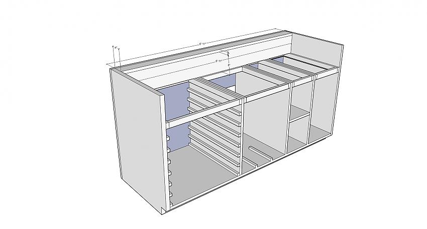

I finished the design and have completed the demolition work. Will have the drywall work finished tomorrow and Wed. I can start painting.

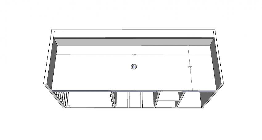

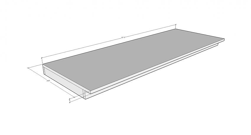

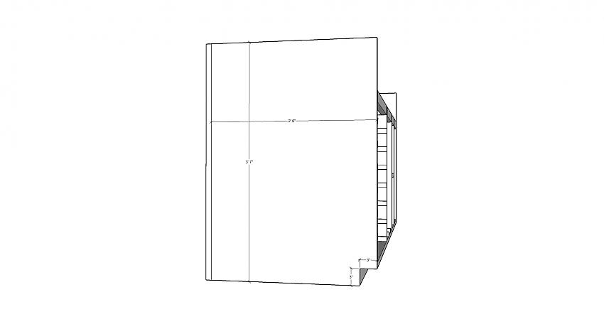

Here's the design:

Michael, I'm still deciding on which side I want it to drain to, which is why it's centered now, although the more I think about it, the more I may actually leave it flat. But, if not it will slope down to the left and the drain will move. I'm also changing the back piece just a tad.

Regarding the sink, I've used small ones and really, really big ones. On small sinks the slope always bugged me (maybe because there was too much of one). So I've been considering leaving it flat and just using a squeegee to get the last of the water down. But I may rethink that.

Dust would be my primary concern in a laundry room (from the dryer), but that can be mitigated by an air cleaner running and not cleaning the dryer lint trap the day of darkroom use.

Matthew, I love the JOBO and the Gralab timer in 3D. Are these Sketchup drawings?
I've been noodling around with Sketchup designing my new darkrooom sink, and darkroom once I get more organized with my thoughts.

Thanks, yes I did use sketch up. I found the graylab in the 3D Warehouse, but I'm building all custom cabinets, so I did a quick scale mockup of the jobo (not very detailed if you get close, but it is to scale) and my Saunders/LPL enlarger.
It took me about two hours to get up to speed with sketchup but I'm loving it.
