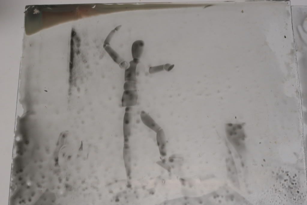

Well, I used up the last bit in the jar I kept in the fridge for 2 weeks to shoot some test shots lit with Grandpa's old GE Super 8 movie light.
http://i266.photobucket.com/albums/ii261/mrexplodo/IMG_0080.jpg
F7.7 @ 1.5S SLR metered 1/30 at f16 ISO 100
The density is low; but this batch of plates seemsto be a little more fine grained- I think it's due to the developer haveing been mixed and aged a bit more - the first few frames were developed immediately after I mixed the D-76 up. Also maybe due to a thinner coat of emulsion.
http://i266.photobucket.com/albums/ii261/mrexplodo/IMG_0079.jpg
F16@ 2 secs. I think I was being over-optimistic on my previous ISO 4 estimate - probably more like ISO 1 or 2
http://i266.photobucket.com/albums/ii261/mrexplodo/IMG_0078.jpg
F32@12 seconds - There's a pumpkin and some red and orange blocks in this one that the film couln't see, and has nearly the same density as the black leather background.
http://i266.photobucket.com/albums/ii261/mrexplodo/IMG_0077.jpg
THis is the "wasabi" slide -
After the mercury developer forum that somehow got into possible sushi addenda, I thought, what the hey, and mixed in a bit of Wasabi to the last plate. I learned the following:
Warm wasabi emulsion in a small darkroom makes said darkroom nearly uninhabitable. I thought I was going to choke on the fumes several times.
It gave no apparent increase in speed whatsoever. (or fog)
Wasabi is not nearly finely ground enough for emulsion making, as it left spots everywhere
Oddly enough, the blacks are a much darker tone, and it looks like the contrast is a little higher. The Wasabi frame was also shot at F32 , 12 seconds, and like the frame before it, developed 20 minutes in full strength (but I think nearly exhausted) D-76.
