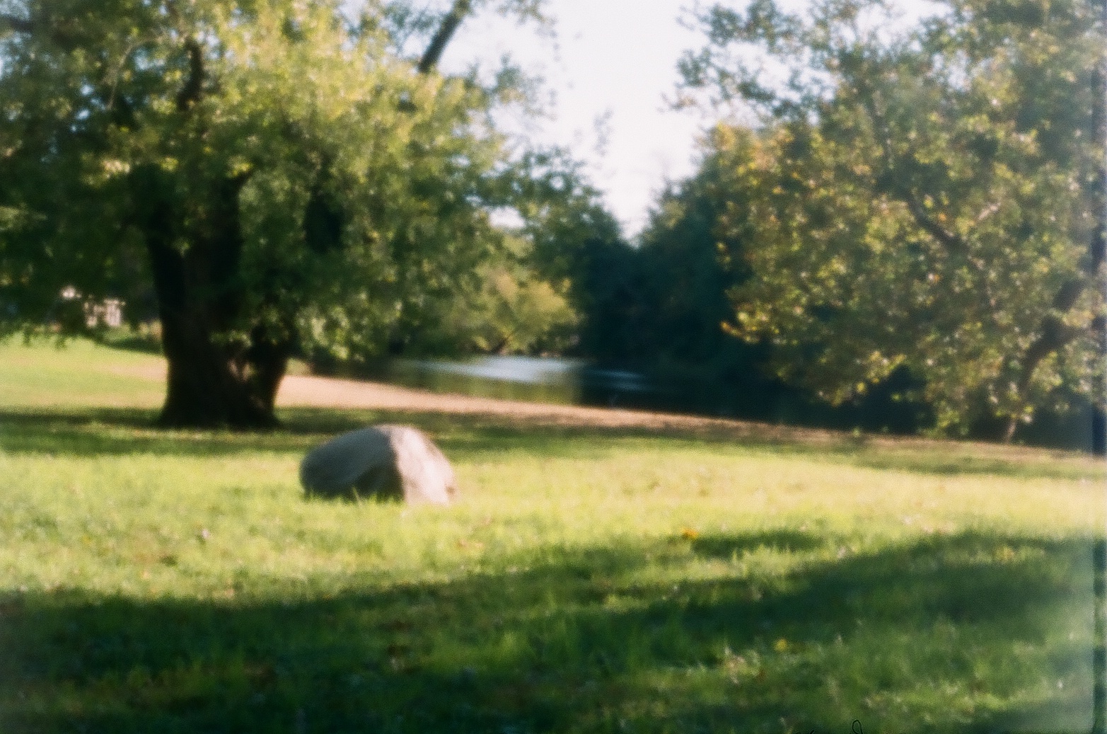

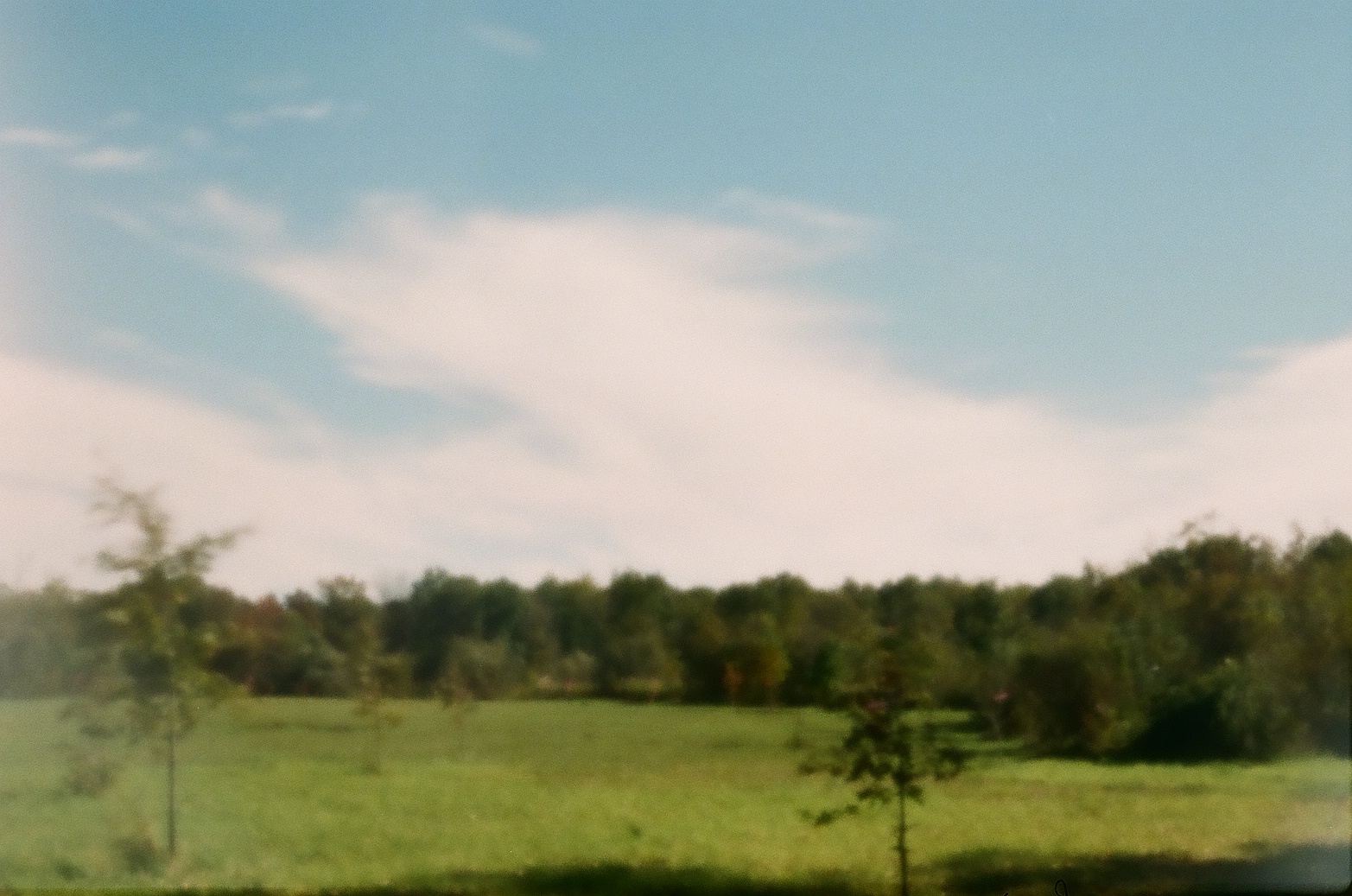

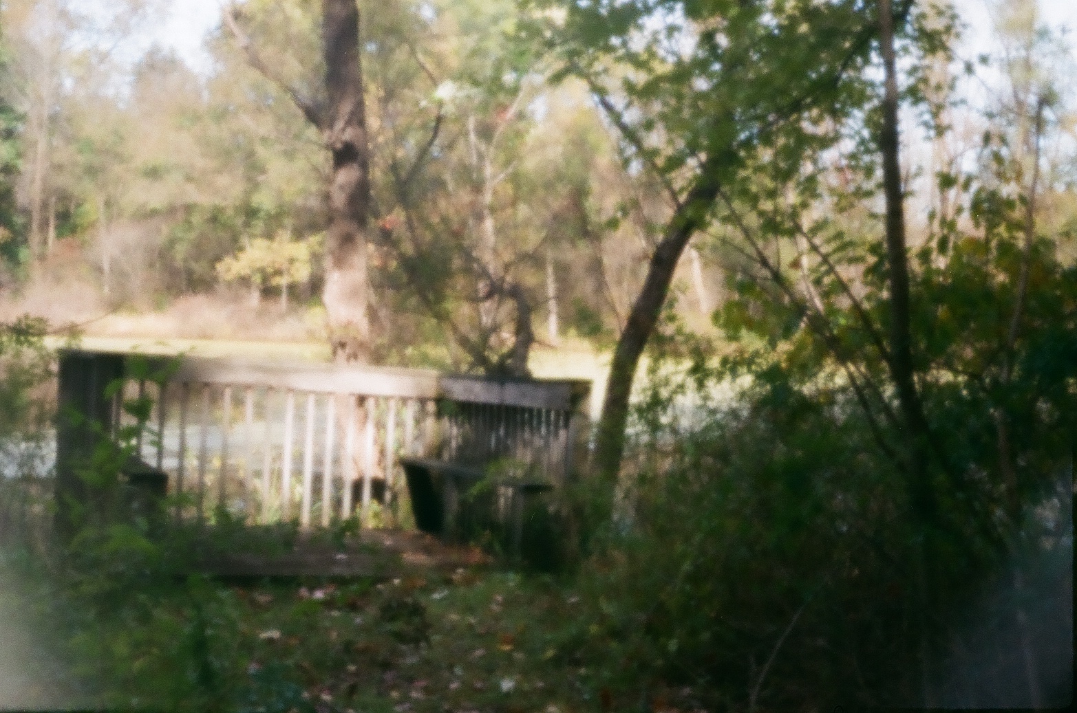

Here are three of my latest pinhole camera shots. They are taken with an .014" pinhole for an f 155 aperture.
They are as shot with no enhancements. My objective is to get as good a picture as possible with the pinhole, not the computer processing.
I believe this is as good a resolution as I can get with the 35 mm format, as the image is enlarged many times for viewing.
My next attempt will be with a 4x5 view cameras which will allow a large format and a smaller aperture with the pinholes I can make. But first I have to restore the camera.
The three photos are; the field next door, a bend in the Tippecanoe River and an old pond viewing deck.

The camera is and old Praktica SLR. with the lens removed the shortest cover plate I could fabricate was 55 mm from the film plane. With a .356 mm pine hole (.014") the f value is 155.
To answer your question , The film was Fuji color 200 ASA. The difference between the light meter reading at f 22 and f 155 is a time multiplier of approximately 60. Plus reciprocity.
  • The field shot was 3 seconds. Bright grass and sky dark trees. The light meter said 1/25 sec. at f 22 so I rounded to it to an even 3 seconds
  • The river bend was 12 seconds. Bright grass and sky but mostly shaded river. The light meter said 1/15 sec. at f 22 but I wanted a bit more shade detail so I increase the exposure to 12 seconds.
  • The pier was shaded with a sunny highlight and bright back ground. The light meter was 1/25 at f 22 so again I rounded up to 3 seconds.
I was surprised that in many cases doubling or tripling the exposer time did not make as great an impact on the negative as one might expect. I attribute this to the greater latitude of modern film and to the non-linier properties of reciprocity.
My best results with this film have been between 3 and 6 seconds in normal sunshine. I hope this helps.
