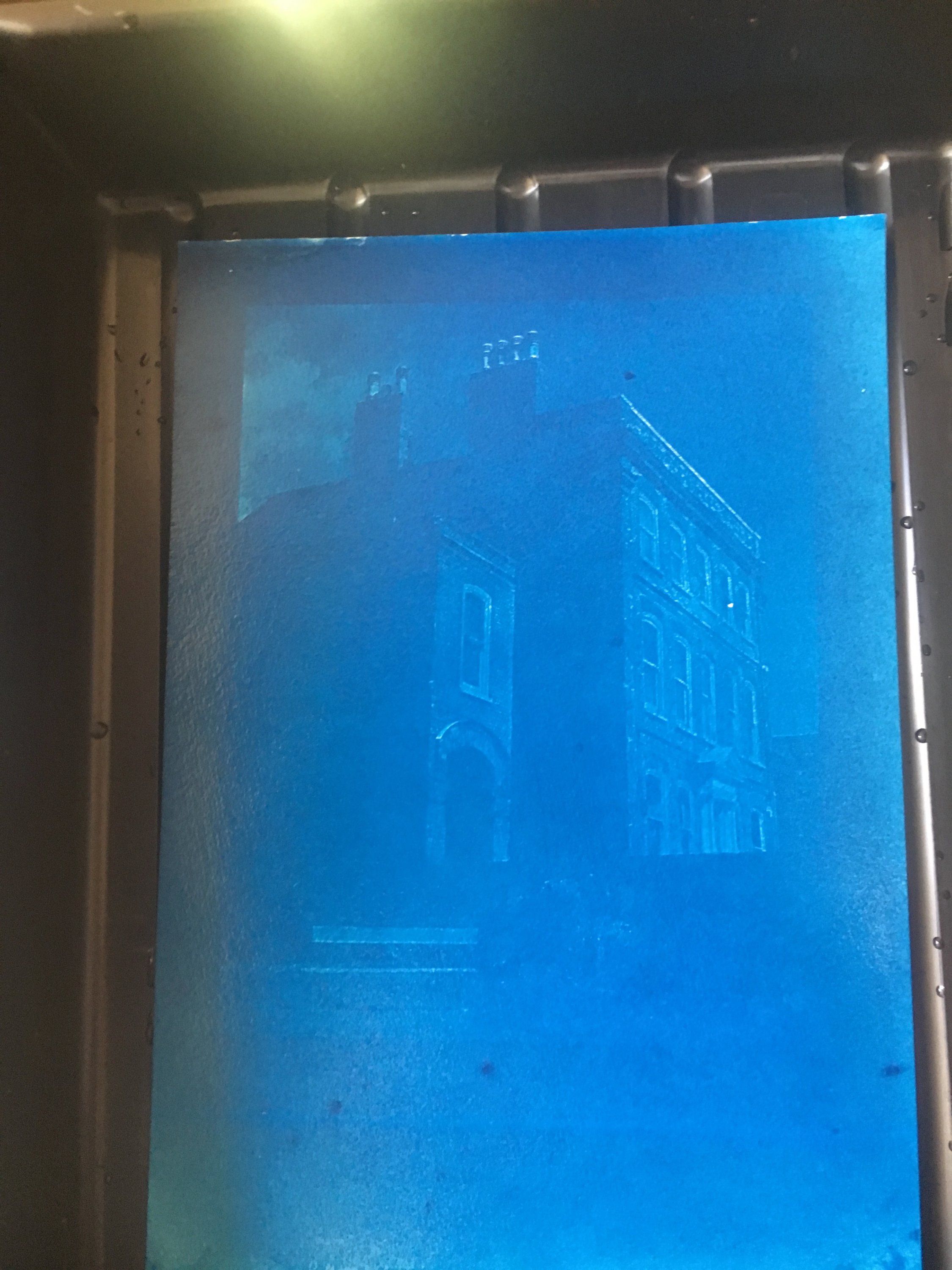

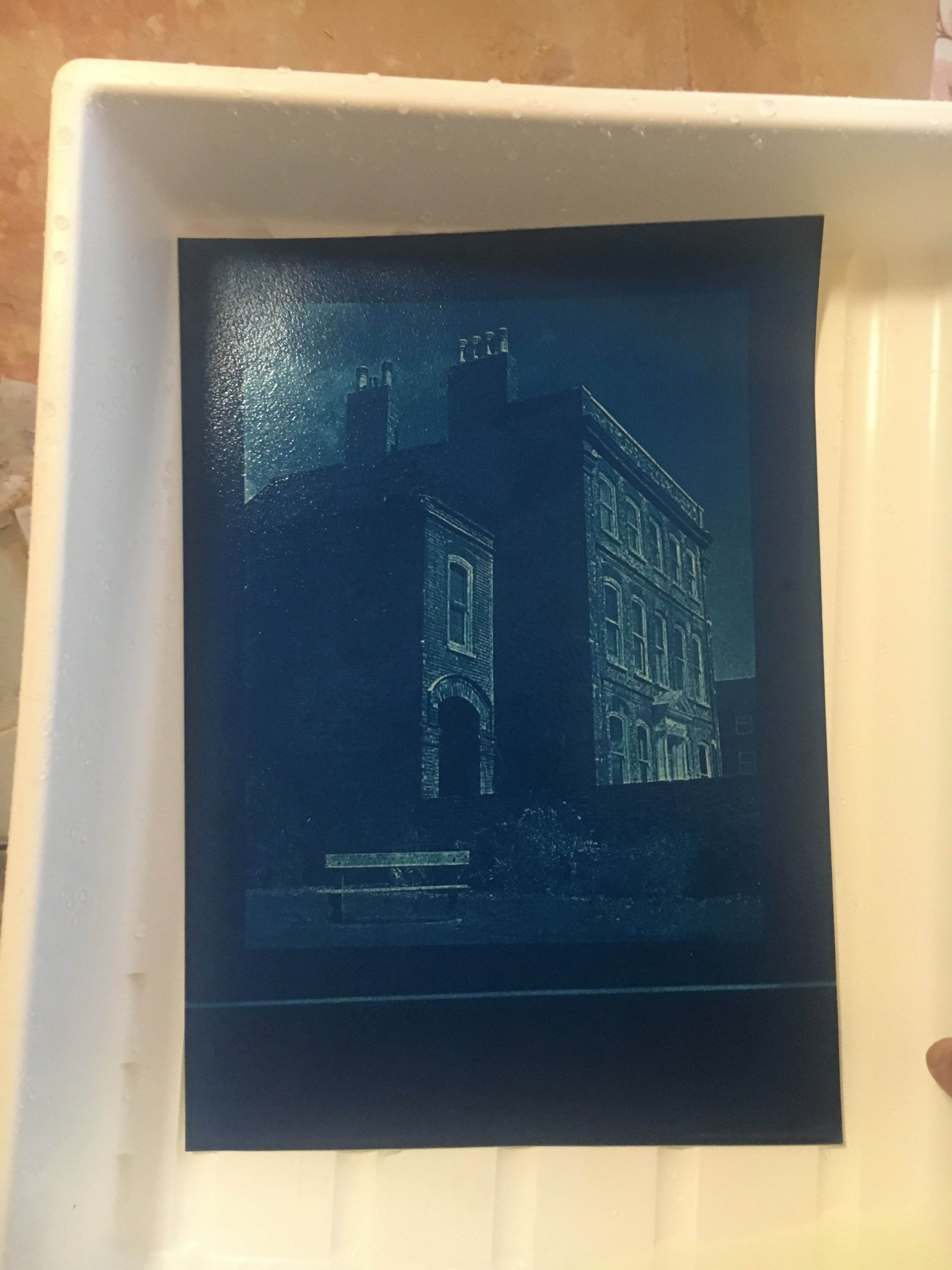

Thank you for your help with this. It encouraged me to make my first 2 cyanotypes ever. The first I overexposed. I really didn't have much of a clue how much exposure was required in the sun. The second has turned out OK (still a bit overexposed but I can work on this)! I used a different negative in the end but printed with a laser on OHP transparency.
What a wonderful process! Best Wishes, Stephen
Both still wet.
It is a wonderful process. You can also put objects instead of a negative and make photograms. The older process that uses Potassium ferricyanide and ferric citrate is not very toxic so it's fun for kids. After developing in water, I put the print in a dilute solution of hydrogen peroxide. Just a splash in a tray of water. Have fun!
