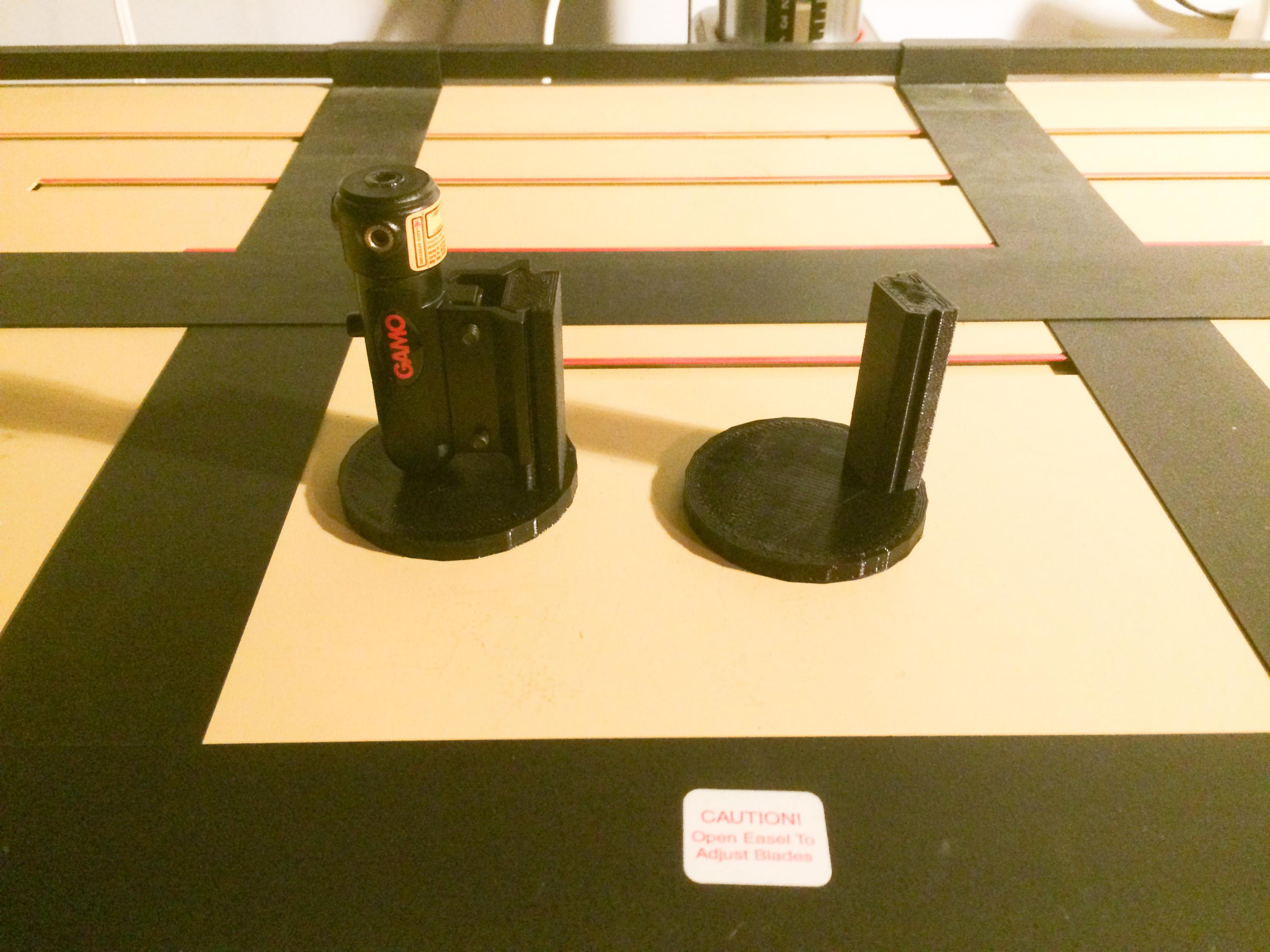

Years ago I found a laser air pistol site that had a nice flat base. I’ve been using this to align my enlarger ever since, and it works very well. But, I haven’t seen that model in years. Since I have frequently recommended building your own laser alignment tool I thought I would build a 3D printed stand to use the commonly available laser sites for pistols.
I have now released a 3D printed stand so you can build your own laser alignment tool. The STL file is at thingiverse.com. The site pictured was $17 at Walmart.

How flat does the base get once it's printed? I notice that the top of the base looks a little rough.
That will depend on your printer. I printed it on glass so the base is very flat and smooth. The rest of the print has a slightly rough texture since it is built up layer by layer, but that is not important in this design.
