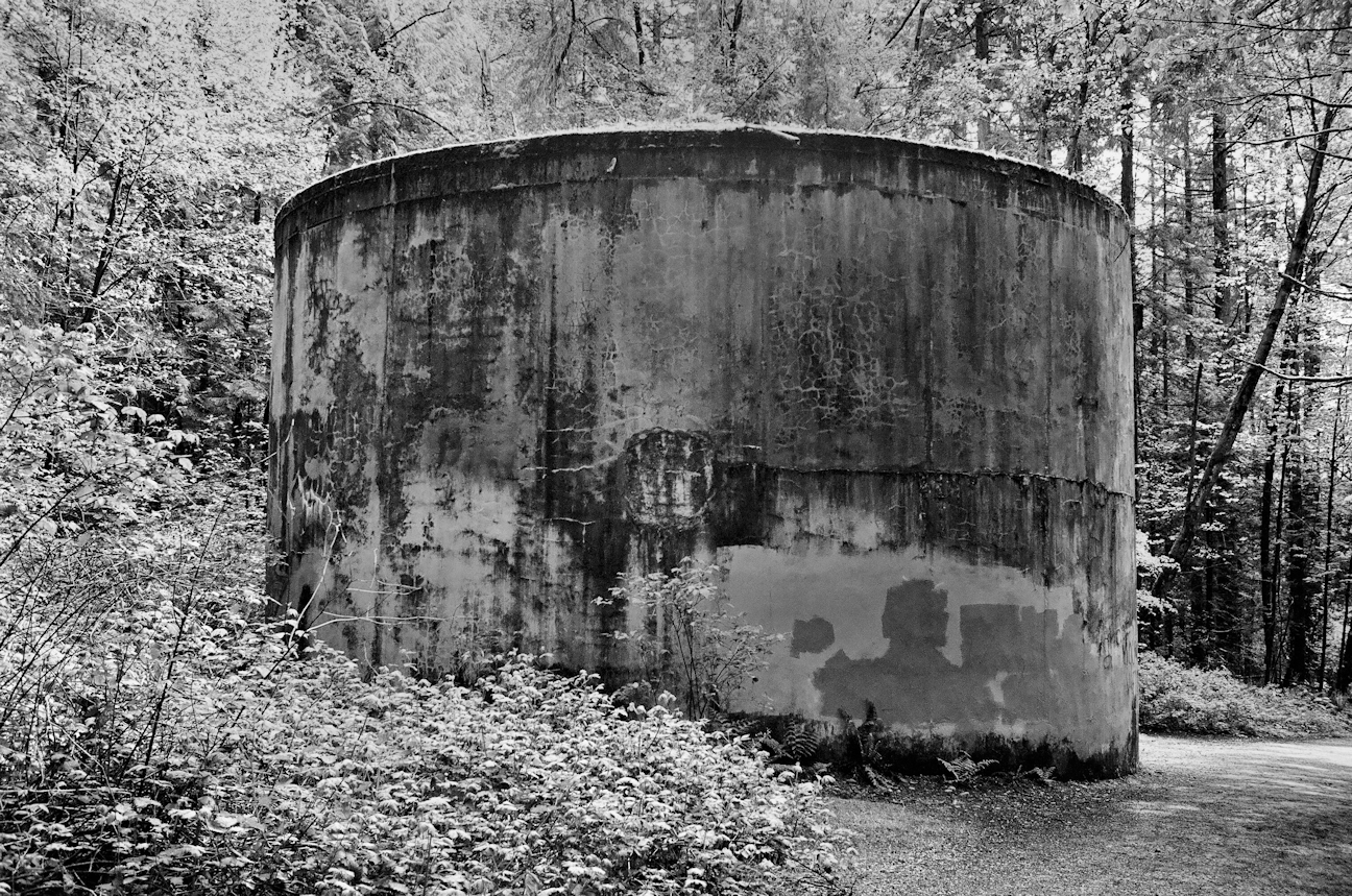

This 35mm negative prints quite nicely to 11x14:

I like it. What film if you don't mind my asking?
Thanks Martin - it is Ilford XP2 Super in 35mm.
FWIW, shot in an Olympus OM body using a 35mm f/2.0 Zuiko lens.
