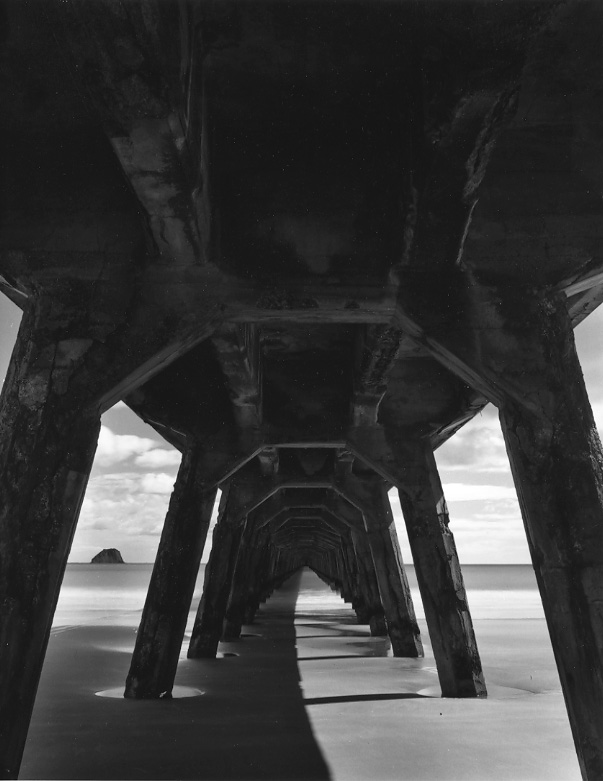

I spent about 6 months in NZ on a bicycle, along with a 4x5, one lens, 5 holders, and a changing bag. I exposed about 75 sheets of film on that trip. Should of had ten holders!

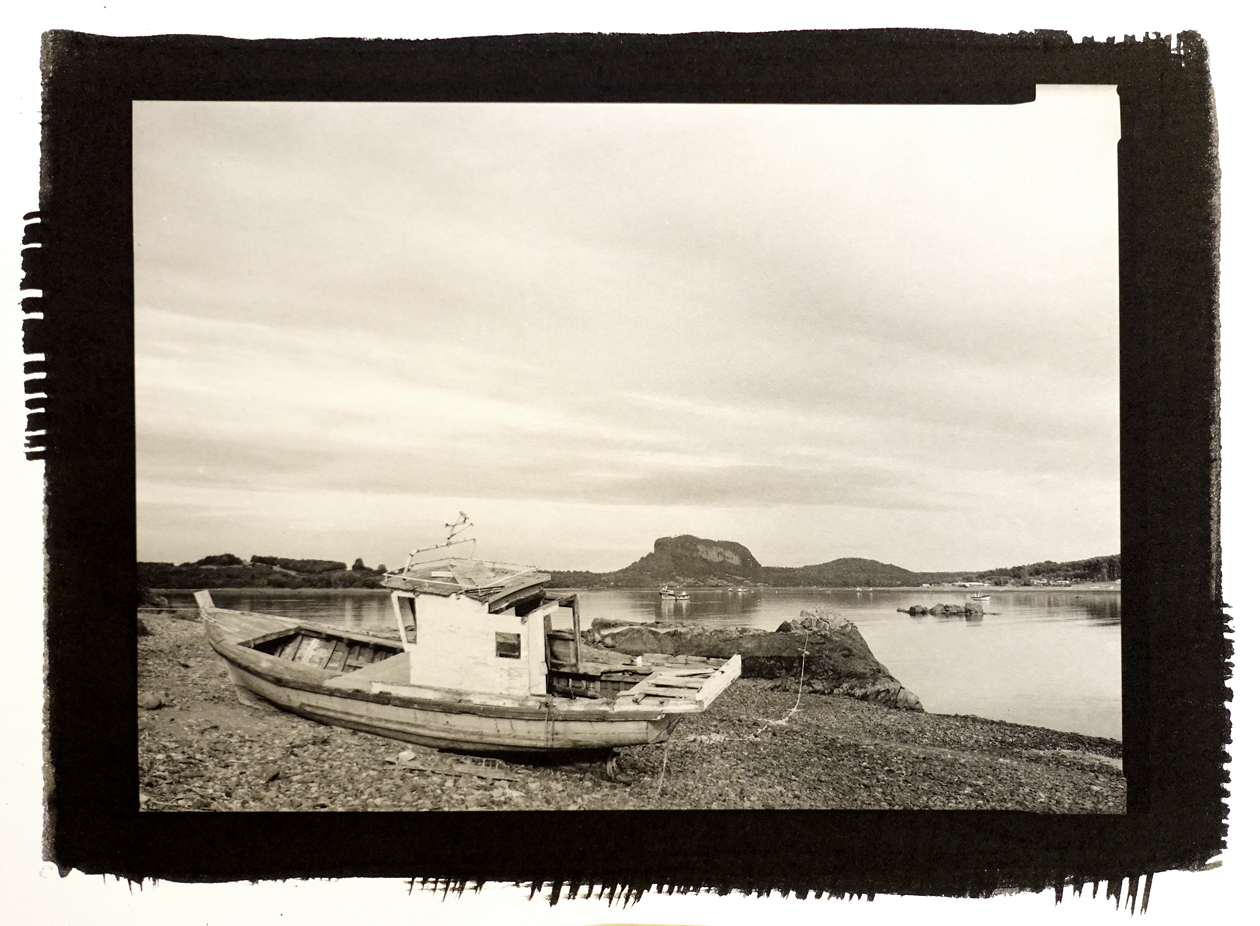

A more recent trip in Chile (car-camping w/ my boys) for a month with the 5x7, I took 6 holders and a Calumet changing tent. I exposed 30 negatives. I would have liked to have made more images, but I was having a lot of fun exploring with my boys (and had some interesting weather). Beached Boat, Southern Chile, 5x7 platinum print.

For the NZ trip, I put the exposed sheets of film into the box and kept track of the order in which they were put into the box. Sort of worked! Now I prefer not to reload (thus the large number of holders!)
