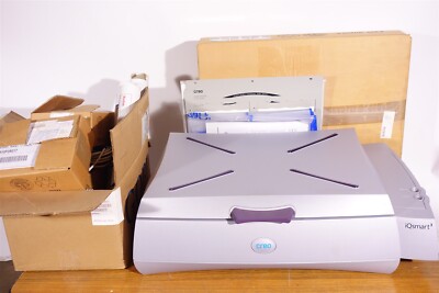

In the used dept. this bad boy isn't cheap, but it is probably *the* best high end scanner you could lay cash down on:
The only issue if you decided to go this route, would be the software - Oxygen. Kodak owned, it might be difficult to come by and I'm not sure you'd get the best out of the Creo, if you used 3rd party. This unit includes the software, another listed does not; that slight $$ saving between the two would be the difference between a brick and a Ferrari. :wink:
Additionally, the Creo no longer has service assistance, so you'd need to be stocked up with parts and ready to fix yourself - if that is daunting, probably best to go with one of the new ones currently available.
We use four of these and four Epson 12000XL at work. The Creo is amazing - dial in the dpi to what you want and away you go.
You can get Creo scanners from Scan Solutions, they are very well supported by Micheal Streeter. You typically get the scanner with a Mac mini loaded up with oXYgen software.
They are very good, but I'm not sure the OP needs that level of quality for producing web reproductions of his prints. Personally I'd figure out a way to camera-copy the prints, but short of that an XL Epson would be the way to go. These scanners are HUGE however and so may present size issues just as a copy rig would.

Yeah 800dpi is not going to stress anything available today. Personally I'd choose one of the Epson XL scanners, or do copy work. The Creos are great but more for scanning film than prints necessarily. I run an Eversmart Supreme II.
