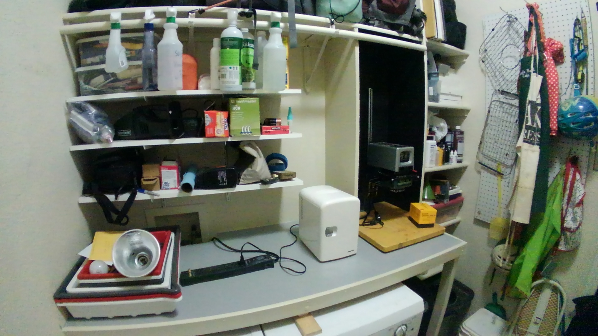

*Update* workspace mostly complete with an available weekend. Plywood table covered with Rust-Oleum countertop paint, leftover chalkboard paint around the enlarger. Counter fits three Paterson 11x14 tubs perfectly. In retrospect the left side partition around the enlarger might be a bad idea, and the durst appears to have zero light leaks anyway. That board is easily removable with a few screws. only thing left is light curtain leading into the kitchen and to test for light leaks. Oh and hang the Kodak brownie oc light.

Beautiful work. But in a previous comment, you mentioned a shed? My first darkroom was in a shed. Wasn't perfect. I shared it with the well pump, junk, and the random critter, but it worked. I was a kid at the time, so my tolerance was as high as my determination.
If the wife kicks you out of the laundry room, maybe the shed is an option?

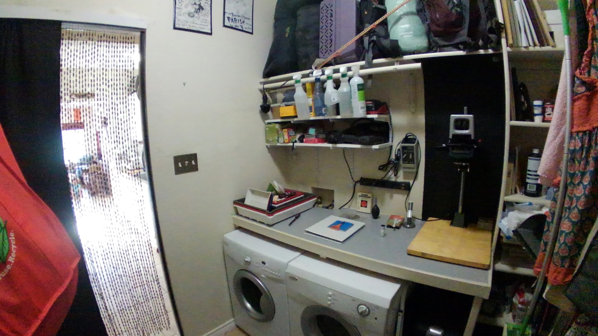

Very nice. Which way did you go with the open door? Curtain? How did it work out. I personally rather like the idea of having a curtain to enter the darkroom.... somehow reminiscent of mid century french movies :wink:
Another idea would be to attach two U-shaped aluminum profiles left and right on the inside of the open door to act as guide rails and light-traps for a roller blind.

I'm going with a sort of semi-light trap with blackout curtain across inside of open doorway. I think it will work well enough. Just waiting on the material to arrive in the mail at this point.

So the darkroom nook is 100% finished. Chemicals and paper to the right on the shelf and you can see the partially closed blackout curtain to the left. It has drapery weights in the bottom hem to keep it straight and I can even print during the day if I gaffer tape the edges to the wall. At night with the kitchen light off it is not even needed.
